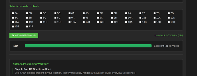

  • :white_check_mark: DAB Validation: “Excellent (31 services)” - all services decoded perfectly
  • :white_check_mark: Hardware: RTL-SDR V3 successfully validates and decodes channel 11D
  • :white_check_mark: Initial decode: Decoder starts and locks onto signal every time without issue

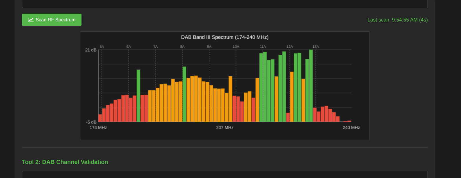

RF Spectrum Scan (9:44:32 AM):
  • Result: Channel 11D shows 18-20 dB signal strength (excellent)
  • Status: One of the strongest signals in entire DAB Band III
  • Duration: 2 seconds (quick overview)
DAB Channel Validation (9:53:48 AM):
  • Channel tested: 11D (D1 National - where LBC broadcasts)
  • Result: “Excellent (31 services)”
  • Duration: 13 seconds
  • Services decoded: All 31 services on multiplex successfully decoded
  • Decode quality: Perfect - no errors or warnings

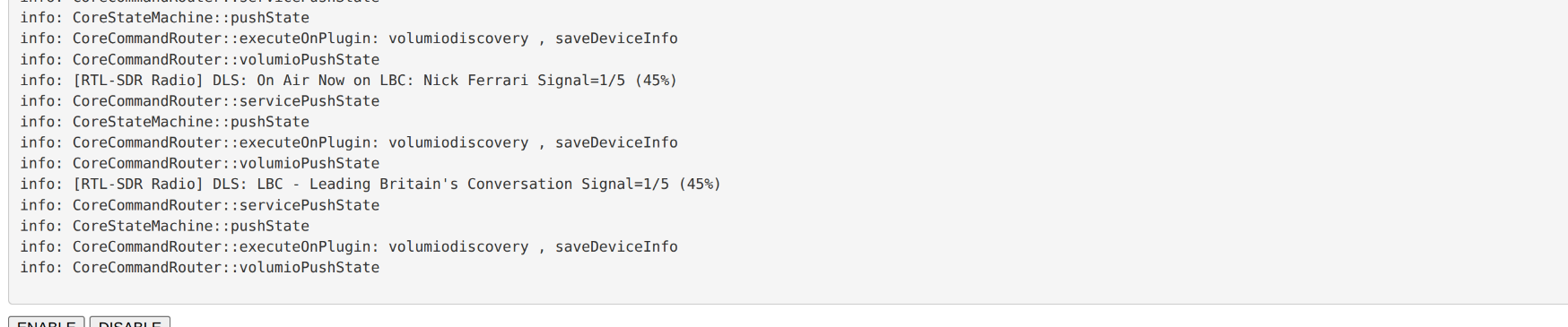

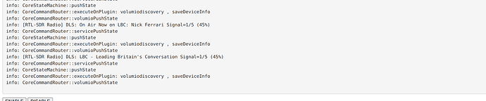

Dec 03 06:59:00 bedroom volumio[1783]: info: [RTL-SDR Radio] Starting DAB decoder: dab-rtlsdr-3 -C 11D -P "LBC             " -G 80 -D 30
Dec 03 07:28:07 bedroom volumio[1783]: error: [RTL-SDR Radio] DAB decoder exited with code: 134
Dec 03 09:19:30 bedroom volumio[1783]: info: [RTL-SDR Radio] Starting DAB decoder: dab-rtlsdr-3 -C 11D -P "LBC             " -G 80 -D 30
Dec 03 09:39:15 bedroom volumio[1783]: error: [RTL-SDR Radio] DAB decoder exited with code: 134

RF Spectrum Scan Results
Comprehensive RF spectrum scan of DAB Band III (174-240 MHz) completed at 9:44:32 AM showing:
Excellent Signal Strength (Green, 15-21 dB):
  • 11D (D1 National - LBC) - 18-20 dB signal strength :white_check_mark:
  • 11A (SDL National) - Strong
  • 11B (Bradford & Huddersfield) - Strong
  • 11C (Sheffield) - Strong
  • 12A - Strong
  • 12B (BBC National DAB) - Strong
  • 12C - Strong
  • 12D (Leeds) - Strong
Visual confirmation: Channel 11D shows as one of the strongest green peaks in the spectrum display.
DAB Channel Validation Results - CRITICAL EVIDENCE
Channel 11D Validation completed at 9:53:48 AM (13 seconds):
11D: Excellent (31 services)
This proves:
  • :white_check_mark: Signal is not just strong RF power, but fully decodable DAB
  • :white_check_mark: All 31 services on multiplex successfully decoded
  • :white_check_mark: Decoder CAN initialize and decode the channel correctly
  • :white_check_mark: Hardware (RTL-SDR V3) works perfectly
  • :white_check_mark: Antenna positioning is optimal
  • :white_check_mark: Crashes are 100% a software bug, NOT signal-related
