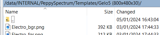

I have added the spectrum templates folder but in the plugin this does not show, I have rebooted volumio .
Hi again ,
Do you unzip a file from Gelos?
It requires to have a spectrum.txt file in the folder.
yes , it is there
So just refresh the page. You should see the folder in the plugin.
I see only the defaults ones ā¦
