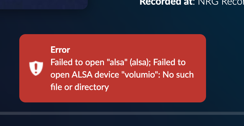

On your picture, we can see MPd oled. It may be the cause of a non working spectrum.
Only last version of peppyspectrum allows different number of bars and different resolution.
Install from cli brings nothing.
I had same thought on md_oled , so I reinstalled md_oled you see in pic after attempting other clean installs with no other plugins but touch display, now playing , peppyspectrum then adding peppymeter before peppyspectrum , then had v.01 working I read added md_oled as you see. Think I’ve tried most every possible option, I even got prompted to upgrade the plugin in the gUI, from working v.01 to v.13 and after upgrade it was again getting asla error device not found if peppyspectrum was on and all setting as mentioned and other plugins off as mentioned. So I just disabled it for now. I will try the cli install over the store install just to test. But it’s just not working for my rig it seems. As stated it is still beta.

It works, it works - but there is some incompatibility
(all causes need to be ruled out so that @balbuze will have a spoiled Christmas and have something to do) ![]()
uninstalled current PeppySpectrum and installed from CLI the ZIP for .013 and it installed successfully unlike v .08 zip. it displays a random Template, but it starts making the songs auto skip to the next one every 4-5 secs. tweaked a bit more and now get this error again. I uninstalled MD_OLED as well just to be sure. My Display is the Raspberry PI 7" at 800X480… I can try and HDMI later. But wanted to share this update… I would like to give @balbuze a spoiled Christmas too, willing to try whatever would help… If I turn off the peppySpecturm plugin it plays fine
Yes muilt room is off and tried mixer at hardware and none, and all other play options set to recommend above… I tried turning off the DAC in setting to headphones, then back and rebooted, no change same error. Yes PeppyMeter is installed but disabled

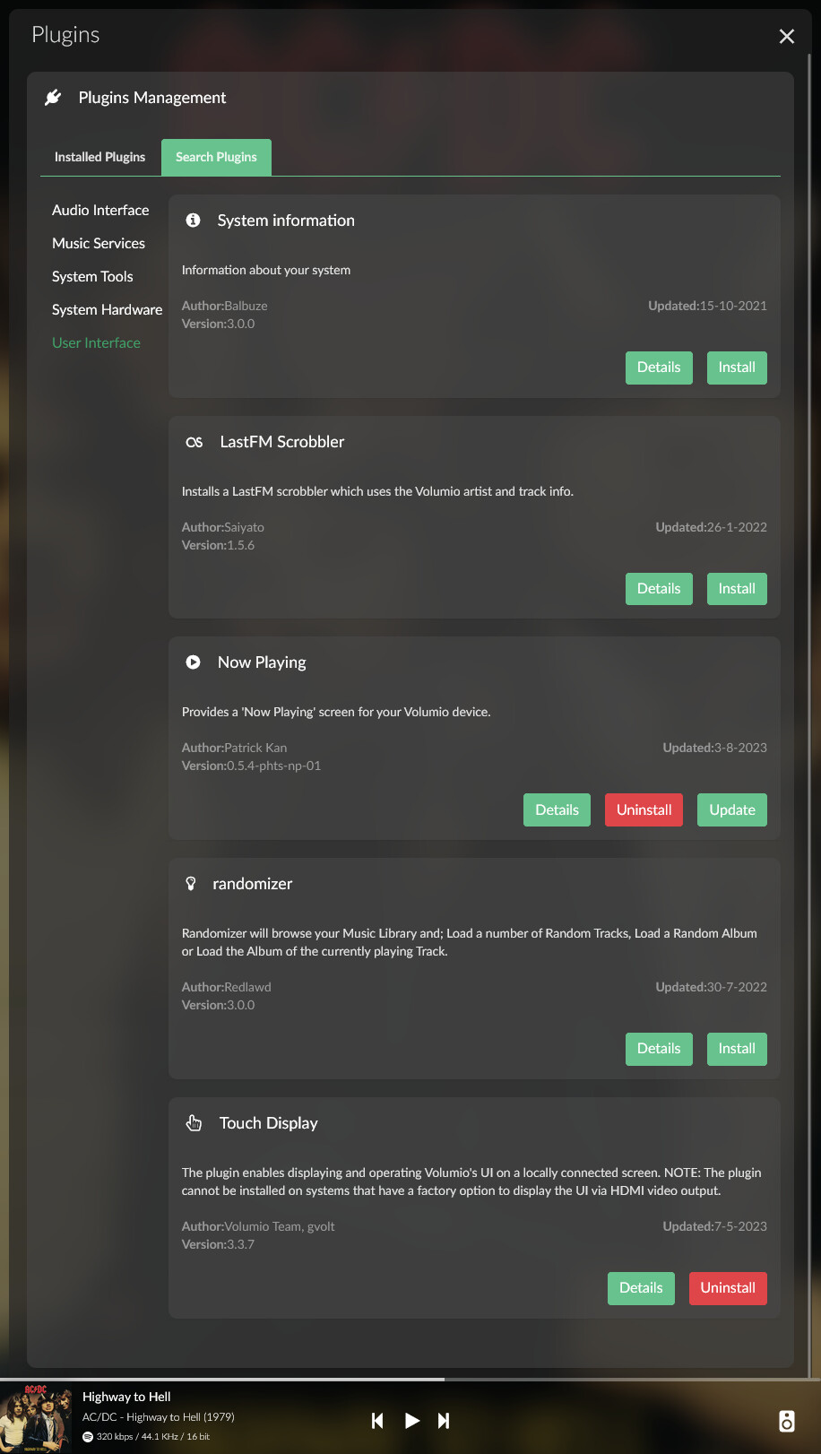

How to make it available in the store on my side? Currently I cannot find it anywhere. Tried rebooting as well, etc. Should I somehow refetch all plugins from the store manually?
This is what I have:
goto the web UI and add /dev to the URL, then enable Test Plugins
