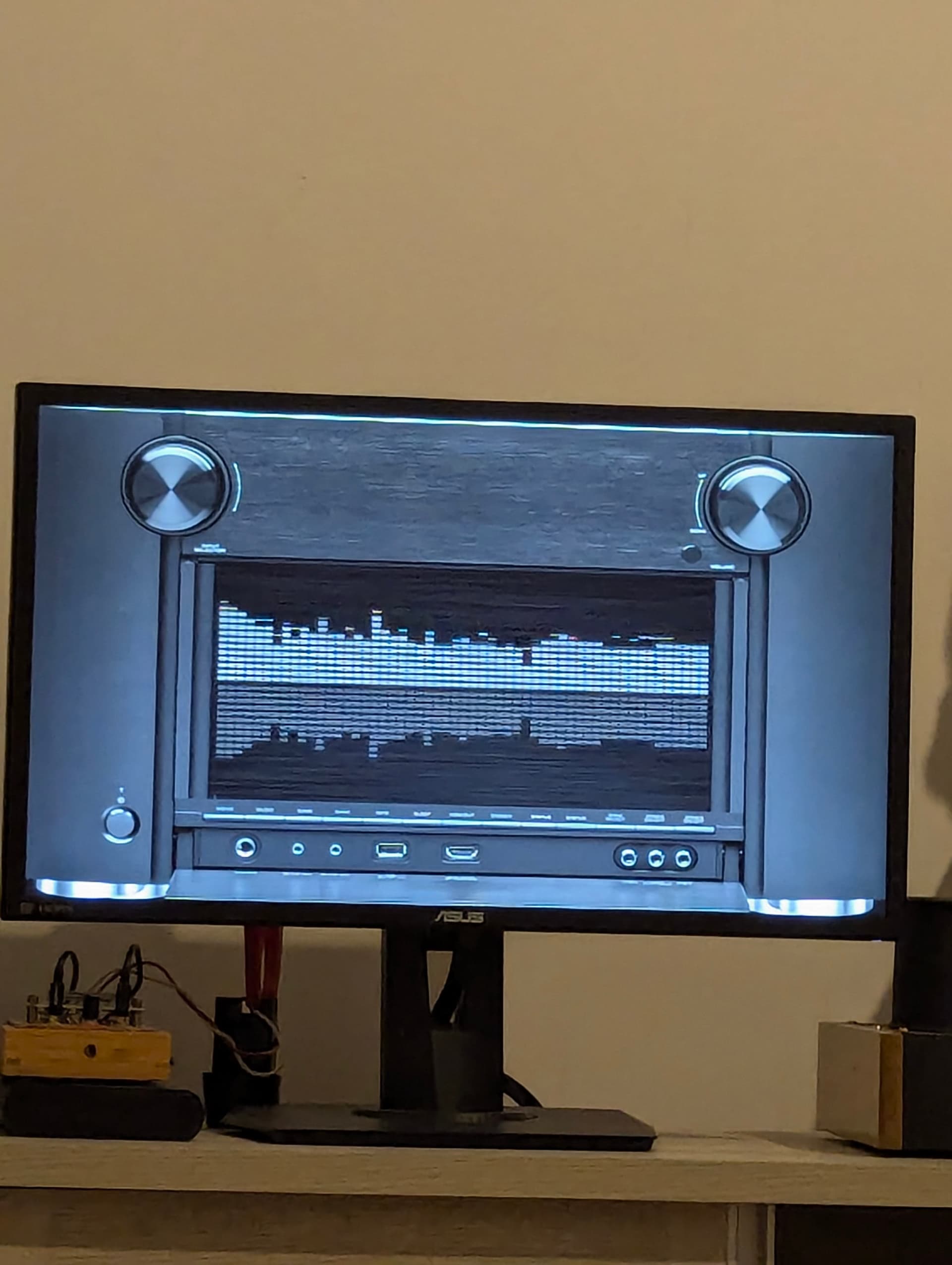

Now my peppy spectrum is working properly after reset and reinstall all the plugins .
