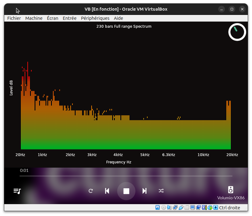

installing and working on x86
See in a VM!

Volumio X86 PeppySpectrum It was very successful, I added a short video.Thank you very much to everyone who contributed.
