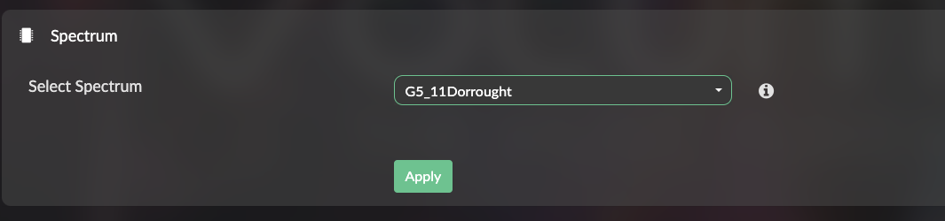

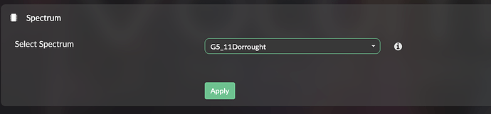

Spectrum marshal 30bars is ok while Marshall 50 bars it is shown with pauses …
after this screen nothing is shown … then after 4 seconds starts the bars
Ps
Now it plays ok …
@balbuze starts again to have pauses … I do not know what could be the trigger of that behaviour …I did not change the spectrum type

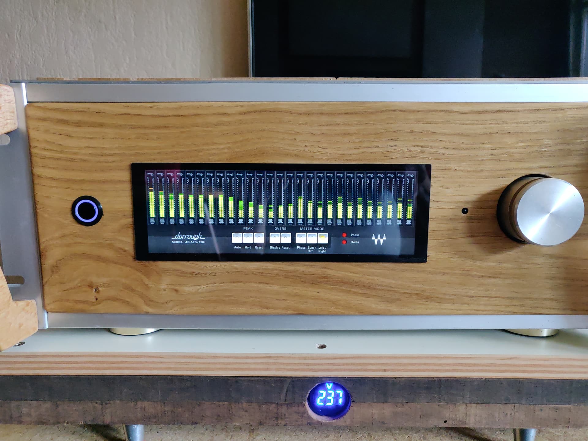

just a question, is the last 4 bars supposed to not participate or only at very high tones?
or is it left and right.
yeah, I met it time to time… Something in peppy alsa plugin?
missing high tone? maybe. Or a low bitrate webradio or 22500Hz file? mp3?

it doesn’t matter what i play, radio or spotify the last few bars don’t participate.

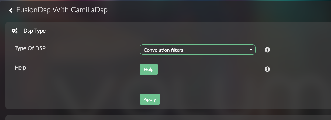

upsample FusionDSP.
give me the name of this spectrum please
with same track?
Do you have high attenuation in FusionDsp?
no, I have the effect turned off, so no high attenuation.

This problem also occurs with the peppy meter and the PCM 1794A DAC.
So I think here again my DAC is throwing a spanner in the works…Dutch

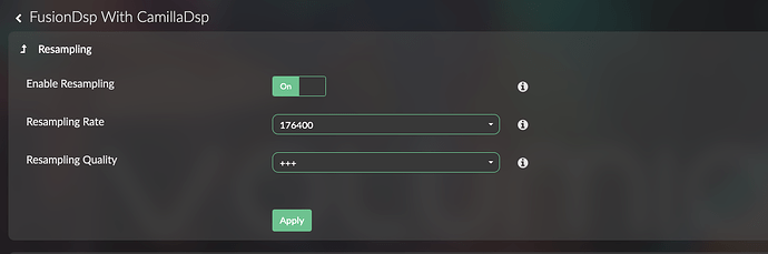

I did some tests and when the sampling rate increases (resampling), the spectrum width will reduce
Fortunately, it doesn’t affect the sound, high tones are still played…
Still in peppy-alsa side @peppy.player
That is indeed true, it changes as the sampling rate changes.

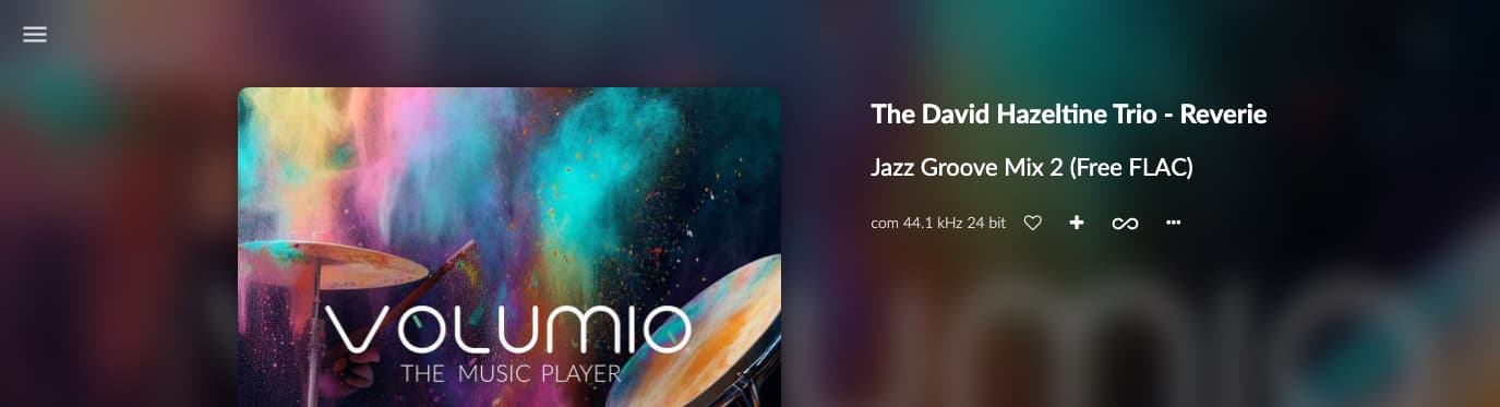

both combinations of 1794A dac chip with a reclocker (FifoMa or Fifo Q7) only work with FusioDSP upsample to 192000 or 176400, Spotify plays at a normal level.
in the normal way in volumio playback options/audio resampling for example (24 bit - 192 khz - high) I can’t get it to work with Spotify volume way too low.
internet radio at normal volume.
Without upsampling, this DAC combination does not play well and the volume level is much too low.
