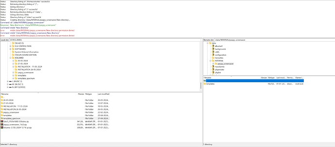

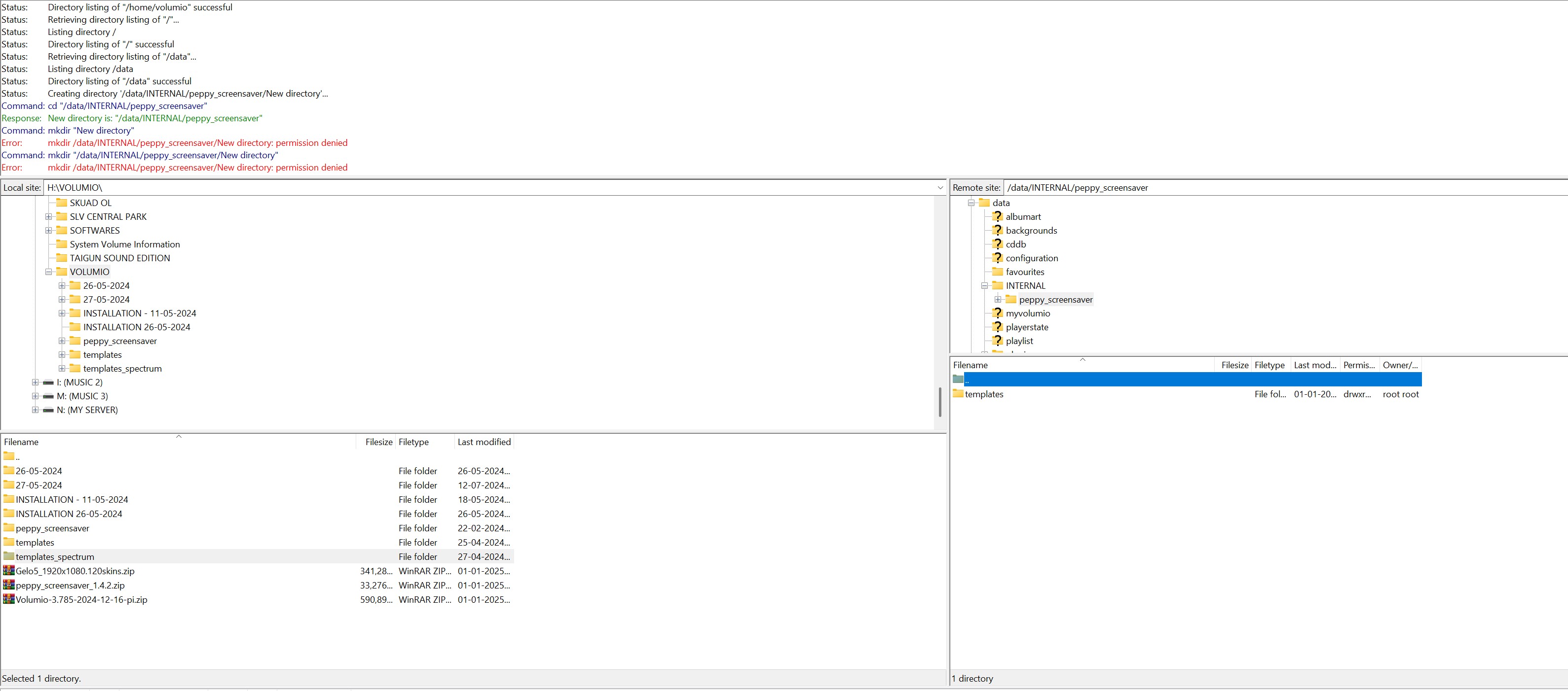

Dear @Gelo5 I am not sure what wrong I am doing here but when I am trying to transfer the templates_spectrum or trying to create a new directory, I am getting the attached error messages. Could you please suggest If I am doing anythign wrong as I am still into the dev mode of volumio.
What version of Peppymeter is this?
1.4.2ā¦ok so do I need the latest version of Peppy Meter which is 2.2.1. And install 2.2.1 only doing a factory reset ? Right @Gelo5
Yes
Thanks @Gelo5 after updating the Peppy Meter version, all I need to delete the existing templates (except 1920X1080 folder since I have 1920X1080 screen) and just follow the rest of the instructions to copy the skins you have shared here at the begining of the post, Right ?
Yes

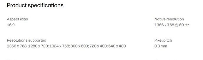

Hi all. Is anyone here using peppymeter resolution of 1366 x 768? Need help for my 18.5 inch HP monitor.
Thanks.
Have you looked here:
Thank you. I will try these.
