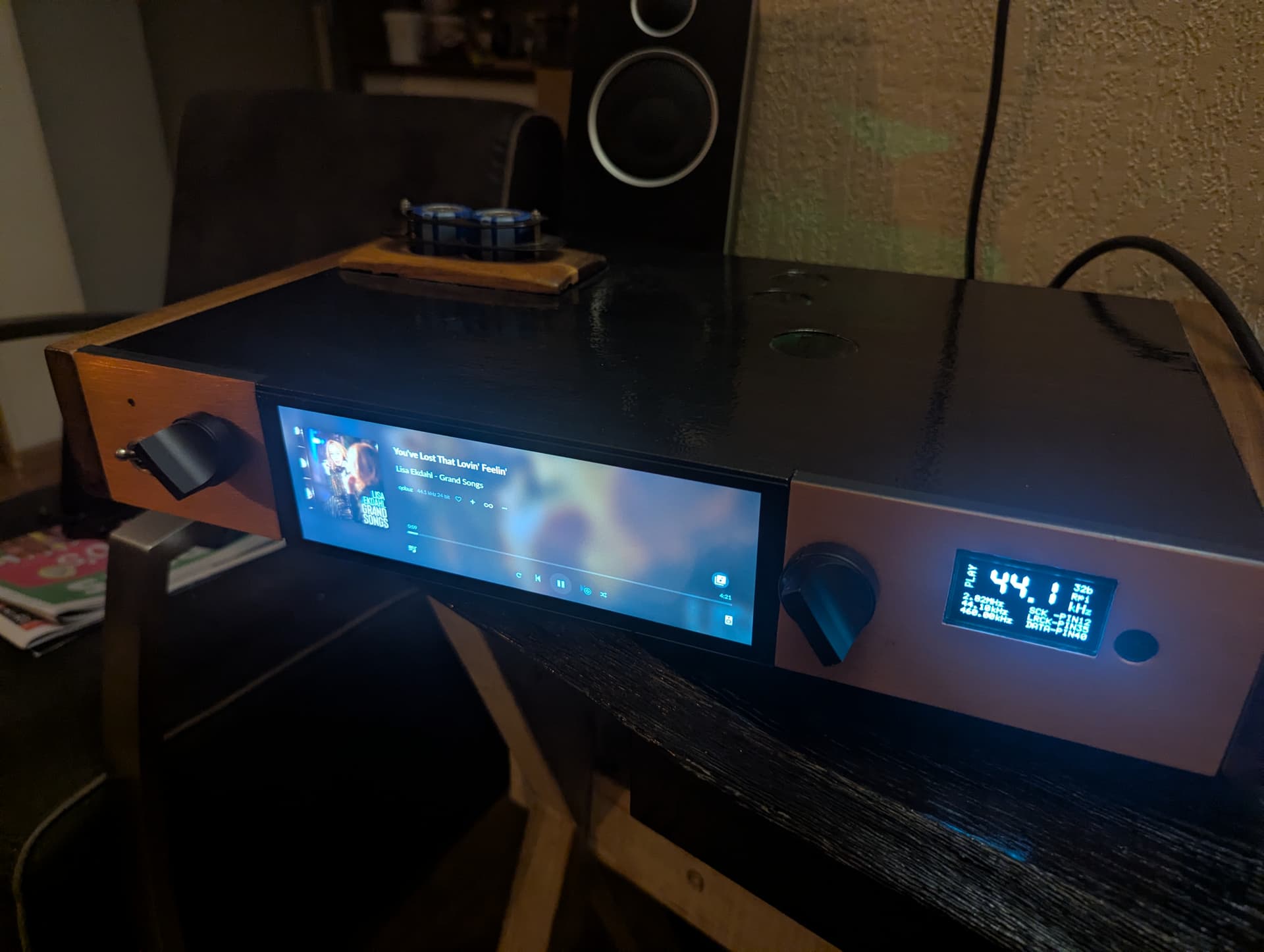

My homemade raspberry pi streamer
Love the new class D clock. where is it connected to?

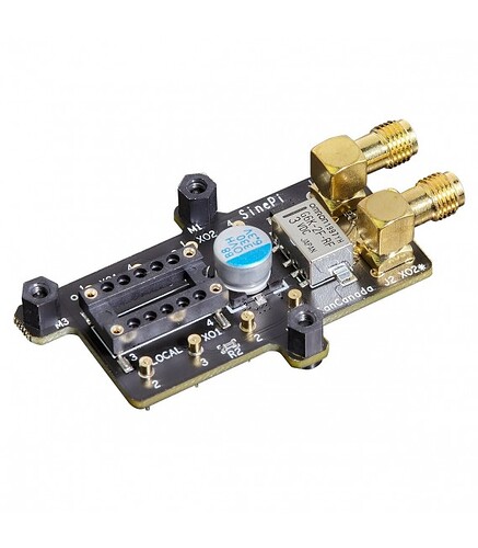

It’s connected via an Ian FifoPiQ7ll and an Ian SinePi.
In addition, I also have a ReclockPi on top, whose mclk 2 goes to the TransportPi mk2.
There is a difference in sound with the standard clocks and neutron star.
I am also big fan of the Neutron stars. Use them for DACs etc, but did not change the PI clock as such yet.
I haven’t used Volumio on this streamer DAC in a long time.
I’ve also built in a lot of extras, such as an Ian Canada DDC, 2x i²s over HDMI in and output and a 7.9-inch HDMI touchscreen. Everything works fine, except for a very long boot time with a Raspberry Pi 3…but that shouldn’t spoil the fun.

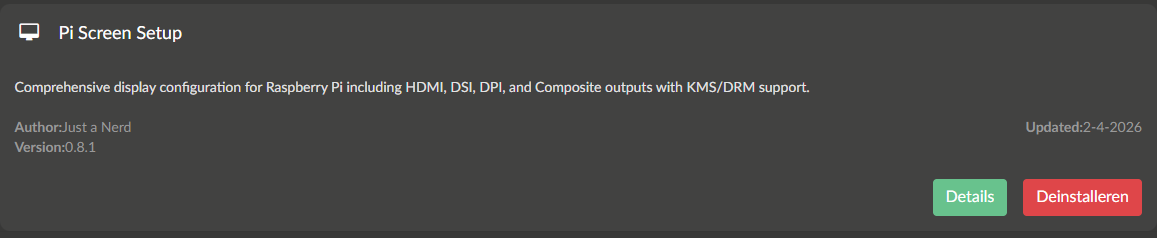

with 7.9 inch HDMI screen, infrared, activity LED, safe power off button.
For the first setup, I made good use of the Pi screen setup plugin; it works perfectly.
