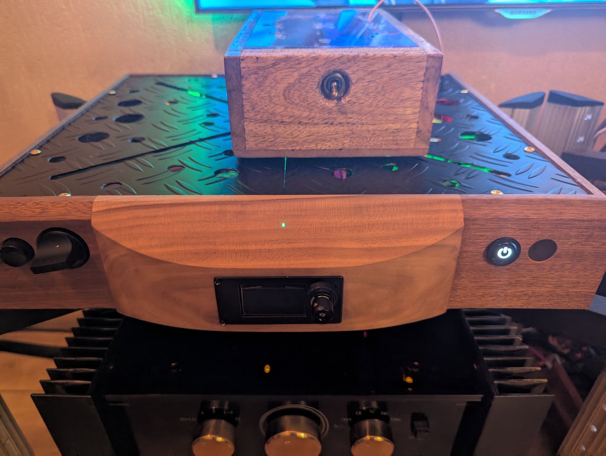

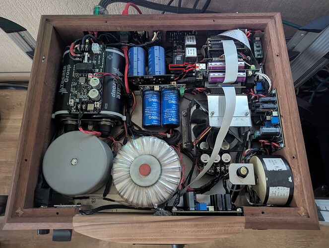

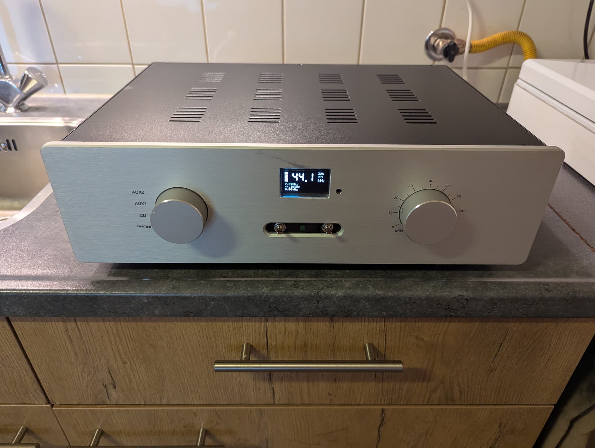

My homemade raspberry pi streamer

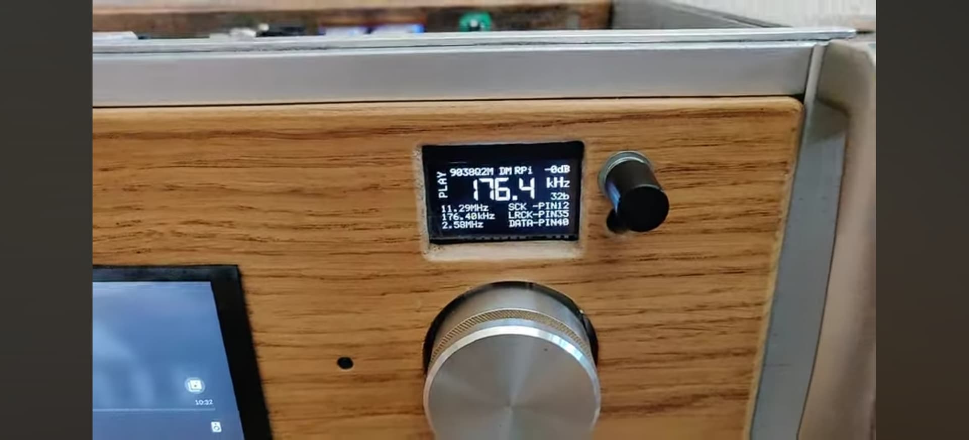

Hi Michel, could you please tell me what elements you used for this (monitor)?
looks like IAN :slight_smile:
Ian canada MonitorPi Pro
Thank you very much. Is this a standalone module or do I need to buy something else?
It works best with Ian Canada products you get more options but can also be used directly on the GPIO of a Raspberry Pi.
Super, TY

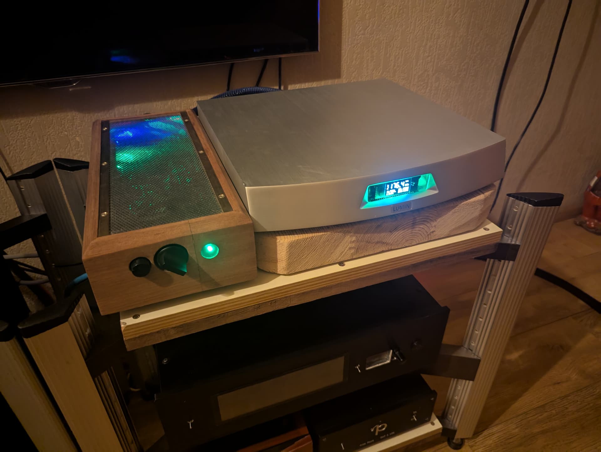

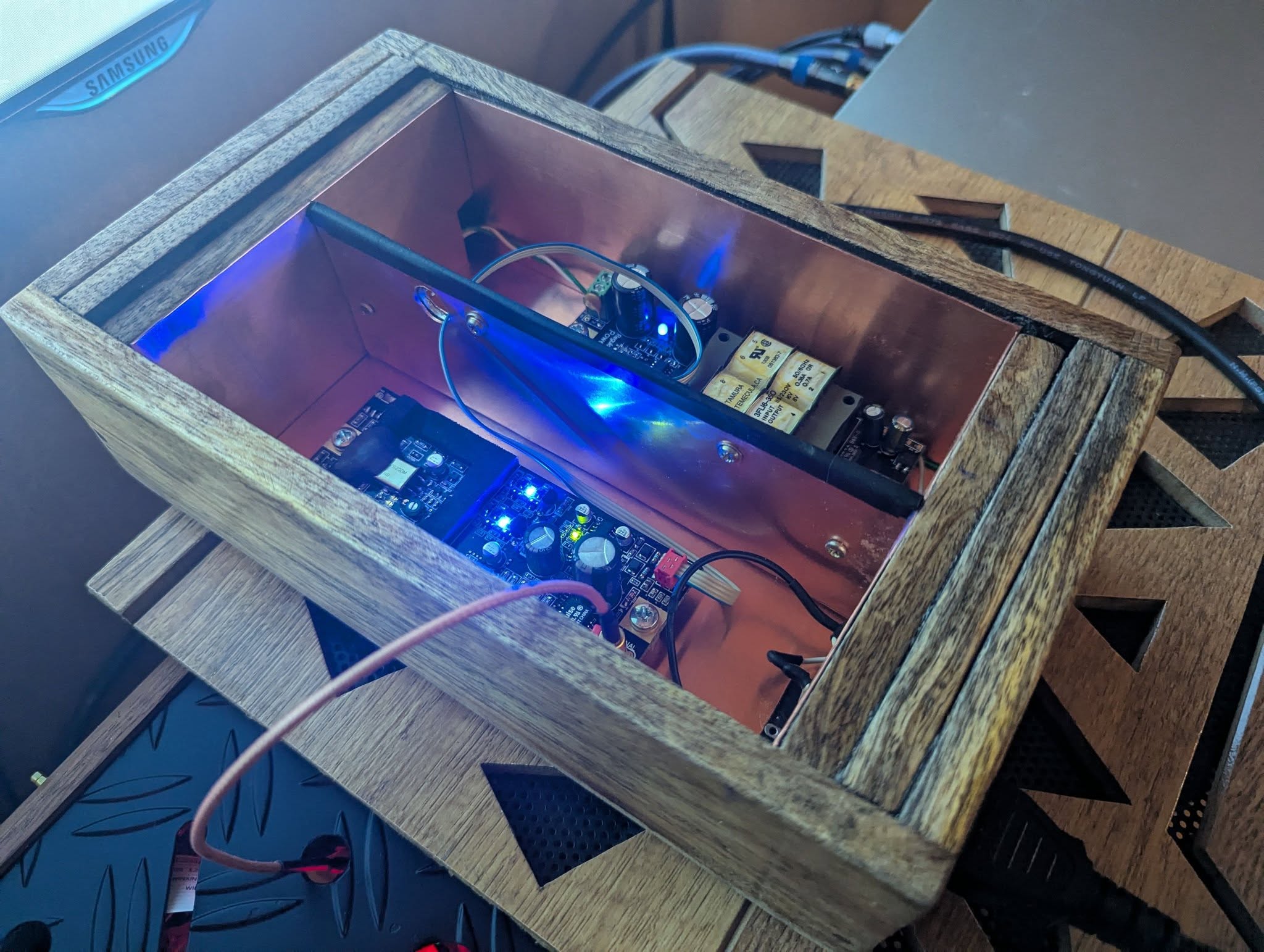

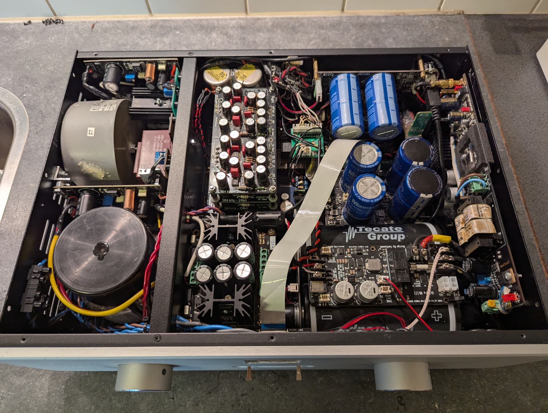

I recently added an external clock (neutron star) and neutron star power supply in combination with Ian Canada SinePi and FifoPiQ7ll
also added a Uc-Pure mklll for the 3.3 volt FifoPiQ7ll.
works well.

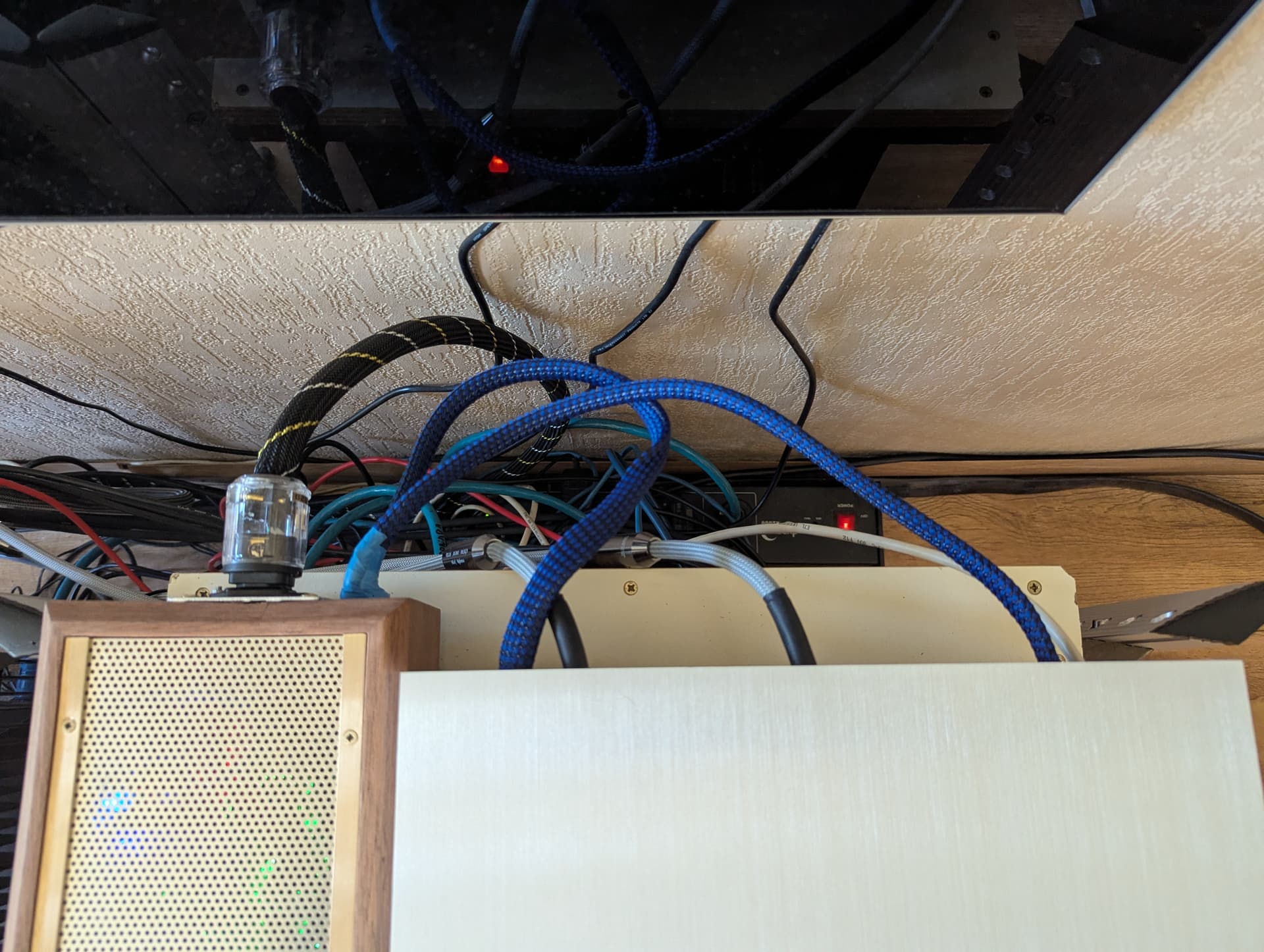

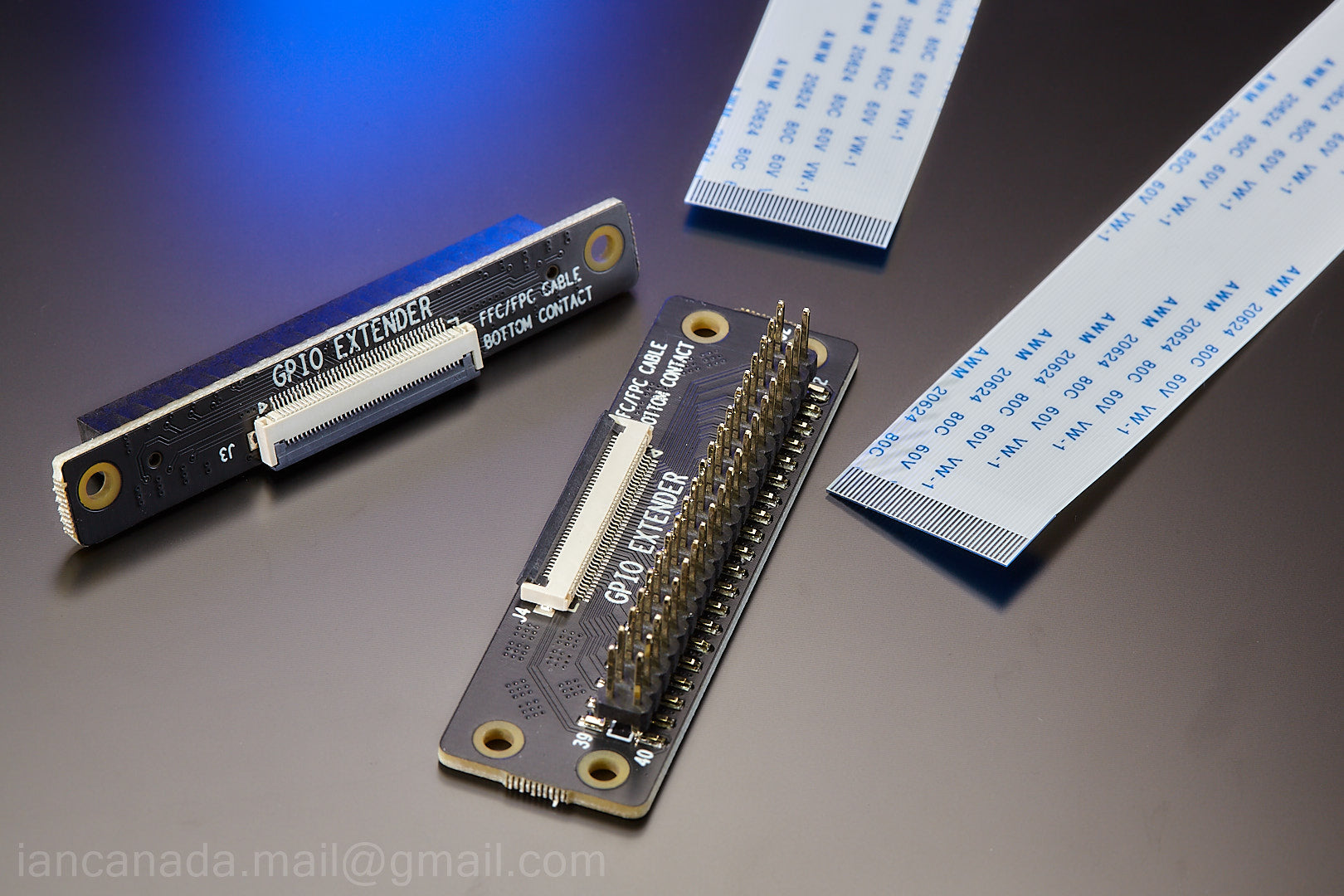

I used this to extend so that it can easily be placed in the front panel.
Great, I’ll take your advice. P.S. Where’s the RPi?
Hehe, 200kg + RPi!
it is not a light weight :grin:
but if I compare them with the other 5 that I have here, this one plays the best.
Like the arrow to the rPi :slight_smile:
And one last question: is this compatible with the RPi5? I bought 2 new ones.
yes.

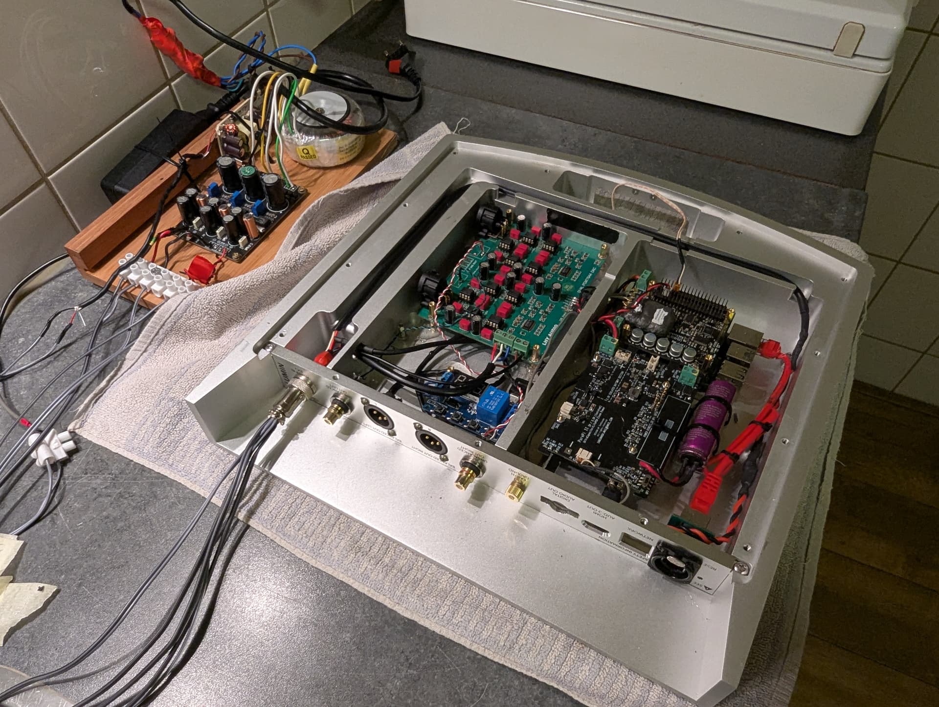

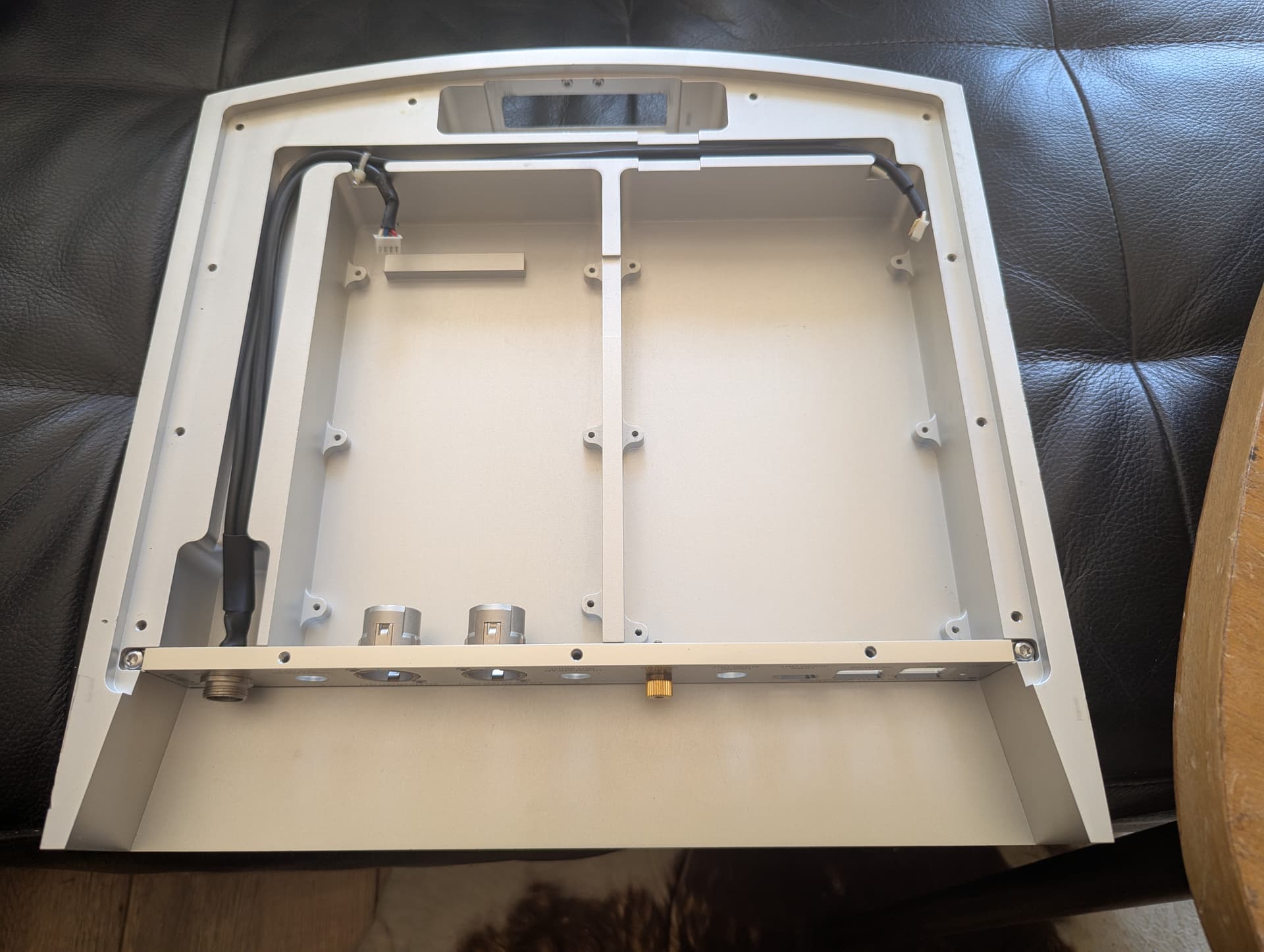

made from a broken lumin S1.
pcm 1794A with ian Canada products.
with external power supply.
only had 4 cm of height and it was a hassle to get it in.
just needs a smoke tinting window for.
Ian Canada (Dddac) neutron star clock version 2.

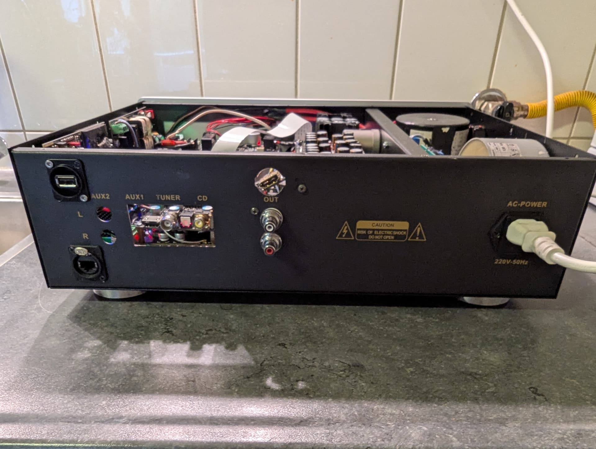

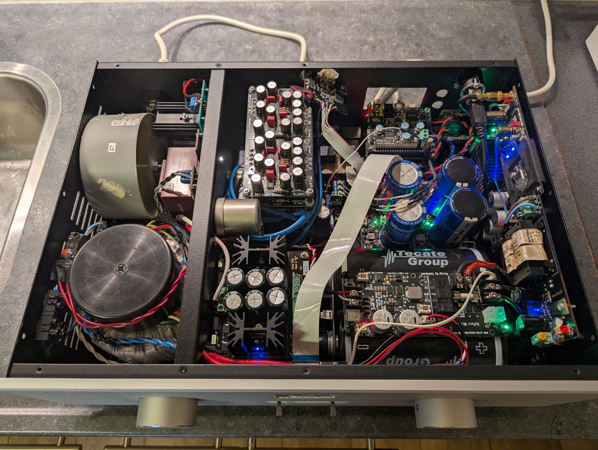

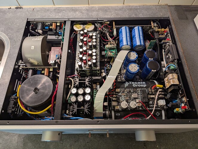

Update:

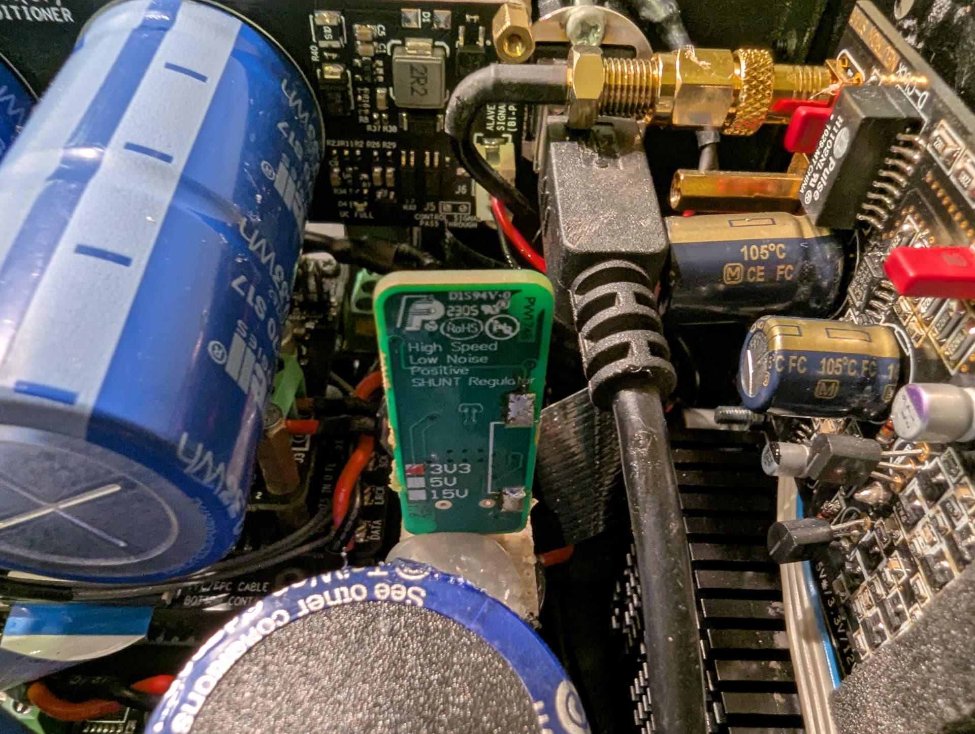

Created a 3.3-volt shunt (Tent Labs) for the Ian Canada TransportPi MK2 input.

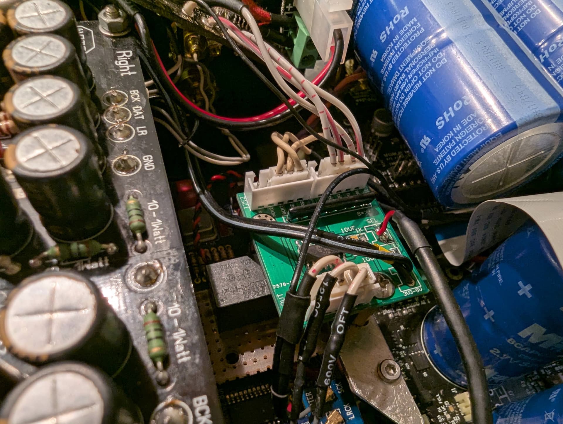

Created an Ian Canada UCmate 5-volt for the Pink Faun HDMI LVDS input module, plus trigger to start/stop.
Moved the sowter output transformers (shorter distance).
Added an I²S switchboard; can now switch between DDDAC input, I²S, SPDIF, and HDMI LVDS input.
