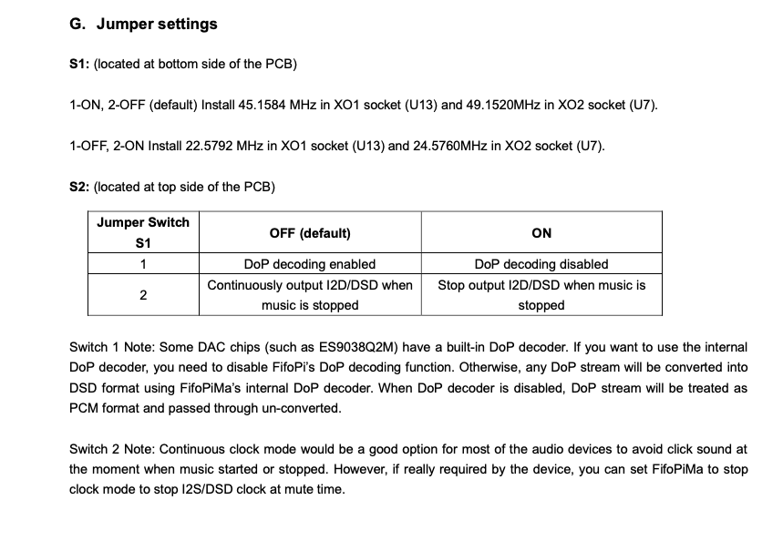

apparently that doesn’t work. also not other jumper setting (Dop decoding)
already tried everything else.
