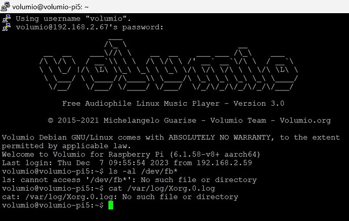

The result of cat /var/log/Xorg.0.log lets me assume that the Touch Display plugin has not been started. But starting the plugin is pointless anyway as long as the display is not recognized by the OS at all which the result of ls -al /dev/fb* is indicating.
If IIRC the display did not work with PiOS either. Is that (still) correct?

volumio@volumio-pi5:~$ cat /var/log/Xorg.0.log
