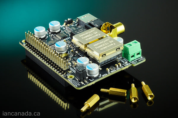

I’m having trouble using the Transport Pi Digi streamer with Volumio. The set up- UcPi for power, Rpi4 loaded with the latest version of Volumio, Transport Pi Digi on top. The DAC is a Denafrips Enyo (no I2S input).
I’m trying to connect the streamer via SPDIF coax to the Denafrips. There is no option to select SPDIF output in the Playback Options tab, only HDMI and headphones. I previously had the same DAC connected to the RPi via USB and everything worked as it should. The reason I bought the HAT was to use it via SPDIF for the benefit of reclocking the signal. I have searched the forums, no joy. It seems this may not be compatible with Volumio but, I hope so.Thanks in advance for any help.
