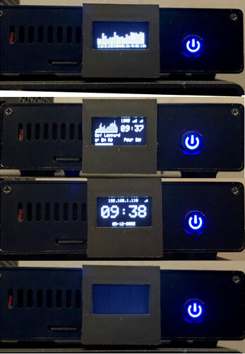

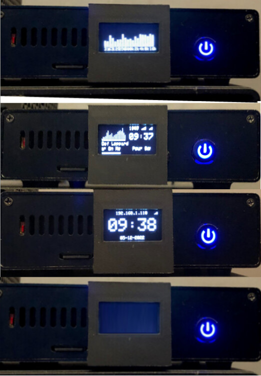

Just tested it on the main branch for the rpi and it works.
Depending on the content of status.txt, it draws one of these screens.
0 = Full CAVA
1 = Default screen
2 = Clock
3 = Blank

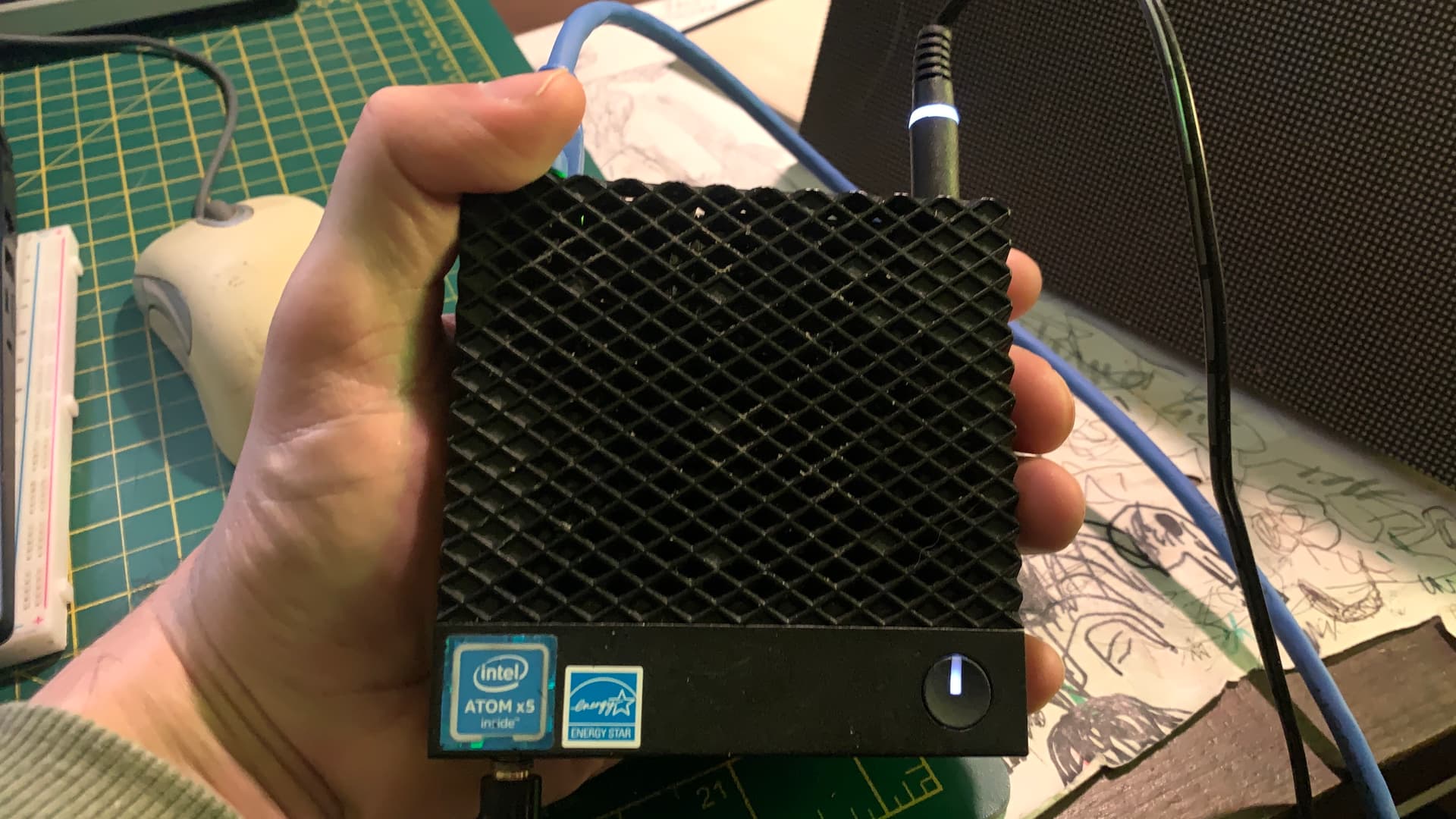

I got my Wyse 3040 and it’s amazing! Bargain for £40 :clap:t4::clap:t4:

My Dell Wyse 3040 in my hand! :muscle:t4::muscle:t4:
Looks good enough to have on display in your living room but also sturdy enough to shove it out of sight. Can also open the case, remove 2 screws and the whole thing could be shoved in an enclosure.
Just added a PCB with 4 push buttons. So I can select which layout by pushing one of them.

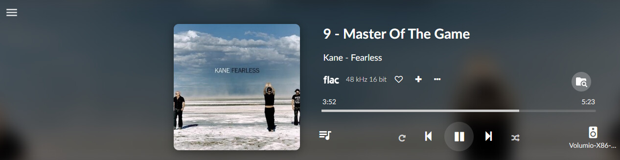

When I boot my Wyse with a monitor plugged in to the DisplayPort I see the Volumio UI full screen. I bet this would also work with DP to HDMI converter. I’m not sure if a wide display would look good but I can confirm the UI is there on boot!
If you have a display with touch built in, it might be possible to get touch working over USB? I haven’t used touchscreen yet. I do have a touchscreen in a box (official pi) but have never used it.
Wide will look good with the latest beta. They’ve made changes to the Manifest UI.
