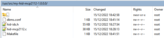

I got the hid-mcp2221 module built with dkms on Ubuntu as follows
I created a directory /usr/src/my-hid-mcp2221-1.0.0.0 and copied hid-mcp2221.c and hid-ids.h from the kernal source into it. Then created dkms.conf

yeah that didn’t go well:
volumio@volumio-dev:/usr/src$ sudo dkms add -m my-hid-mcp2112 -v 1.0.0.0
Creating symlink /var/lib/dkms/my-hid-mcp2112/1.0.0.0/source ->
/usr/src/my-hid-mcp2112-1.0.0.0
DKMS: add completed.
volumio@volumio-dev:/usr/src$ sudo dkms build -m my-hid-mcp2112 -v 1.0.0.0
Kernel preparation unnecessary for this kernel. Skipping...
Building module:
cleaning build area...
make -j4 KERNELRELEASE=5.10.139-volumio -C /lib/modules/5.10.139-volumio/build M=/var/lib/dkms/my-hid-mcp2112/1.0.0.0/build...(bad exit status: 2)
Error! Bad return status for module build on kernel: 5.10.139-volumio (x86_64)
Consult /var/lib/dkms/my-hid-mcp2112/1.0.0.0/build/make.log for more information.
Make.log:
DKMS make.log for my-hid-mcp2112-1.0.0.0 for kernel 5.10.139-volumio (x86_64)
Thu Dec 15 18:43:40 CET 2022
make: Entering directory '/usr/src/linux-headers-5.10.139-volumio'
make[1]: *** No rule to make target '/var/lib/dkms/my-hid-mcp2112/1.0.0.0/build/my-hid-mcp2112.o', needed by '/var/lib/dkms/my-hid-mcp2112/1.0.0.0/build/my-hid-mcp2112.mod'. Stop.
make: *** [Makefile:1832: /var/lib/dkms/my-hid-mcp2112/1.0.0.0/build] Error 2
make: Leaving directory '/usr/src/linux-headers-5.10.139-volumio'
You have a file called hid-mcp2112.c, which I believe you have renamed from the name of the file in the kernel (extra ‘m’). It might be worth checking the names in dkms.conf and Makefile are consistent with this.
dkms.conf:
PACKAGE_NAME=my-hid-mcp2112
PACKAGE_VERSION=1.0.0.0
BUILT_MODULE_NAME[0]="my-hid-mcp2112"
DEST_MODULE_LOCATION[0]="/kernel/extra"
AUTOINSTALL=yes
Makefile (including TAB
EXTRA_CFLAGS+=-DLINUX_DRIVER -mhard-float
obj-m += my-hid-mcp2112.o
my-hid-mcp2221-objs:= hid-mcp2112.o
all:
make -C /lib/modules/$(kenelver)/build M=$(PWD) modules
clean:
make -C /lib/modules/$(kernelver)/build M=$(PWD) clean
euh…my-hid-mcp2221-objs ??
You have a 2221 instead of a 2112
typos?
yes yes, saw it and corrected it.

kattr->attr.name, report.length);
./include/linux/dev_printk.h:112:32: note: in definition of macro 'dev_err'
_dev_err(dev, dev_fmt(fmt), ##__VA_ARGS__)
/var/lib/dkms/my-hid-mcp2112/1.0.0.0/build/hid-mcp2112.c:1007:3: note: in expansion of macro 'hid_err'
hid_err(hdev, "invalid %s string length: %d\n",
/var/lib/dkms/my-hid-mcp2112/1.0.0.0/build/hid-mcp2112.c:1012:17: error: 'struct cp2112_string_report' has no member named 'length'
length = report.length > ret - 1 ? ret - 1 : report.length;
/var/lib/dkms/my-hid-mcp2112/1.0.0.0/build/hid-mcp2112.c:1012:53: error: 'struct cp2112_string_report' has no member named 'length'
/var/lib/dkms/my-hid-mcp2112/1.0.0.0/build/hid-mcp2112.c:1013:39: error: 'struct cp2112_string_report' has no member named 'string'
length = (length - 2) / sizeof(report.string[0]);
/var/lib/dkms/my-hid-mcp2112/1.0.0.0/build/hid-mcp2112.c:1014:30: error: 'struct cp2112_string_report' has no member named 'string'
ret = utf16s_to_utf8s(report.string, length, UTF16_LITTLE_ENDIAN, buf,
make[1]: *** [scripts/Makefile.build:286: /var/lib/dkms/my-hid-mcp2112/1.0.0.0/build/hid-mcp2112.o] Error 1
Summary:
Makefile:
my-hid-mcp2112-objs:= hid-mcp2112.o
all:
clean:
dkms.conf:
AUTOINSTALL=yes
commands executed:
sudo dkms install -m my-hid-mcp2112 -v 1.0.0.0
The build worked fine for me on Ubuntu. Perhaps you could use the kernel files hid-cp2112.c and hid-ids.h from the Volumio kernel source. The files you used might be expecting different headers.
