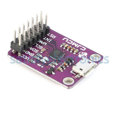

A CP2112 based board might be another interesting option for I2C, as it appears to have a driver included with linux
It looks like there might be an official linux driver for @supercrab MCP2221 board as well (I don’t know if it is enabled in Volumio)
Thanks! I’ve just ordered one from AliExpress probably take ages to arrive though :roll_eyes: Not to worry, there’s no rush for this board.

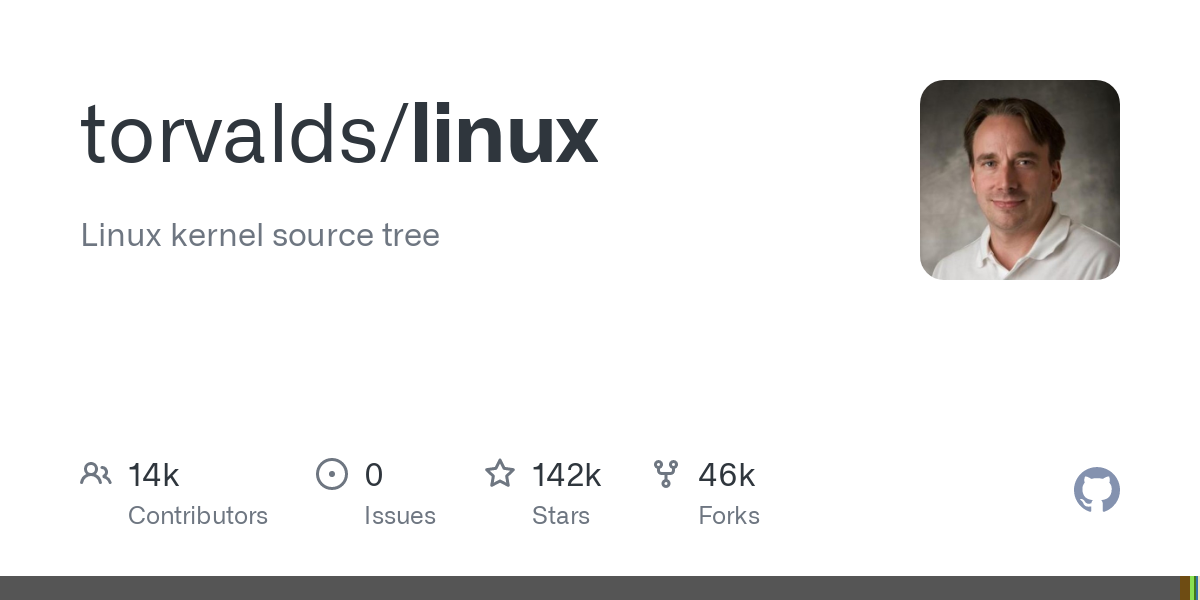

I don’t think the official kernel includes a CH341 driver for I2C
And from: linux/ch341.c at master · torvalds/linux · GitHub
 * ch341.c implements a serial port driver for the Winchiphead CH341.
 * The CH341 device can be used to implement an RS232 asynchronous
 * serial port, an IEEE-1284 parallel printer port or a memory-like
 * interface. In all cases the CH341 supports an I2C interface as well.
 * This driver only supports the asynchronous serial interface.

I have found delivery times from China have improved a lot in the last few months. I recieved my last order a couple of weeks ago. It was meant to take 4 - 6 weeks, but arrived in 3. Just like the old days!
I want one of these little purple boards too, I just need to come up with an amazing application that absolutely depends on it.

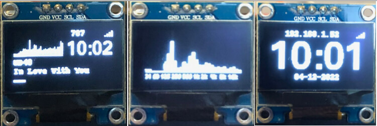

mpd_oled - x86 :slight_smile:
Good thinking, it just needs a case that the CH341 board is too big to fit into.

Let’s hope that the kernel supports the CP2112, so we don’t have to break OTA update of volumio.
