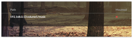

I have a problem with the latest version to mount an NFS share. The interface automatically adds the colon (:slight_smile: at the end of IP address and the share is unmounted:
The NFS share works from other PCs, any suggestions?
