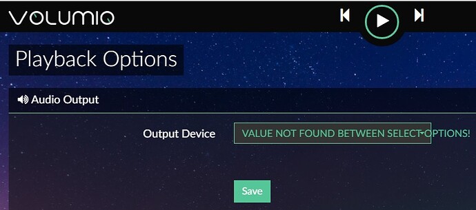

I just wondered that as there appears to be no signal at all from the HDMI, that that was the reason that no sound card/device was discovered.
This is what I get on the Playback Options screen:
Cheers.
oops :blush: never tested that…
Ok, the kernel I used obviously had no support for hdmi (which didn’t bother me as I started off headless).
I would need to see if it supported now and then recompile the kernel. with hdmi audio.
Not likely going to happen soon, as this means a lot of work with only one potential user and plenty of other things to do…
Yes, bugger, I know but hope you understand.
In the meantime, get a good USB DAC and you’ll be OK.
