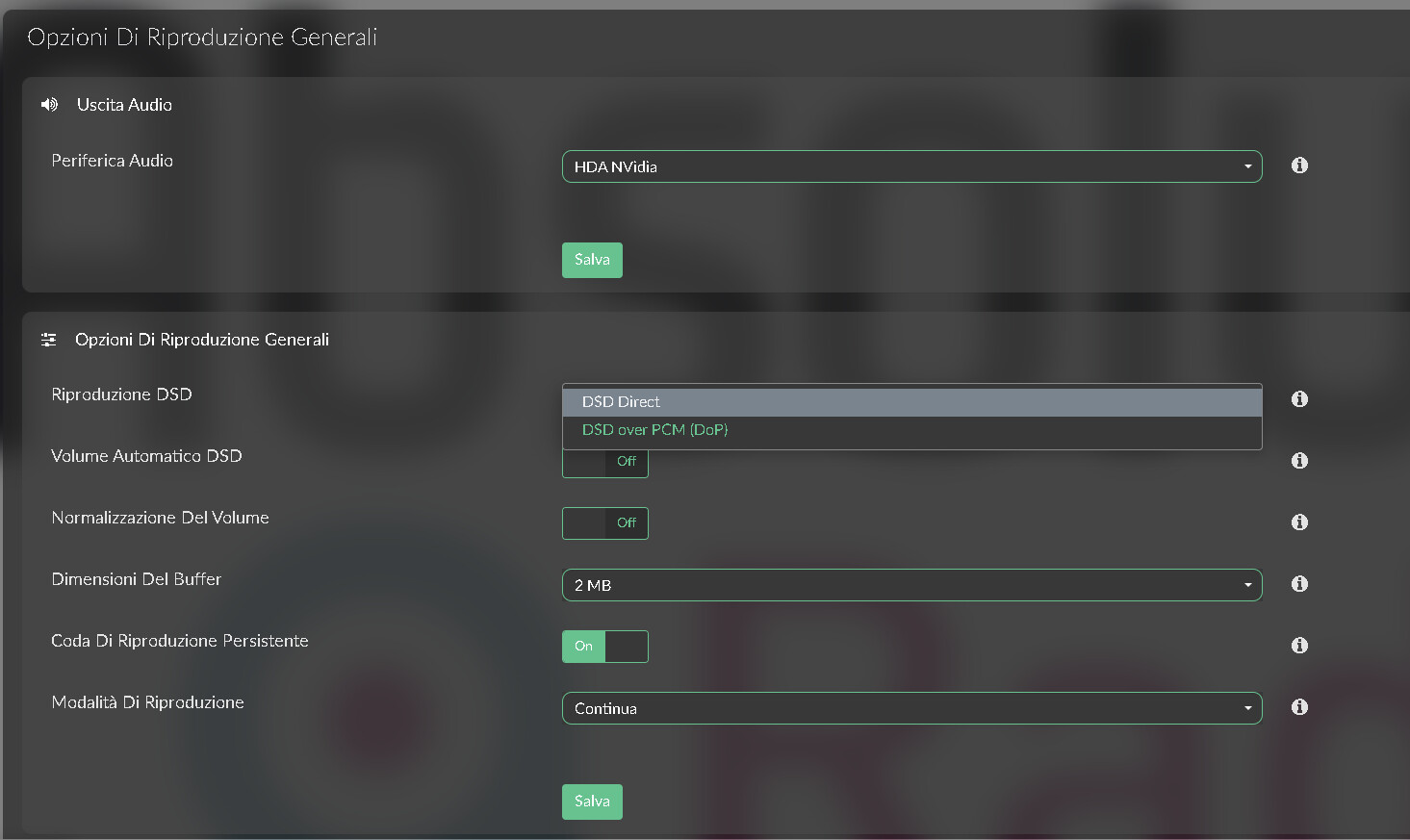

Did you look at the content of the drop down list of values under āPeriferica Audioā?
(the best Italian attempt of me, besides Pizza and tanta birra, per favore)
itās correct. May i sugggest birra FREDDA??
hot beer itās not goodā¦
Periferica audio and output device obviously are the same
I have no choice. Only Nvida HDA which stands for High Definition Audio. Gpu output?
Yeah thanks for the correction, only those English folks drink warm beerā¦

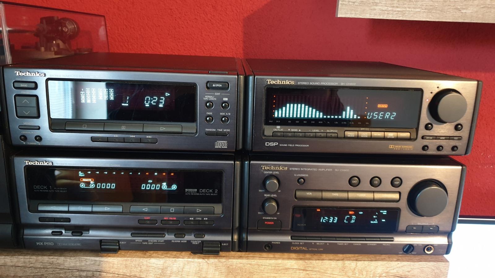

But, what about leaving the miaolai and take a digital output (s/pdif for example) from the pc and ending to my Technics sc ch900?
It has DAT input and other optic fiber input , in the signal process unit, so i must assume it can manage digital input, isnt it?
