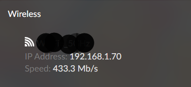

First screenshot is without the dongle , the 2nd with. Looking at the transmission speed the 2nd uses the dongle.
OK. I just installaed a fresh image of 3.703. I’m getting 433.3 Mb/s as you do.

Yes a blinking green LED, below tp-link. Its connected to the USB3 port as it won’t work on USB2?
I do indeed have it connected on a USB port (Blue). There is no blinking green LED.
