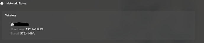

I installed this today on a Pi5 running new install of Volumio and it was straight PnP - took settings from the internal WiFi and rocked on . It’s pretty beastly so I got an extension to give the Pi some personal space :slight_smile:
Thank you sooo much. You are really getting some great speeds out of that adapter. I also like the extension dock. What a great combo.
I really would like to hear from others that have working wifi dongles, as the EDUP AX3000M is a bit hard to source where I live, (not impossible ). So great that it is a PnP, surely there are other dongles out there that can do this as well. Please share your wifi dongle setups…Again, thanks
