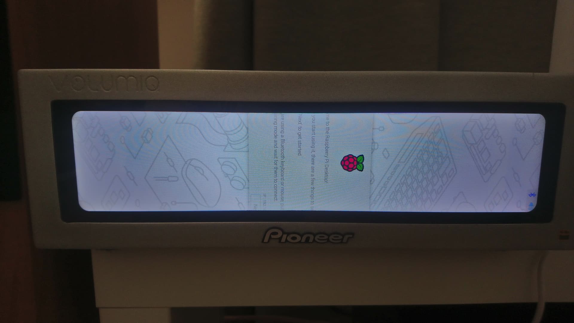

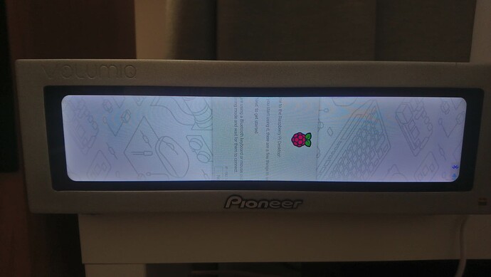

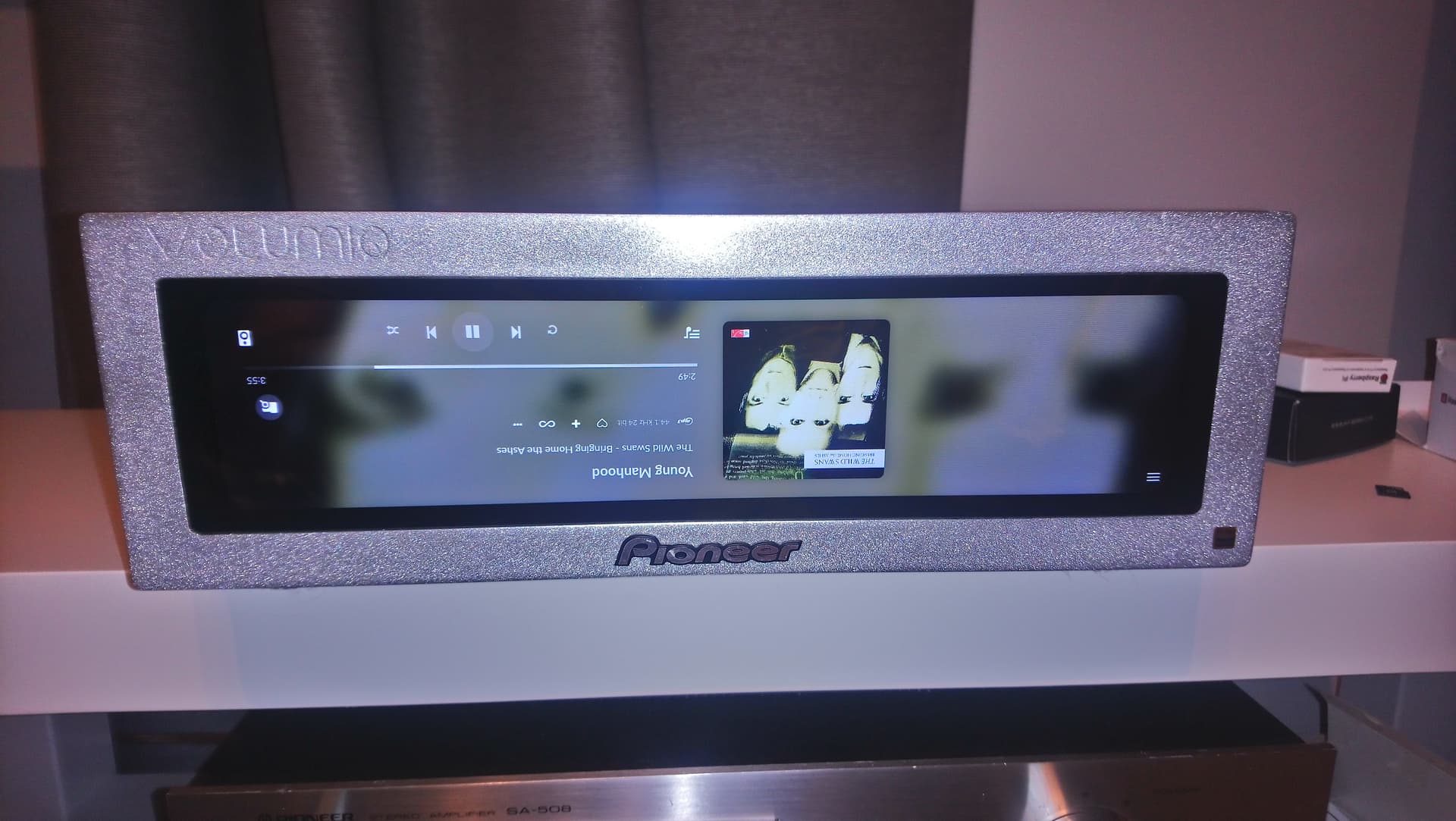

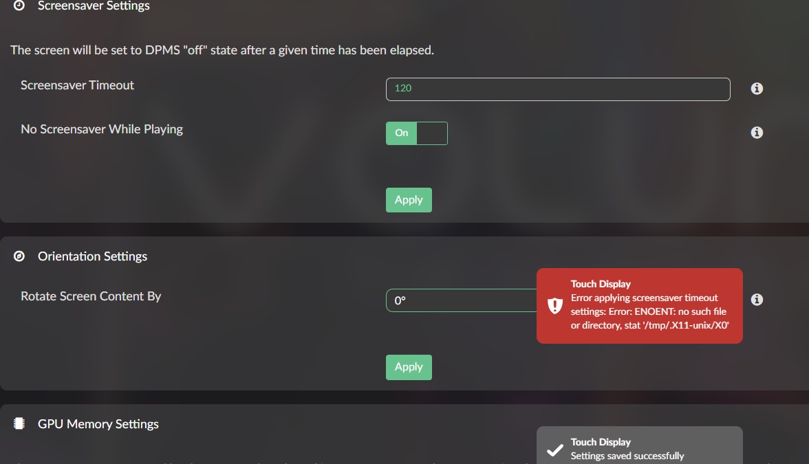

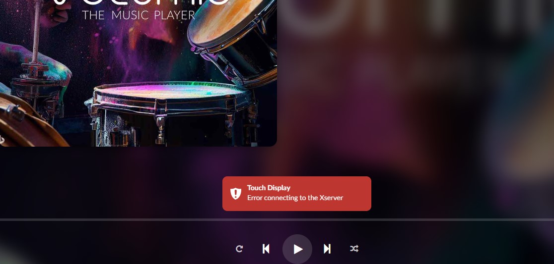

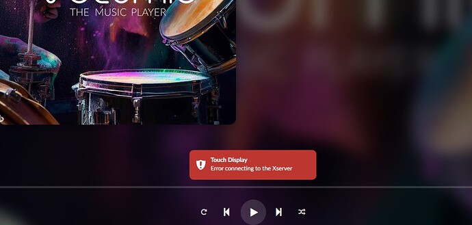

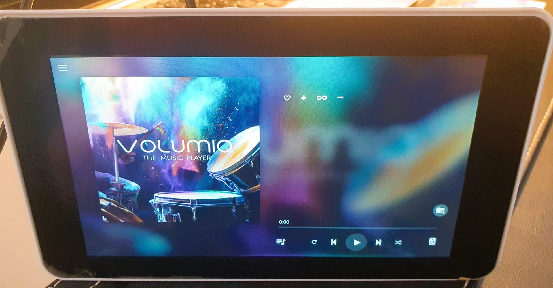

Reinstalled over and over again from different mirrors. Had one result. May be the problem is that I installed plugin not from the official mirror?
Error during the No screen saver apply.
Gvolt, I bought RPI 5 and made new installation from your instructions. And I have no errors and black sreen… No image on screen, only working during the boot time (volumio login…).
The hardware is working good. For example this is the clear RPI OS without any additional changes.

I made new clear installation. No effect.
Please try the following:
Stop the Touch Display plugin.
Then execute
sudo bash -c 'cat << EOF > /etc/X11/xorg.conf.d/99-vc4.conf
Section "OutputClass"
Identifier "vc4"
MatchDriver "vc4"
Driver "modesetting"
Option "PrimaryGPU" "true"
EndSection
EOF'
Start the Touch Display plugin again.
WORKING!!! THANK YOU!!!

But now I can rotate it on 180 degrees.
And after 3-5 minutes the screen is turning on black.
By doing what?
For rotating 90 degrees to the left:
mkdir /home/volumio/.config/openbox
cat >> /home/volumio/.config/openbox/autostart <<EOL
xrandr --output HDMI-1 --rotate left
EOL
Then stop and start the Touch Display plugin.
What are the “Screensaver settings” on the Touch Display plugin’s config page?
Can’t rotate the screen after the first change. Need to rotate on 180 degr.
Changed the Screensaver timing - it’s OK.
Just out of interest: Isn’t is possible to rotate the display using xrandr?
Not possible. Tried 3 times.
Or modify the config file manually?
No, the xandr command in “/home/volumio/.config/openbox/autostart” should be executed when the Touch Display plugin starts.
You can also test from Volumio’s console, e.g. with
xrandr --display :0 --output HDMI-1 --rotate right
But the overlay “vc4-kms-dsi-waveshare-panel” also has a rotation option, e.g. for rotating by 90 degrees:
dtoverlay=vc4-kms-dsi-waveshare-panel,11_9_inch,rotation=90
Just turned of the power. After that the screen rotate is working. That’s all.

Where did you get that faceplate made?
This is the fabric made case for DIY amplifer. The place for disply was cutted on the laser grave company in my town. Then I painted the plate.
Thanks, @Darmur for this clarification as well as @volumio team for implementing drivers in the new release!
This is so much easier and functional. Tested it on Waveshare 7inch C display - works flawlessly!
For those interested, I added in userconfig.txt following lines for perfectly working display with correct touch orientation, if using with standard case:
dtoverlay=vc4-kms-v3d
dtoverlay=vc4-kms-dsi-waveshare-panel,7_0_inchC,i2c1,rotation=180,invx=1,invy=1
P.s. I changed your answer to solution of this topic. Cheers! ![]()
