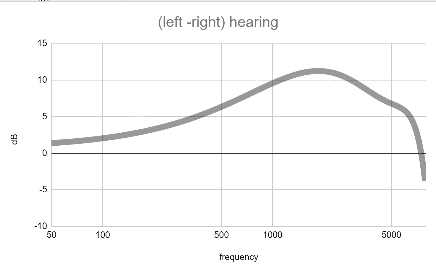

Balbuze, like many Volumio users, I suffer of asymmetric hearing loss which means the two ears have different frequency response. Here is the difference between the left and right here. This was caused by too much shooting without ear protection. Left is lower than the right by the amount shown on the y axis.
I am unable to check out the parametric equalizer because the search plugin feature is not working right now and I understand they are working on it. Questions is- can the parametric equalizer be set up by channel? I would then use it to compensate for the asymmety between the two ears and be back in business. This I think would help a lot of people with defining a good center phantom image when their hearing is not symmetric. Perhaps it is already set up that way?
You can’t do that with the plugin parametric EQ or graphic EQ.
But you can use the plugin DSPforvolumio and set two different attenuation (one for left and one for right).
