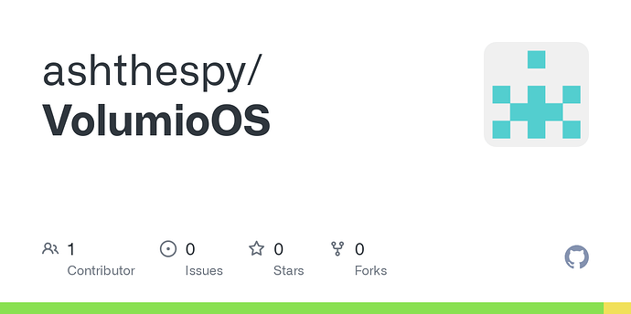

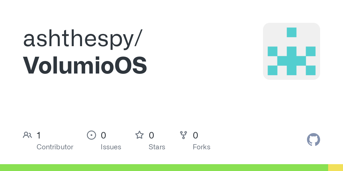

PS: I also don’t use that Build system to make these images, as I found it extremely hard to debug and extremely error prone with all the copy pasting going on for the different boards - but again this is all my personal opinion(s) ![]()

That branch is for x86 I believe, these images are built from my fork, where I tried to refactor the build system to be a lot more modular, but has diverged from the original repo a bit since…
