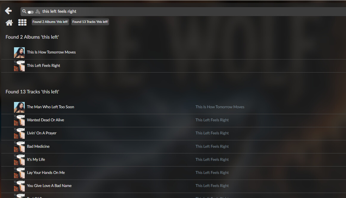

Problems, problems…again and again> every time when a global search (for a track or album) being engaged, both Rivo and the app (IoS) get stuck dead…only a soft (sometimes hard) restart helps. Seriously guys, when are you going to fix this mess with 4. 156 beta version? Are we to expect some solution before ‘‘ferragosto’’ or to wait September or later?

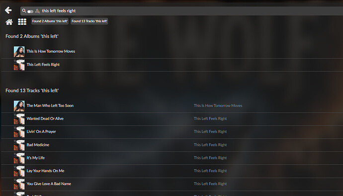

  • If i run a search in “Music Library”, “Artist” or “Album” it doesn’t crash but I get simply no results

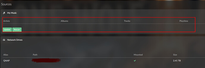

  • When the green bar finally finish the mount to my NAS is still there, however MPD crashed. and all albums are gone. Only way to get them back is reboot. even systemctl restart mpd doesn’t fix it.
  • If I run a search in the default Music page, only results from Qobuz, Tidal and Spotify are returned

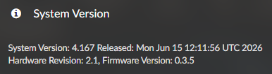

I only see beta 4.156 in the test channel, which has stayed the same for a loooong time now. Where did you get 4.167 from?
Hi @NikosR
This is not even a Beta release, so strongly advise you not to use it, unless the peeps from Volumio tell you to install it.

For the time being you can mount your NAS with CIFS.
This solves the crashing and missing search issue for me.

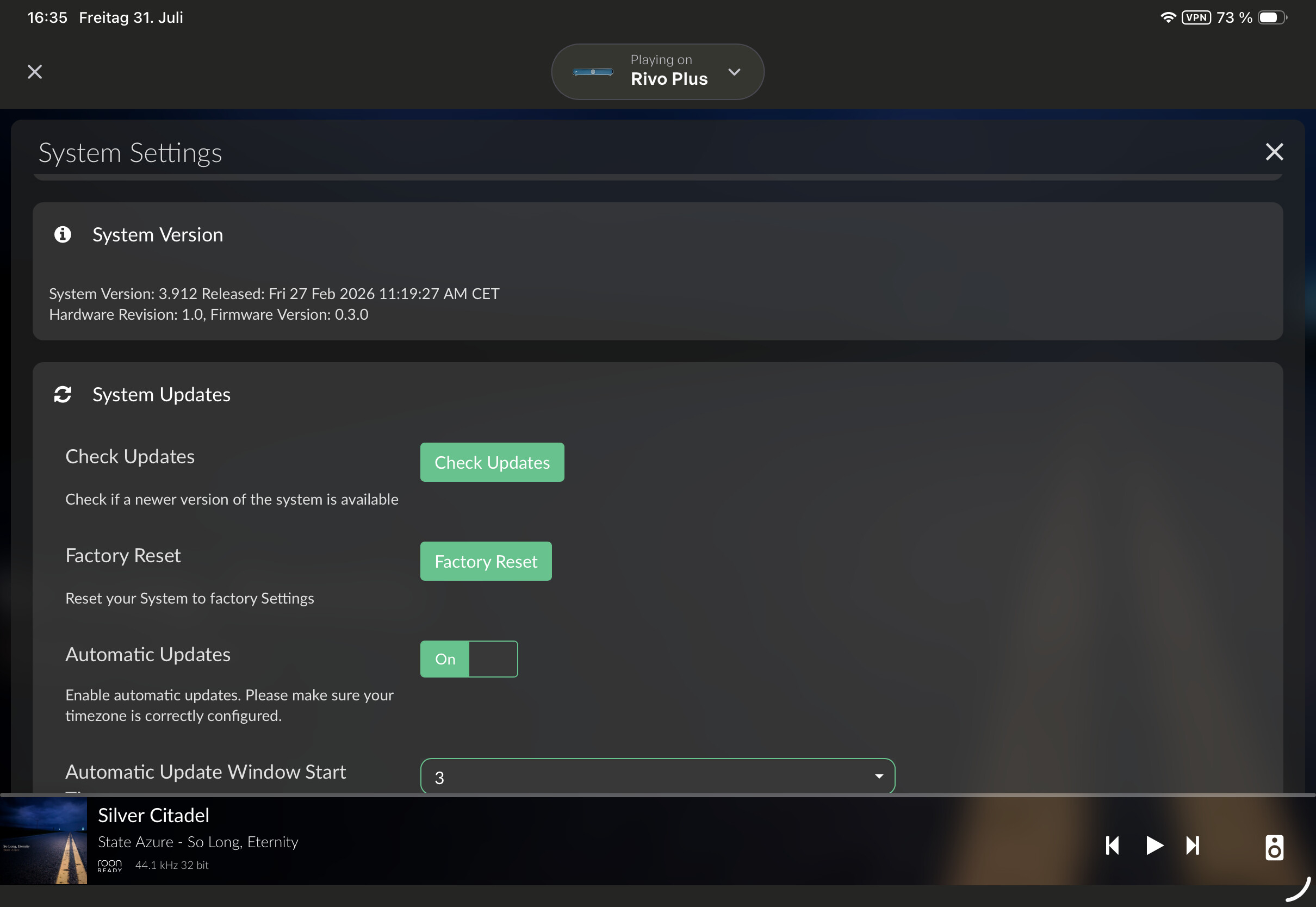

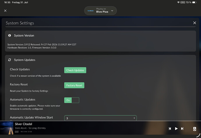

I must have missed that :slight_smile: Can’t find any test mode in the app
Torben
