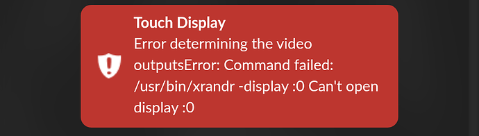

After update of Volumio I got new problems with the display.
The settings made previously are still there.
I see the QR-code at startup but if I enable the touch display plugin I get the included error. Why can’t it open the display after the update?
Log: http://logs.volumio.org/volumio/xnBcSYa.html

Hey @Frisk,
This is expected behaviour after an OTA update.
Volumio OTA updates overwrite config.txt and volumioconfig.txt with fresh defaults. Only userconfig.txt is preserved across updates. Your userconfig.txt survived - the SPI and waveshare touch overlay settings are still there. But config.txt lost the videoconfig.txt include line, and volumioconfig.txt had the KMS driver re-enabled for Pi 3. This puts you back to the same state you started with.
Pi Screen Setup has already detected this. The log shows:
pi_screen_setup: Boot validation - valid:false, drift_detected:true, missing_include:true, config_mismatch:true, volumioconfig_mismatch:true
The plugin should be showing an OTA drift warning in its settings page.
To fix this:
  1. Open the Pi Screen Setup plugin settings page in the Volumio web interface and look for the OTA drift repair option. Apply it. This will re-add the videoconfig.txt include to config.txt and correct volumioconfig.txt.
  2. After the repair, SSH in and check videoconfig.txt:
cat /boot/videoconfig.txt
If the KMS line is no longer commented out (if it reads dtoverlay=vc4-kms-v3d,cma-64 without a # in front), comment it out again:
sudo nano /boot/videoconfig.txt
Add a # at the start of the dtoverlay=vc4-kms-v3d line so it reads:
# dtoverlay=vc4-kms-v3d,cma-64
Save and exit.
  1. Reboot.
This will need to be repeated after every OTA update until a more permanent solution is in place. The core issue is that your display requires the firmware framebuffer (no KMS), but the OTA process restores KMS every time.
Regarding the MyVolumio logout issue - that is a separate matter and should be reported in its own thread or through the official support portal at Jira Service Management as it relates to account/subscription functionality.

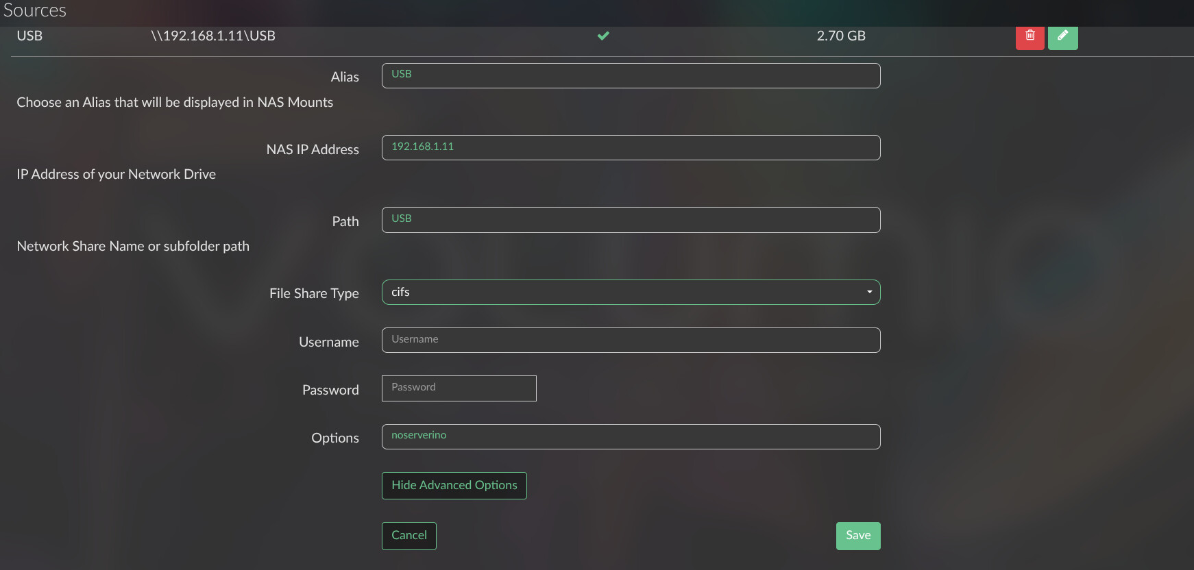

The documented workaround is to mount with “noserverino”, which makes the cifs client generate its own inode numbers locally, within 32-bit range. To try that:
  1. Go to Settings, My Music, browse to the offending source and open it for editing.
  2. In the Advanced Options field, add: noserverino
  3. Save and let the library rescan.
Then give it a couple of minutes and check whether CD_burns starts populating. If it does, problem solved. If it does not, please grab a fresh log from http://volumio.local/dev straight after the failed rescan and post the link - there is one other scenario that produces the same error message (filesystem timestamps past year 2038 getting exposed to a 32-bit time_t) and that needs a different fix, but it is the less likely of the two here given the source is a USB stick shared from another Pi rather than a large ext4 NAS volume.

Thanks @nerd I replaced “vers=2.1” with “noserverino” in the Options textbox, hope this is what you meant:
No sign of any music though. View Log
Hey @joew,
Small but important correction - you replaced the existing option with noserverino. You need to append it, not overwrite. The Options field takes a comma-separated list, so both entries have to be present at the same time.
Set the Options field to exactly this:
vers=2.1,noserverino
Save, let the library rescan, and check CD_burns again.
If it still shows nothing after that, grab a fresh log from http://volumio.local/dev and post the link so I can see what the effective mount flags ended up as and whether MPD is still throwing the same EOVERFLOW errors.
