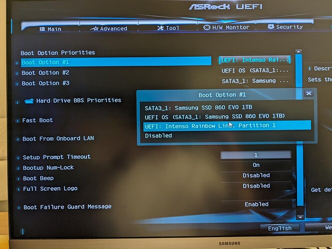

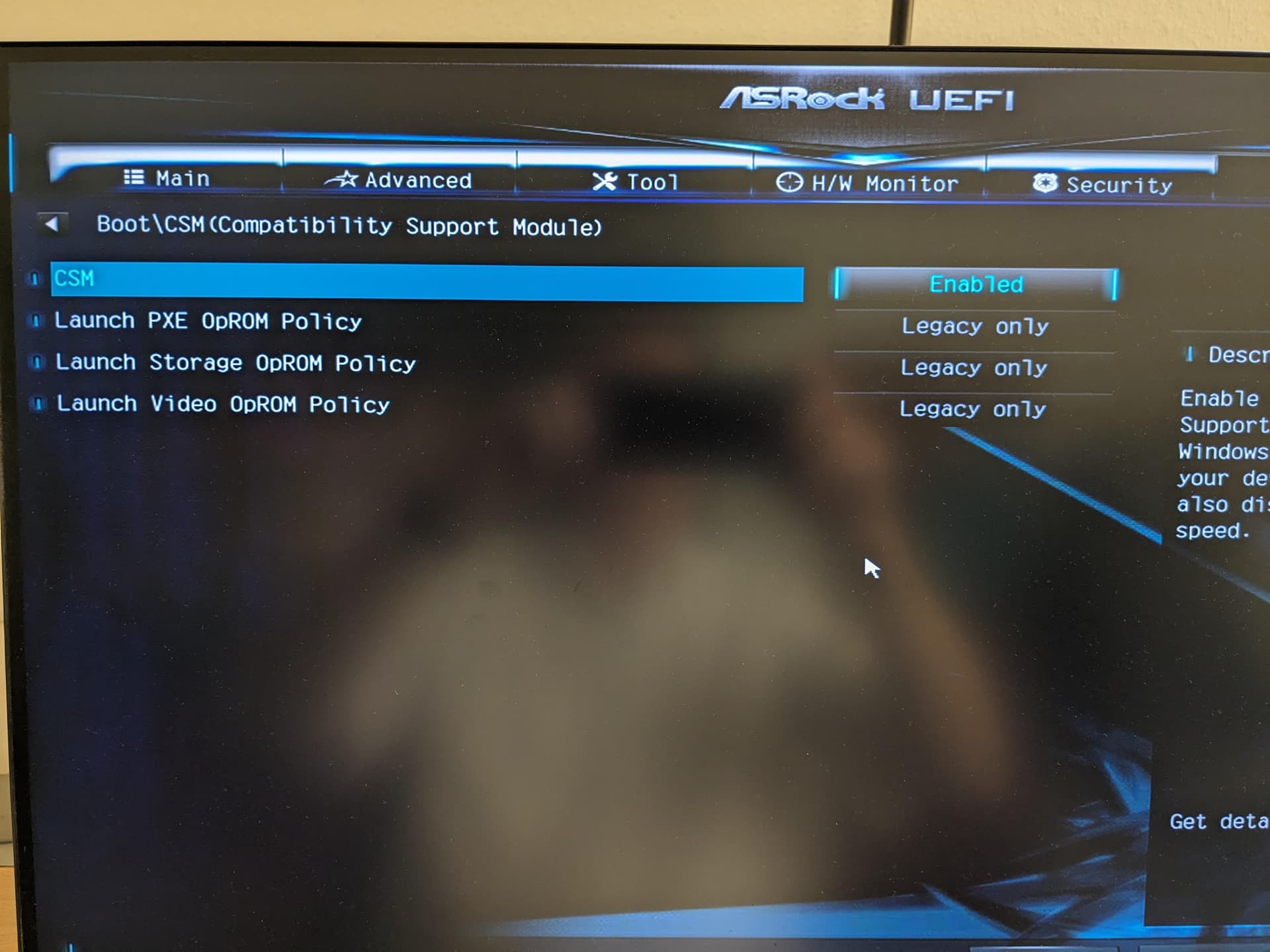

What exactly do I have to change? The BIOS seems to have only the option UEFI when I boot from USB…?
There is no (USB) legacy mode to enable?

not sure what parameters in the BIOS are to change. Please have a look at the attached screenshots.
The ā€œINTENSO RAINBOWā€¦ā€ USB Stick contains the volumio beta.
The Samsung SSD contains my regular system (3.661 at the moment, I think) as well as my music library. OTA worked over there until 3.661
It seems it’s not available. Issue has been identified and needs a fix. Can’t give an ETA.
