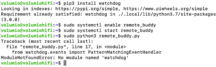

Hello. Installed according to the read.me on github. Doesn’t work. Looks like it doesn’t start watchdog. Doesn’t respond to bluetooth remote. How to fix?
sudo pip3 install watchdog

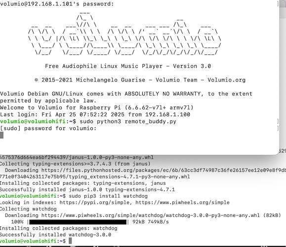

Thanx. Done but still do not work. Start? and hang? and no reaction on bluetooth remote. What next?
Screenshot 2025-04-25 at 07.57.38
Please read installation instruction in Github. I wrote both about watchdog and the fact, that this script is intended to run as service only and not as standalone program

Thank you. I followed the instructions in the readme:
sudo apt install python3-pip
sudo apt install python3-evdev
sudo apt install python3-pyudev
sudo pip3 install janus
(copy remote_buddy) by Samba
cd remote_buddy
sudo cp remote_buddy.py /home/volumio/
chmod +x remote_buddy.py (and get info and set 755 in Transmit)
sudo cp remote_buddy.service /lib/systemd/system/remote_buddy.service
sudo systemctl enable remote_buddy
sudo systemctl start remote_buddy
sudo python3 remote_buddy.py
Not working
