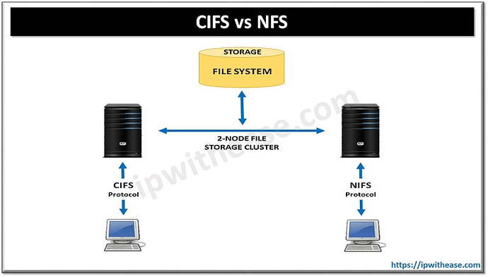

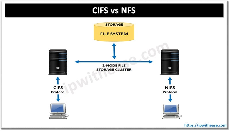

Here you find some explanation between the 2:
It will not impact the sound quality, bits are bits. Unless you have a weak connection than NFS has less overhead and would be advised.
