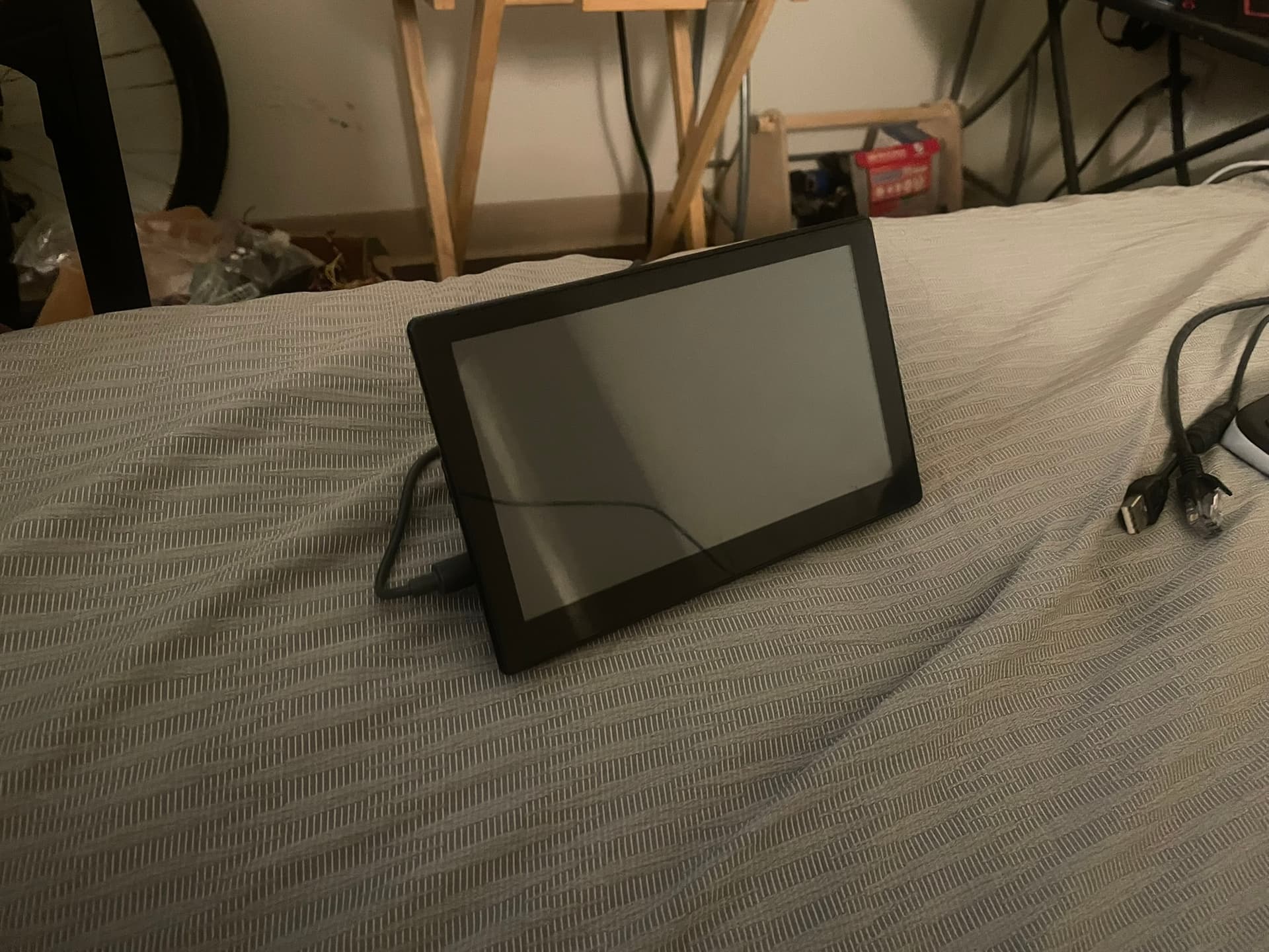

touch screen is a 7 inch by UPERFECT, if I upload one album it shows it as 9 albums even its a single album
