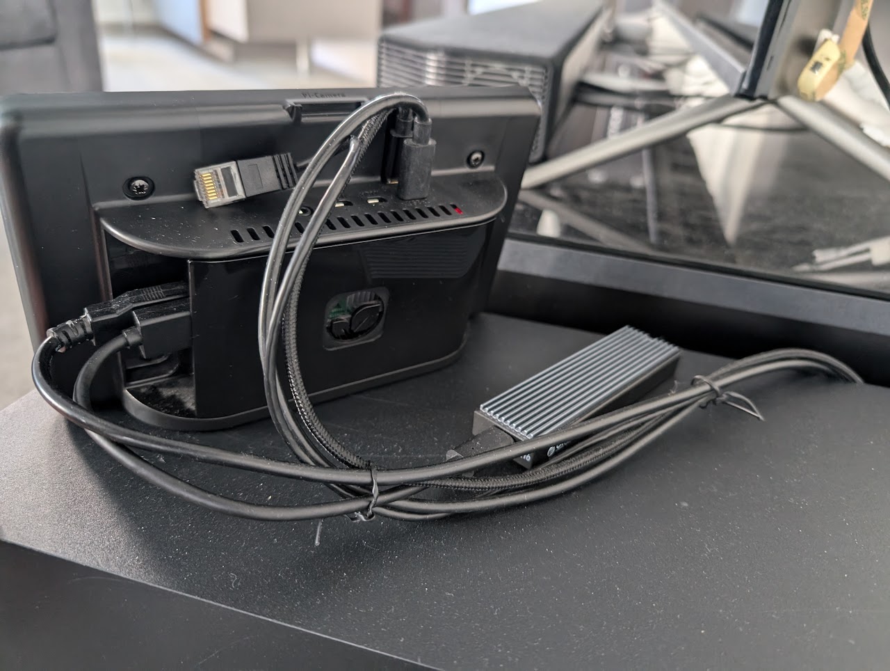

Make sure that every connection on your rPi4 is solid, especially those on the GPIO. For that reason I have put a metal cover to the back. This one is rock solid and used for testing.

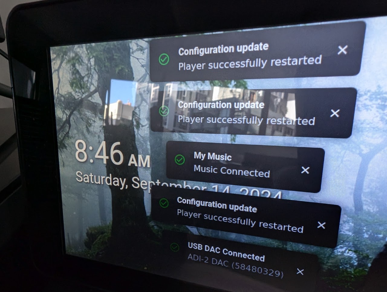

That a solid looking case, I really wish the Pi cases were better but can’t do much with them. Maybe i need to clamp the terminals a bit more, doesn’t matter which cable i touch seems to upset it, not sure if i can improve it. Just get a all these messages going off…

This looks indeed like poor connections, or power issues. As your connected device holding music comes up when Volumio has started. Same for your DAC. That’s the reason you see the “Restarted” messages.

Yeah I accidentally unplugged the USB to the m.2 at the same time when I was jiggling the cables.
