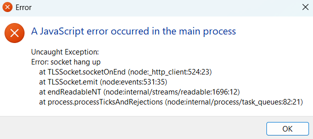

Today I am using Tidal Connect exclusively through the laptop’s Tidal app and I still keep getting errors.
http://logs.volumio.org/rivoplus/Srt0Dpw.html
