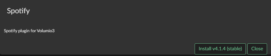

didn’t work for me, but i think the new plugin is not loading. I deleted the old one and installed the new one but reverts back to 4.1.4. if you click details it says 4.1.4 and not the 4.2.2.

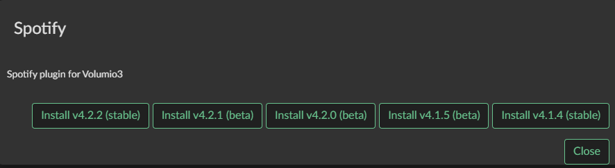

Spotify Installation Instructions
  1. Uninstall Spotify from the device
  2. Reboot the device
  3. Install Spotify version 4.2.2
  4. Reboot again
After completing these steps, the device should appear in the Connect list within your Spotify app.
This process has been validated on three different devices
