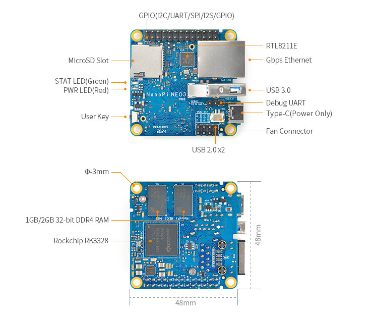

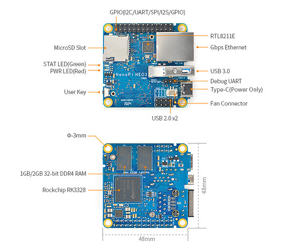

Wheaton, I know very little about Linux and Pi devices but on Headfi it was stated that instead of Raspberry Pi CM4 the N100 runs on NanoPi NEO3. Does this change the method to fix the date synchronization? Is there a way to apply a date fix when the ssh connection to the N100 is asking for a password?

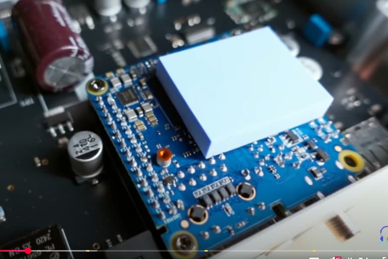

That will be interesting to see in action. Since nothing detailed has been published, it would be very helpful to have a high-resolution PCB photo once you get the unit, as there is currently nothing available on the internet. Knowing the board layout and the processor used might shed light on how SMSL have implemented Volumio. Perhaps a separate thread like “Mystery box tear-down” would encourage owners to contribute.

We need hard evidence of the SBC to see it, hearsay is not going to cut it. Please take a detailed photos of the board(s), processor, etc.

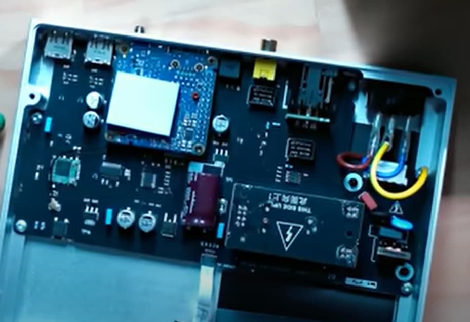

Here is a sort of inside view, not very helpfull I am afraid.

It is a resemblance of NanoPi_NEO3 PCB, however we need to see the CPU chip or both sides of the PCB without the thermal pads.
