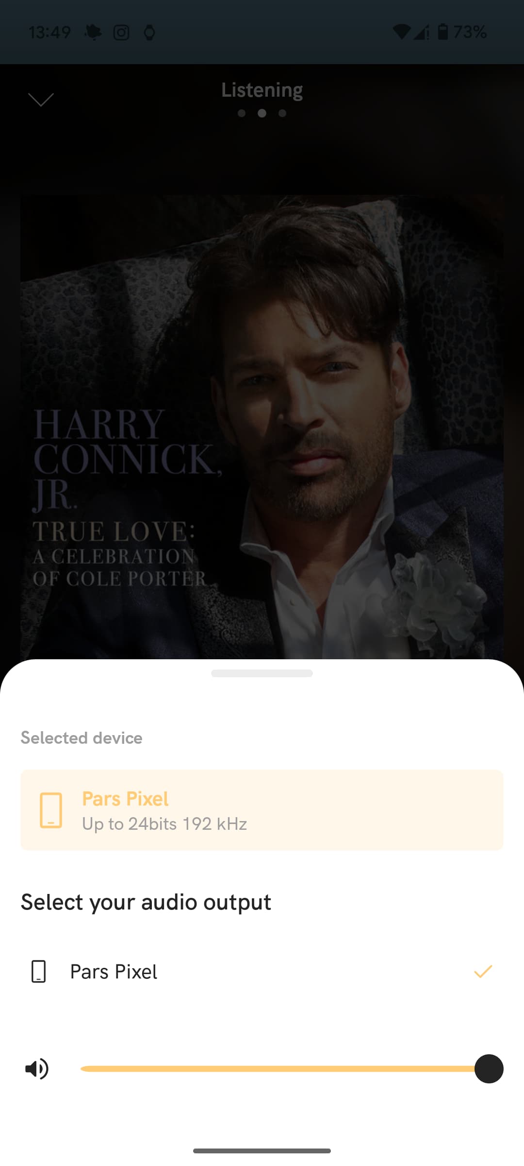

Qobuz connect works just fine with my Mac/Windows laptops; however, the Software on Mixer Type does not work. I can slide the volume adjustment bar on both Volumio and Qobuz app but doesn’t do any good.

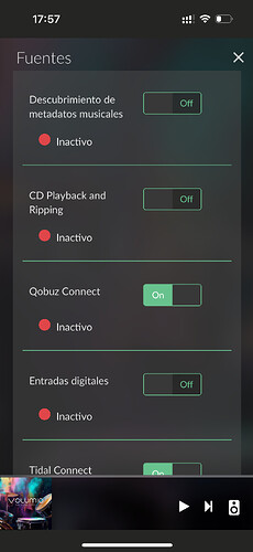

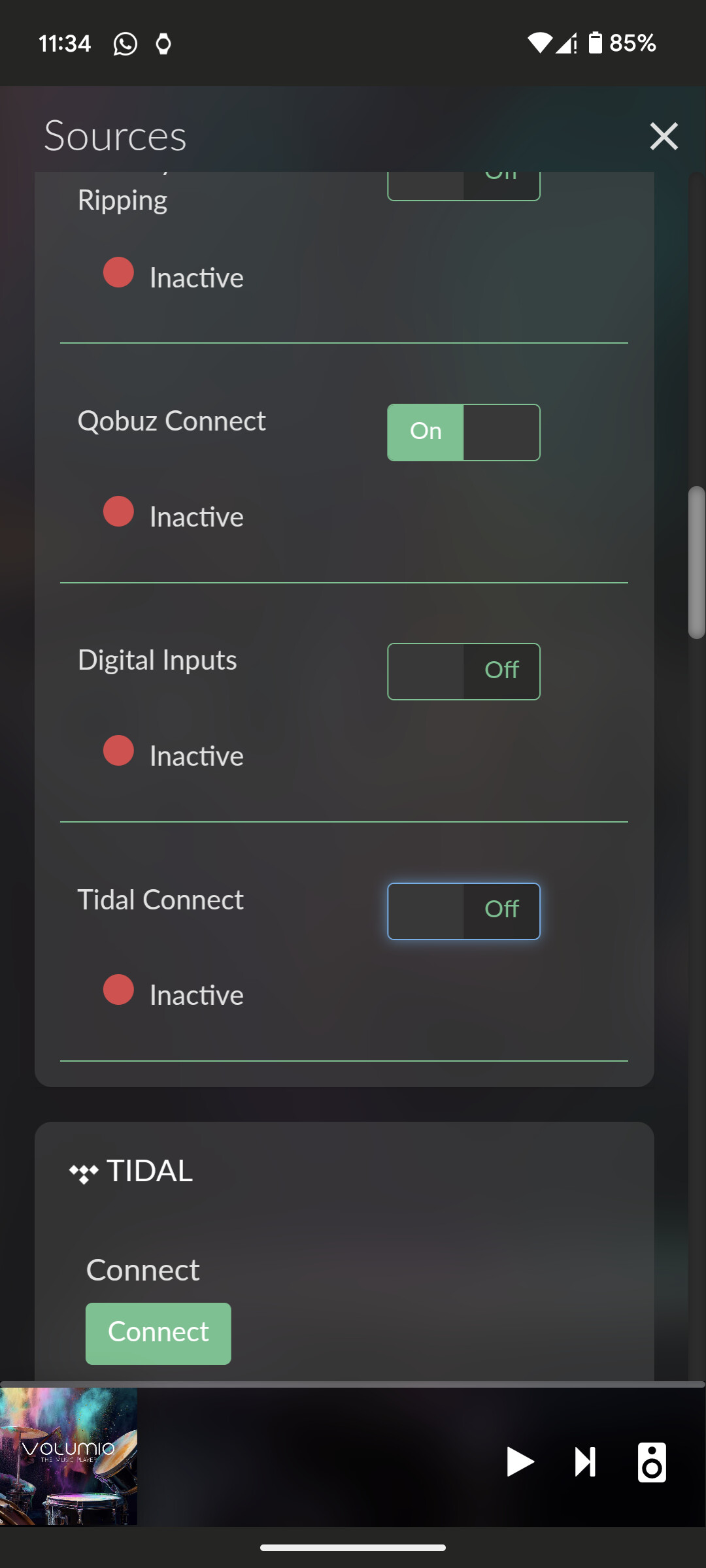

Hello Volumio team, I upgraded to Premium from Virtuoso just to enable Qobuz Connect but although I can turn it ON now it doesn’t activate. I can activate Tidal or other features but although it shows ON, Qobuz Connect stays inactive. I logged out, in, restart, nearly did everything.
I use PecanPi DAC+
RPi 5
Volumio 3.807
What can be the problem?
Thanks in advance

Ok, beta Qobuz works fine but only plays HiRes songs, maybe to thats the reason of Beta testing. Anyone know if this is a Qobuz Connect issue or an setting? From Volumio Menu it’s possible to play low Res songs.

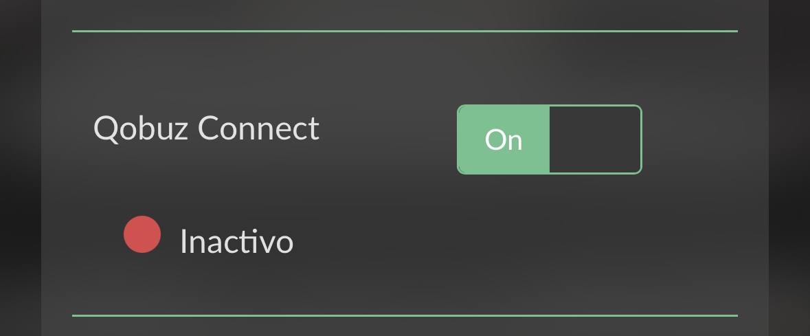

Hi!
Qobuz doesn’t detect my Volumio and Qobuz Connect is turned on but it’s seems inactive…
Please can you give me some light?

I just installed the beta app but it’s still not working. Pretty sure this is a volumio issue and not Qobuz’s.
As I said, in my Volumio Qobuz connect is turned on but it seems
Inactive.

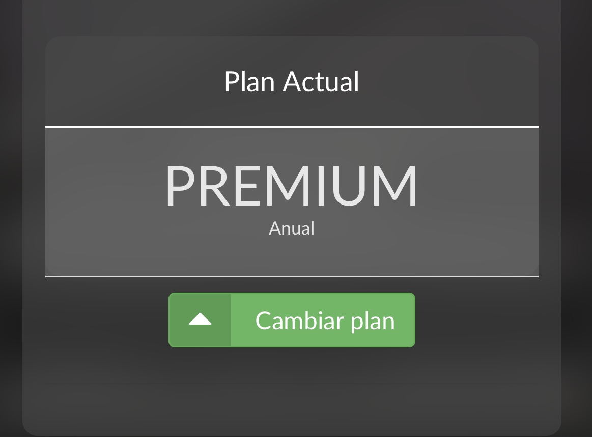

Do you have a superstar or premium account, as in your screenshot all premium features are disabled?
If yes, is your account properly activated?
I’m a premium subscriber.
