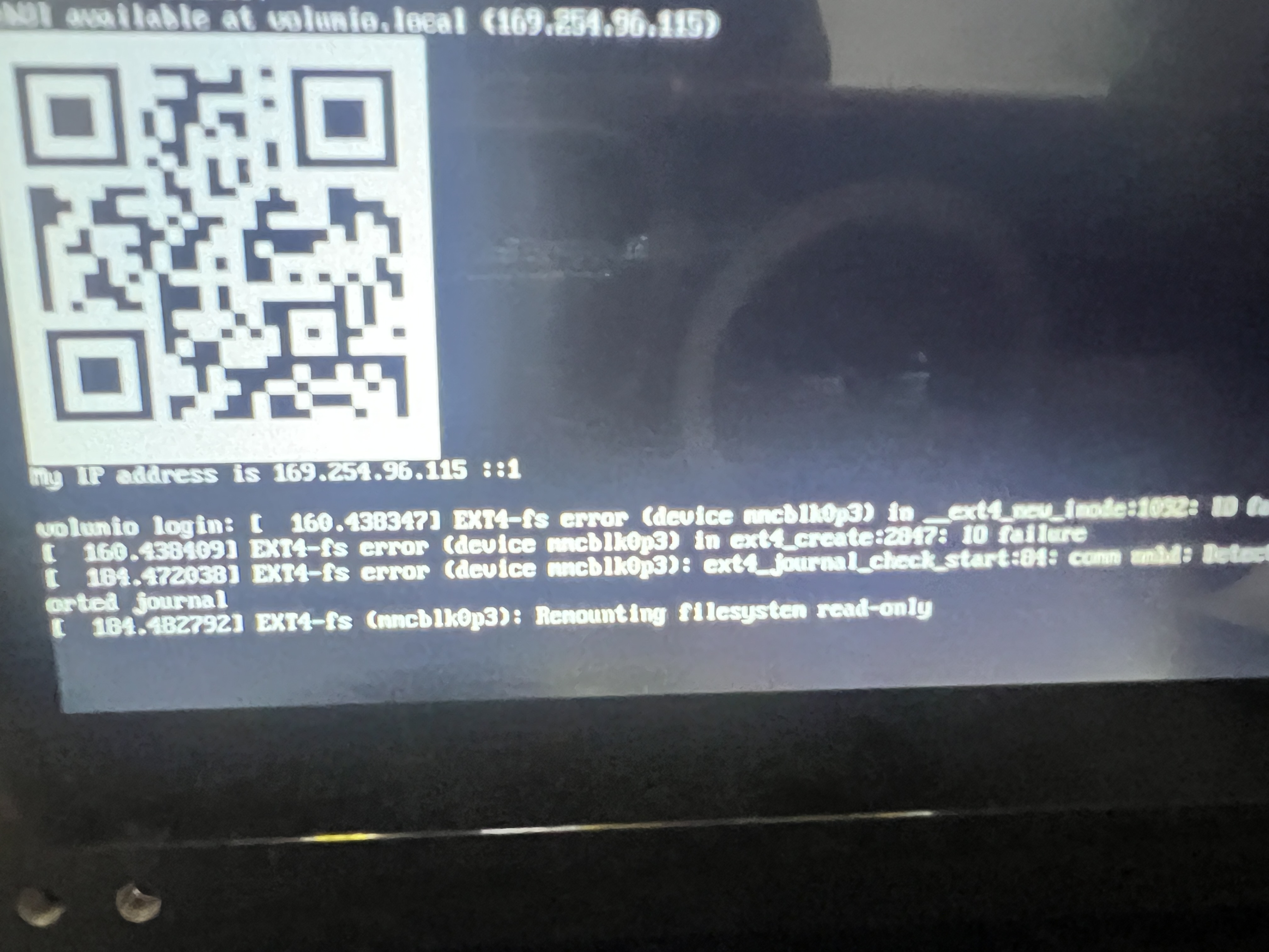

Hello ,
I have a strange issue with my RPI . In the router I have set a static IP adress.
I have flashed V4.010 but it get the 169.254.96.115. When I scan the QR code , the WEB UI page is not oppen it so I have conenct to the Volumio Hotspot and I have assigned the same IP address that it is in the router for this RPI. I have rebooted the RPI and it has the same IP adress 169.254.96.115. With the v3.812 I have disabled also the Wifi but still can not access the WEb UI ,
the connection to Volumio sudenly stopped yestarday .
Since I have assigned a static IP adress In the router after flashing the volumio OS, the same Ip adress was assigned as wriiten in I have also this error
Thanks for support
It seems your SD is having errors, see ext4 issue on your picture.
Reflash it or an other SD.
@balbuze I have flashed another sd card , connected to the hotspot , perform the steps and reboot but again the Ip adresa is 169.254.96.115 … after the configuration o should disable the hotspot or wireless confit ? It appears that the Ip addressed is not saved .
I have reboot the switch which is connected the rpi and now is fine .
