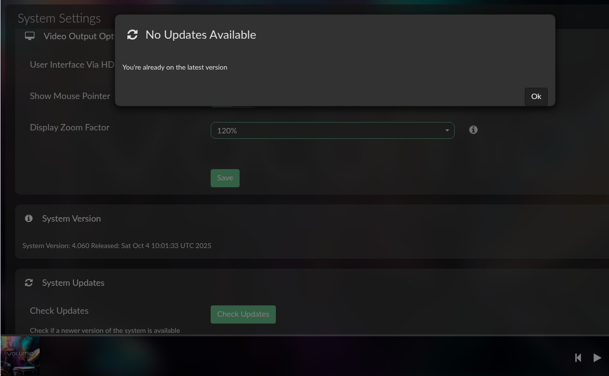

a 3rd system. like I told yesterday, I ran the update to V4.061, during reboot I saw the update to V4.061, after booting V4.060.
Web display incorrect

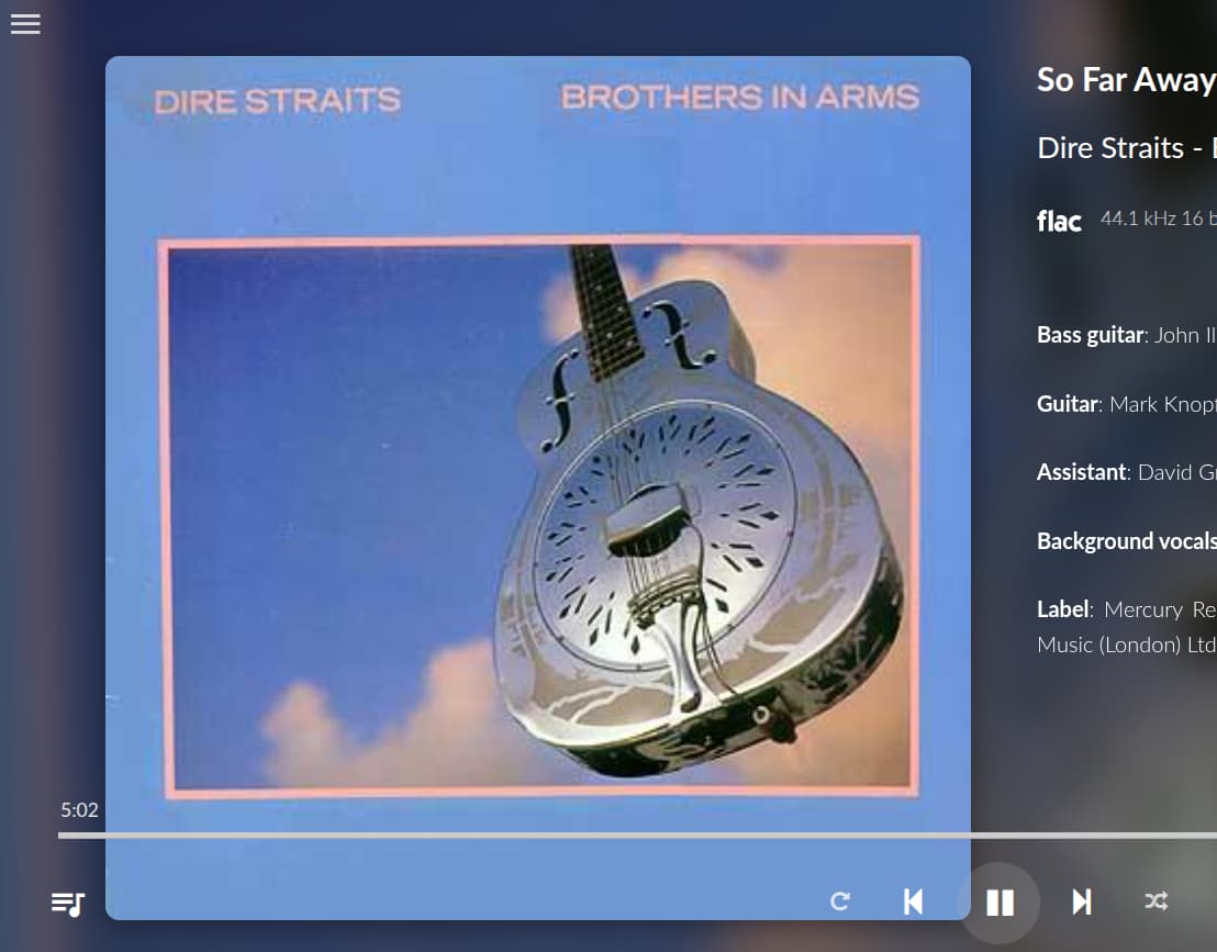

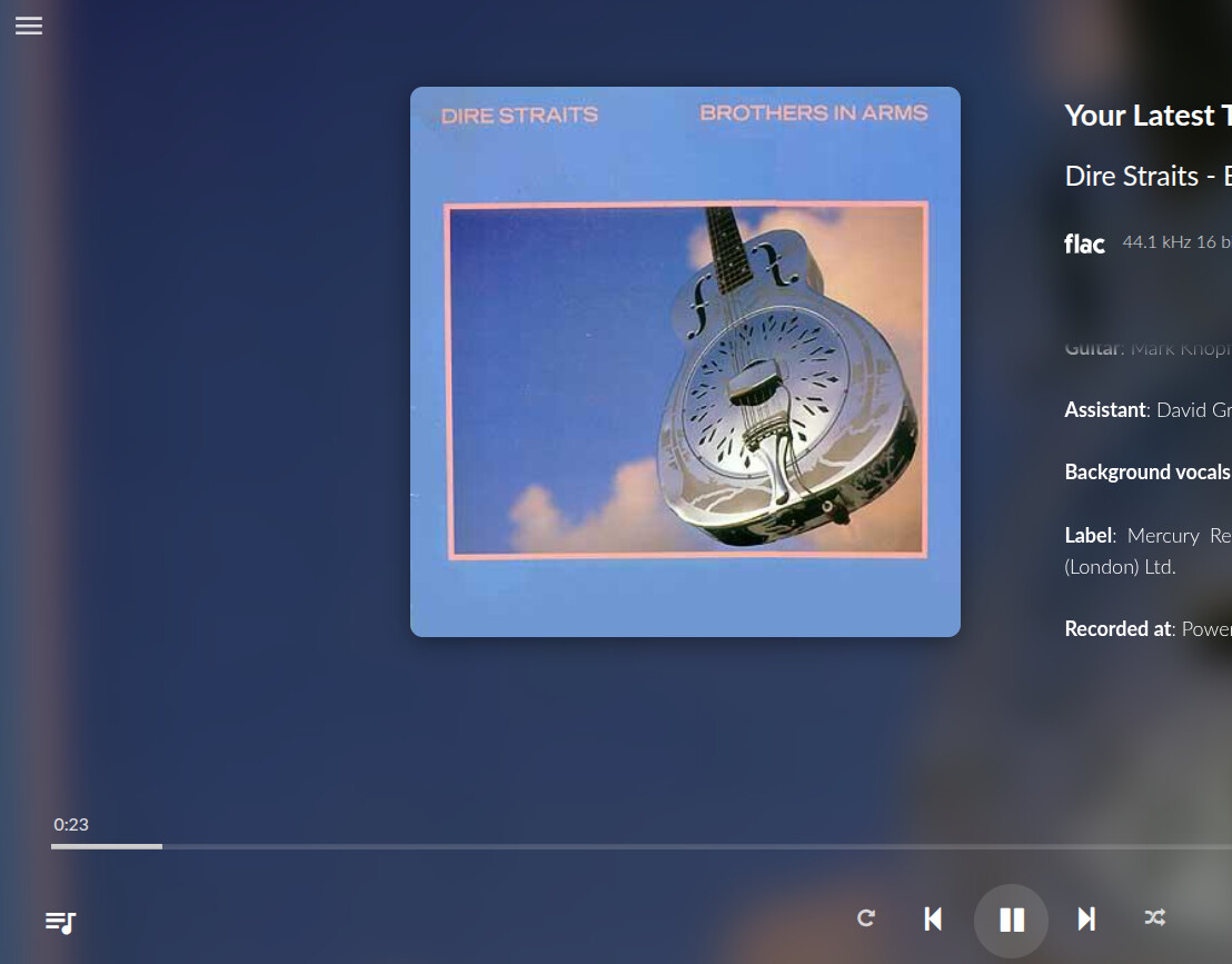

I discovered a problem with the web-display:
My laptop display has a resolution of 1920x1080, and I use Google Chrome on my computer.
When displayed at 100%, the album cover is much too large.
If I set Chrome to 90% zoom or less, it’s either better or too small.
This has only been the case since 4.062; everything was fine before that.
The display on my phone (Google Pixel 7a) with the Volumio app is wonderful.
Log:
http://logs.volumio.org/volumio/ochlkju.html

Hey @rost21A,
Thank you for the detailed report, screenshots, and log. Everything in your setup updated cleanly to 4.062, but your log repeatedly shows the following system-level warning:
hwmon hwmon1: Undervoltage detected!
This means the Raspberry Pi is not receiving a stable 5V supply. When this happens, the CPU and GPU are automatically throttled, and graphical operations (including web rendering) may behave unpredictably. Before looking at a possible UI regression, we need to rule out the power issue.
Please do the following:
  1. Reboot your Pi with a verified 5V/3A (or stronger) power supply and a short, thick cable. Disconnect any nonessential USB devices.
  2. After boot, check if the undervoltage messages disappear from the system log.
  3. Then open Chrome in Incognito mode (no extensions, 100% zoom) and test the Now Playing screen again.
  4. If the problem persists, please open the Developer Console (F12) and share the output of these three values:
    • window.innerWidth
    • window.innerHeight
    • window.devicePixelRatio
  5. Finally, try narrowing the browser window until the right-side track panel collapses and see if the artwork scales differently.
Once we have these results under stable power, we can confirm whether this is a frontend layout regression or a side effect of throttling.

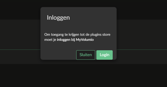

Flashed 4.060.
OTA: 4.061 > 4.062 Everything went well, wired internet.
The only problem was logging in; popup kept appearing in the plugin store. A reboot fixed this, but unfortunately, I didn’t create a log.
Otherwise, everything works fine, and the sound is nice.

Hello @Nerd
Thank you for your advice, which I followed except for the Developer Console (F12). I don’t have a monitor connected.
I used a genuine RPI power supply, and now there’s no undervoltage message in the log. http://logs.volumio.org/volumio/qkCS3Ec.html
The error still persists. However, I discovered that scaling the system to 125% (laptop with Ubuntu 25.10) triggers the error. Scaling to 100% doesn’t cause the error.
With Firefox, the error doesn’t occur even at 100%, despite scaling to 125%.
If I disable fractional scaling in my notebook’s display settings, the error also goes away.
So this isn’t a new issue with Volumio, but probably a new configuration of my laptop’s system, which I recently updated.
I apologize for my misjudgment.
