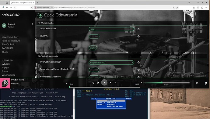

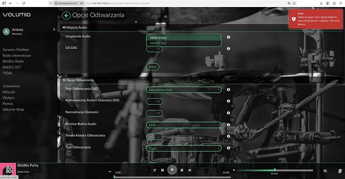

Guys, I don’t know what is happening but 4.30 cannot detect my XMOS DAC. 4.29 works OK. It does not show at all.
@nerd
Problem with correct USB DAC detection in Volumio 4.030
Raspberry Pi 5 - 2 GB - Volumio 4.030 - USB DAC Khadas Tone 2 Marker Kit not working.
Volumio - 4.029 Khadas Tone 2 Marker Kit working ok.
Volumio - 3.832 Khadas Tone 2 Marker Kit working ok

  • Board info
  • Manufacturer:
  • Model: Raspberry Pi Compute Module 5 Lite Rev 1.0
  • Version: d041a0
  • Firmware Version: 2025/05/08 15:13:17 Copyright (c) 2012 Broadcom
    • Brand: BCM2712
  • Speed: 1.5 GHz
  • Family: Cortex-A76
  • Model: 1
  • Number of cores: 4
  • Physical cores: 4
  • Average load: 25%
  • Temperature: 46°C
We got caught in the middle of a Raspberry Pi kernel and firmware re-base. This is not the first time it happened, and it caused version mismatches between kernel modules and core symbols. You may see errors like these in your logs:
[Sat Oct  4 12:50:01 2025] snd_usb_audio: disagrees about version of symbol _printk
[Sat Oct  4 12:50:01 2025] snd_usb_audio: Unknown symbol _printk (err -22)
[Sat Oct  4 12:50:01 2025] snd_usb_audio: disagrees about version of symbol _dev_info
[Sat Oct  4 12:50:01 2025] snd_usb_audio: Unknown symbol _dev_info (err -22)
[Sat Oct  4 12:50:01 2025] snd_usb_audio: disagrees about version of symbol _dev_err
[Sat Oct  4 12:50:01 2025] snd_usb_audio: Unknown symbol _dev_err (err -22)
[Sat Oct  4 12:50:01 2025] snd_usb_audio: disagrees about version of symbol _dev_warn
[Sat Oct  4 12:50:01 2025] snd_usb_audio: Unknown symbol _dev_warn (err -22)
This indicates that the kernel and the modules were built against different base revisions of the Raspberry Pi source tree.
I will issue a kernel downgrade build to the last known stable version, 6.12.47, to restore full module compatibility. The re-base will be reintroduced later when upstream stabilizes the matching firmware set.
