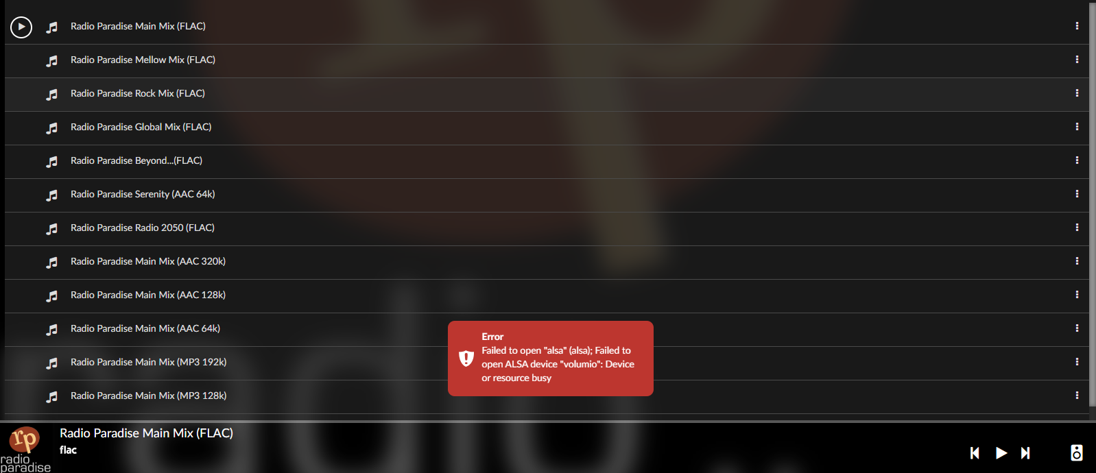

first flash, v4.022, all okay.
raspberry pi 5 Model B Rev 1.0, (4 gb)
dac: DDDac MK2 4 deck and fifoPiQ7ll.
driver: generic i2s DAC.
installed plugins:
radio paradise, v2.0.16
squeezelite MC v2.0.0.
youtube2, v2.3.3.
system information, v3.010.

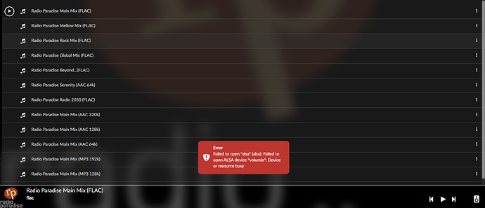

only failed to open alsa when I press play from Squeezelite MC to Radio Paradise.
So I have to press stop first and then play again to restart the stream.
system log: http://logs.volumio.org/volumio/rsnYmPs.html

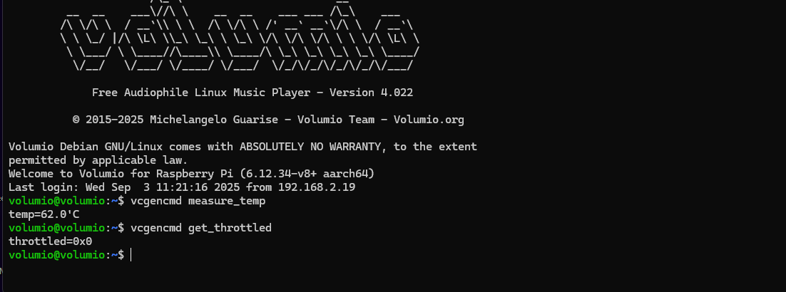

Hi all,
I’m not sure if this has already been discussed, but I’ve noticed that my Raspberry PI5 (Model B Rev 1.0) gets significantly hotter than it does with version 3.832 (85 vs 67°C). If it helps or is necessary, I’m happy to provide detailed system information and log reports. I have compared with V4.021

Hey @michel8166,
Thanks for the detailed report and the log. The symptom matches a straight device-arbitration issue: MPD and Squeezelite are trying to open the same ALSA device at the same time. In your log MPD fails with:
  • Failed to open ALSA device “volumio”: Device or resource busy
  • problems opening audio device while playing https://stream.radioparadise.com/flacm
    And the process list shows Squeezelite running when this happens:
  • /opt/squeezelite/squeezelite -o squeezelite -C 1
    This is why pressing Stop first and then Play works: it releases the handle and MPD can grab it.
What to change

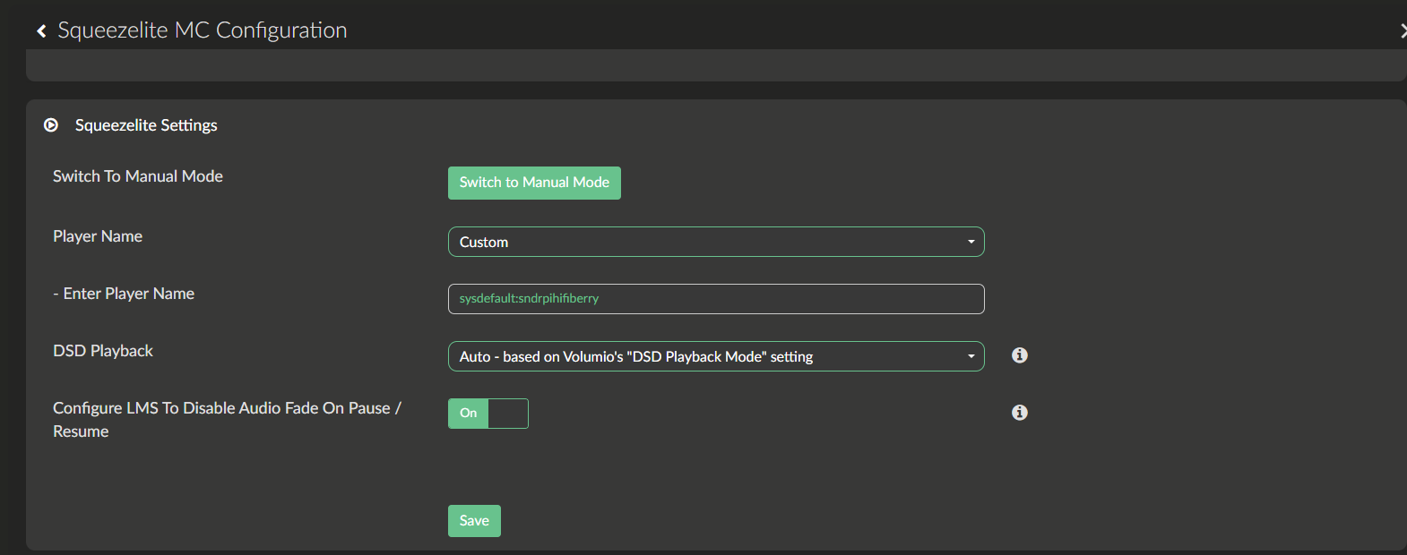

  1. Make Squeezelite let go more reliably
  • In the Squeezelite MC settings, set Close output when idle to 1 or 2 seconds and enable options to close output on Stop and on Pause if available. Your instance already runs with -C 1, but the explicit close-on-stop option prevents brief races when switching sources fast. Then switch away by powering off the Squeezelite player in LMS or pressing Stop before starting Radio Paradise.
  1. Avoid the shared alias
  • Your /etc/asound.conf points the default and the name volumio to the I2S DAC. Squeezelite is opening the same target via its -o squeezelite setting, which maps to the same ALSA path in this config. Change Squeezelite MC Output device to hw:sndrpihifiberry,front:CARD=sndrpihifiberry,DEV=0 or sysdefault:sndrpihifiberry so it does not use the volumio alias. This reduces chances of both stacks chasing the same named device at the same instant.
  1. One engine at a time
  • If you mainly use Radio Paradise through Volumio, set Squeezelite MC to not autostart at boot, or temporarily disable the plugin when you are not using LMS. That guarantees MPD owns the DAC and removes the race entirely.
  1. Ignore the mixer warning
  • The HifiBerry DAC has no PCM mixer control, so the MPD log line “no such mixer control: PCM” is expected and harmless. It is unrelated to the busy error.
If the busy popup still appears after trying the above, please:
  • Reproduce once more and share a fresh log link.
  • Also copy the current Squeezelite MC settings, especially Output device and any close-on-stop options.
This is not a core Volumio bug but a plugin arbitration issue: the plugins are not coordinating ALSA device hand-off. The Pi5 hardware, I²S FIFO DAC, and kernel are fine; it is purely an ownership conflict between MPD and squeezelite.
So the right place to follow this up is in the plugin compatibility thread rather than the core system beta one:
Plugin Compatibility for Volumio on Bookworm
Hey @Axel,
To compare temperatures between 3.832 and 4.021 properly, we need to line up all factors. Please share your full setup, since differences in hardware or plugins can influence results:
  • Pi5 model and memory size (4 GB or 8 GB)
  • Cooling solution (official active cooler, passive heatsink, fanless, etc.)
  • Power supply type and rating
  • Storage medium (microSD, USB SSD, NVMe)
  • Connected DAC or HAT (I2S, USB DAC, HDMI)
  • Other peripherals (USB hubs, dongles, displays, etc.)
  • List of installed plugins and which ones are enabled
  • Any changes in config.txt, userconfig.txt, overlays
That way we can rule out differences like NVMe drawing more power than microSD, or plugins keeping CPU busy.
For the actual test, could you try the following steps on both versions (3.832 and 4.021) so we get quantifiable data:
  1. From a cold boot, let the system idle for 5 minutes. Record:
    • vcgencmd measure_temp
    • vcgencmd get_throttled
    • cat /sys/devices/system/cpu/cpu*/cpufreq/scaling_governor
    • Log link from http://<volumioIP>/dev
  2. Start playback of the same audio file/stream using the same DAC/output. After 10 minutes of continuous playback, record the same values again.
With identical conditions, we can see if the temperature rise is due to kernel, firmware, or workload differences.
Okay, I changed the name. Now internet radio and Squeelite MC play fine with pause/play next, but not with Radio Paradise.
See Squeelite MC settings.
I think the best option is to simply stop and then play again, or disable it when one of the two is not in use.
log: http://logs.volumio.org/volumio/kgZOzWg.html

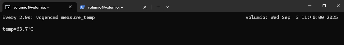

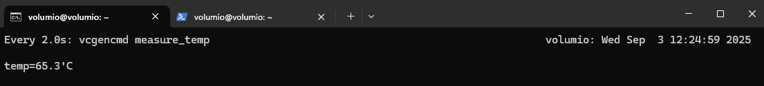

@nerd @Axel For the temperature: system v4.022.
Fluctuates between 61.5 and 63.7 degrees Celsius when it’s running.
When nothing is running (same)
Pi5 Model B Rev1 memory size (4 GB)
Cooling solution (passive heatsink)
Power supply: Ian Canada LiniaerPi MK2, 5 volts 2.5 amps
Storage medium (no storage)
Connected DAC or HAT (I2S Dddac mk2)
Other peripherals (USB, nothing)
Changes in config.txt, userconfig.txt, overlays (no changes)
List of installed plugins:
youtube2, v2.3.3.
I’ll let it run for another half hour and post the temperature again.
Second measurement: System online for 1 hour and 20 minutes, and the temperature rises slightly.
This seems logical to me because I built everything in a closed box.
now max 65.3 Celsius.
