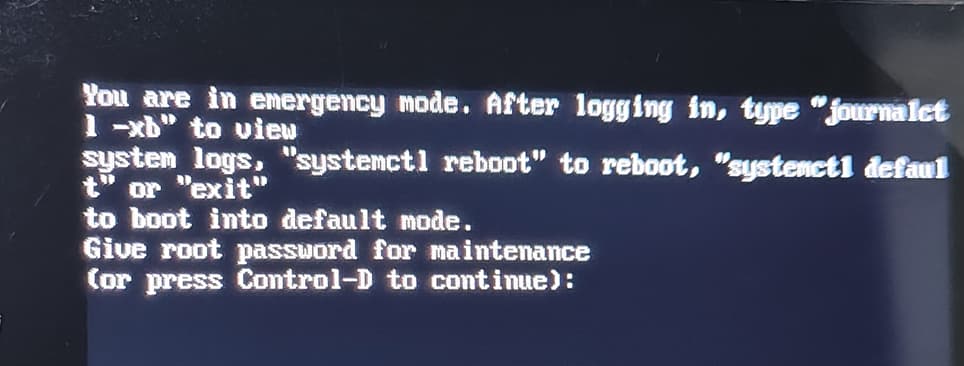

Hey @Raw ,
Thanks for continuing to test and report. However, I kindly ask that you do not rewrite or reword your previous posts multiple times during a debugging session. It makes it very difficult for us to track what changed between tests, what is working, and which specific conditions caused new failures.
We rely on precise and consistent data at the time of testing, especially when confirming regressions like those in version 4.020. Rewriting the same post with edits (especially after results or screenshots change) invalidates earlier analysis and wastes time during reproduction efforts.
From your latest message and the attached screen showing emergency mode on boot:
  • It appears that renaming your SSD label to issd may have triggered Volumio’s automount to /mnt/INTERNAL
  • But this automount likely clashed with your prior symlink or fstab override, resulting in boot failure
Please do the following in future posts:
  1. Do not edit previous posts with new results. Post a follow-up reply with exact logs or outcomes.
  2. Include one test case per reply, with:
    • Mount method
    • Label used
    • Was it OTA or fresh image
    • What plugins are installed
    • When the issue occurs (initial boot, after power-off, etc.)
  3. Always upload new logs or screenshots only after each test, not as retroactive edits.
That way we can isolate regressions and give clear help without backtracking.
Hey @Raw ,
The screen confirms that Volumio has dropped to emergency mode, which typically happens when a critical service or filesystem fails to mount during early boot. Based on your description, the most likely cause is the label-based automount attempt using:
LABEL=issd /mnt/NVME ext4 ...
If the NVMe drive is:
  • Missing
  • Mislabelled (label must match exactly, case-sensitive)
  • Or the filesystem is unclean or corrupt
Then systemd will treat this as a boot-critical failure and enter emergency mode unless the nofail option is present in /etc/fstab.
To find the exact cause, inside emergency mode, type:
journalctl -xb | grep -i "fail"
You’re looking for lines like:
  • Failed to mount /mnt/NVME
  • Dependency failed for Local File Systems
  • Timed out waiting for device labeled 'issd'
Also verify:
lsblk -f
blkid
cat /etc/fstab
ls -l /var/lib/mpd/music
This will help confirm whether:
  • The NVMe was detected
  • Its label matches issd
  • The fstab line caused the system to halt
  • A broken symlink is pointing to a non-mounted target
In general, we recommend avoiding manual fstab edits unless absolutely necessary. Volumio’s automount system expects internal drives with labels like issd to be mounted dynamically. If you still require persistent manual mounts, always include nofail to avoid emergency mode.
Please post the output of the above steps so we can confirm and help recover or rebuild cleanly.

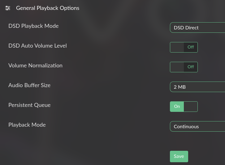

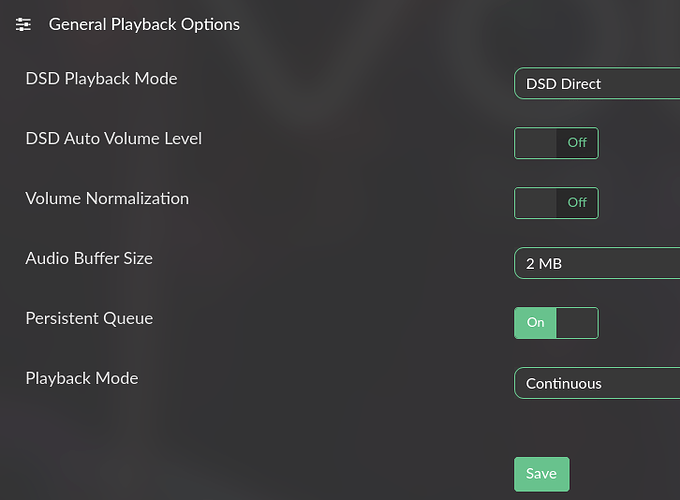

In v4.xxx, persistent queue is not working.
Each reboot, Volumio starts with an empty playback page, but the queue is full
http://logs.volumio.org/volumio/vtGOZ51.html
edit : V4.0.20 On x86 (higole) samba share was not started
edit: the issue comes from BT enabled in sources! Disabling it fix the issue.

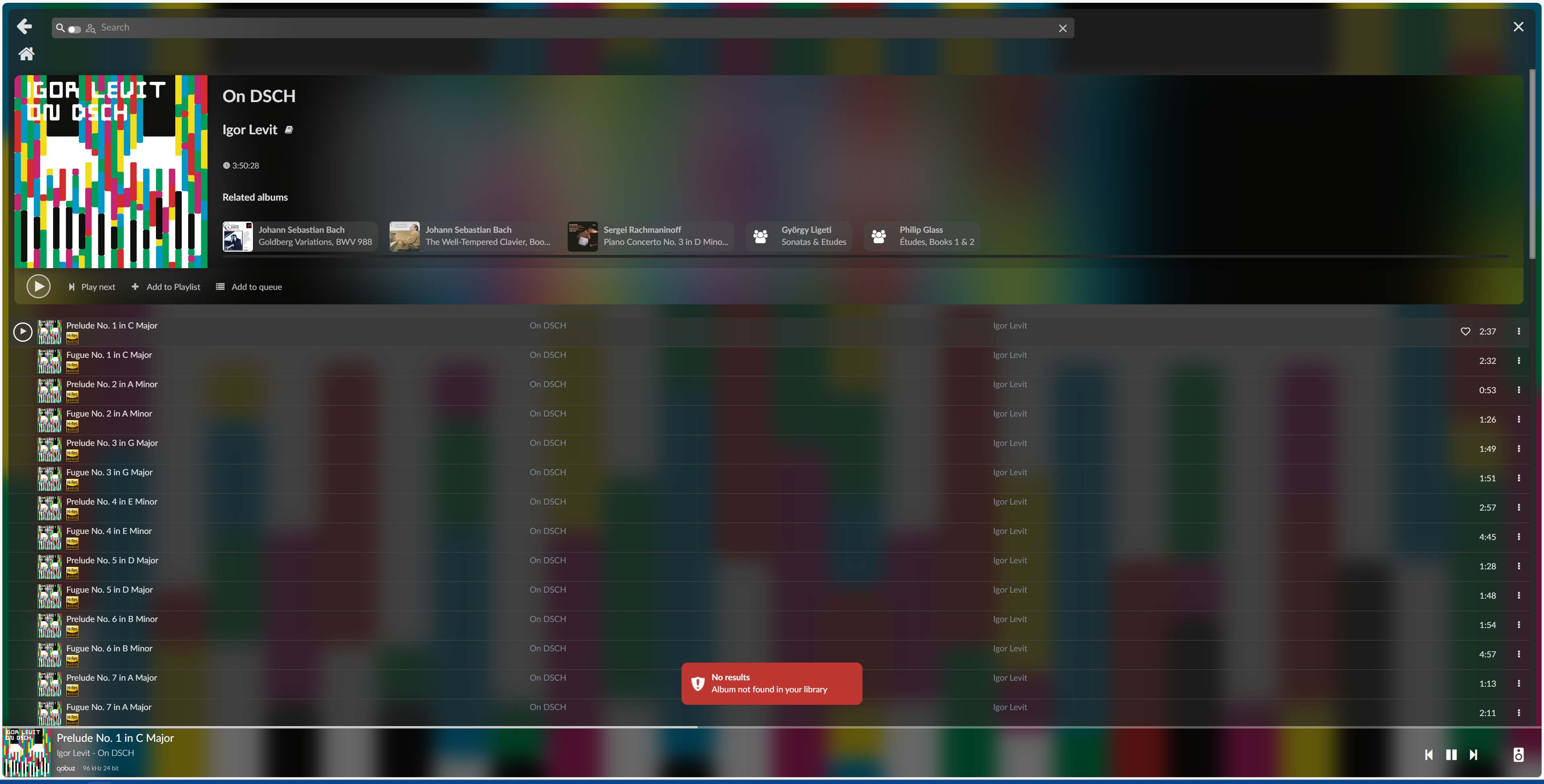

I have investigated the behaviour of the suggestions a bit more and found that they choke when the suggestion originates from my library (which sits on the NAS and has lastname, firstname artist format.
When the suggestions go from a qobuz album to a qobuz album (both firstname lastname artist format), they seem to work.
It would be great if the suggestion engine could go seamlessly between DLNA NAS, local storage and streaming services and between firstname lastname and lastname, firstname artist formats. But I am not holding my breath for that, given that UPnP search for MinimServer has not been implemented yet.
Some thought is needed how to not present suggestions that end up in a cul-de-sac and present an error.
