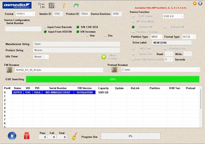

First enclosure that works out of the box (at least seems to so far):
RaidSonic IB-377-C31 ASM235CM
Ven=174c, PID=55aa
This is the dsmeg result:
volumio@volumio:~$ dmesg | grep -i usb
[    0.062273] usbcore: registered new interface driver usbfs
[    0.062302] usbcore: registered new interface driver hub
[    0.062327] usbcore: registered new device driver usb
[    1.854179] usbcore: registered new interface driver lan78xx
[    1.854214] usbcore: registered new interface driver smsc95xx
[    1.855534] xhci_hcd 0000:01:00.0: new USB bus registered, assigned bus number 1
[    1.857741] xhci_hcd 0000:01:00.0: new USB bus registered, assigned bus number 2
[    1.857751] xhci_hcd 0000:01:00.0: Host supports USB 3.0 SuperSpeed
[    1.857885] usb usb1: New USB device found, idVendor=1d6b, idProduct=0002, bcdDevice= 6.12
[    1.857892] usb usb1: New USB device strings: Mfr=3, Product=2, SerialNumber=1
[    1.857898] usb usb1: Product: xHCI Host Controller
[    1.857902] usb usb1: Manufacturer: Linux 6.12.34-v7l+ xhci-hcd
[    1.857907] usb usb1: SerialNumber: 0000:01:00.0
[    1.858164] hub 1-0:1.0: USB hub found
[    1.858511] usb usb2: New USB device found, idVendor=1d6b, idProduct=0003, bcdDevice= 6.12
[    1.858518] usb usb2: New USB device strings: Mfr=3, Product=2, SerialNumber=1
[    1.858523] usb usb2: Product: xHCI Host Controller
[    1.858528] usb usb2: Manufacturer: Linux 6.12.34-v7l+ xhci-hcd
[    1.858532] usb usb2: SerialNumber: 0000:01:00.0
[    1.858737] hub 2-0:1.0: USB hub found
[    1.859466] usbcore: registered new interface driver uas
[    1.859500] usbcore: registered new interface driver usb-storage
[    1.861093] usbcore: registered new interface driver usbhid
[    1.861097] usbhid: USB HID core driver
[    2.123775] usb 1-1: new high-speed USB device number 2 using xhci_hcd
[    2.279032] usb 1-1: New USB device found, idVendor=2109, idProduct=3431, bcdDevice= 4.21
[    2.279053] usb 1-1: New USB device strings: Mfr=0, Product=1, SerialNumber=0
[    2.279064] usb 1-1: Product: USB2.0 Hub
[    2.300150] hub 1-1:1.0: USB hub found
[    2.404212] usb 2-1: new SuperSpeed USB device number 2 using xhci_hcd
[    2.425159] usb 2-1: New USB device found, idVendor=174c, idProduct=55aa, bcdDevice= 1.00
[    2.425172] usb 2-1: New USB device strings: Mfr=2, Product=3, SerialNumber=1
[    2.425179] usb 2-1: Product: USB 3.1 Storage Device
[    2.425184] usb 2-1: Manufacturer: ASMedia
[    2.425188] usb 2-1: SerialNumber: WD-WMAV2U339367
[    2.443018] scsi 0:0:0:0: Direct-Access     ASMedia  USB 3.1 Storage  0    PQ: 0 ANSI: 6

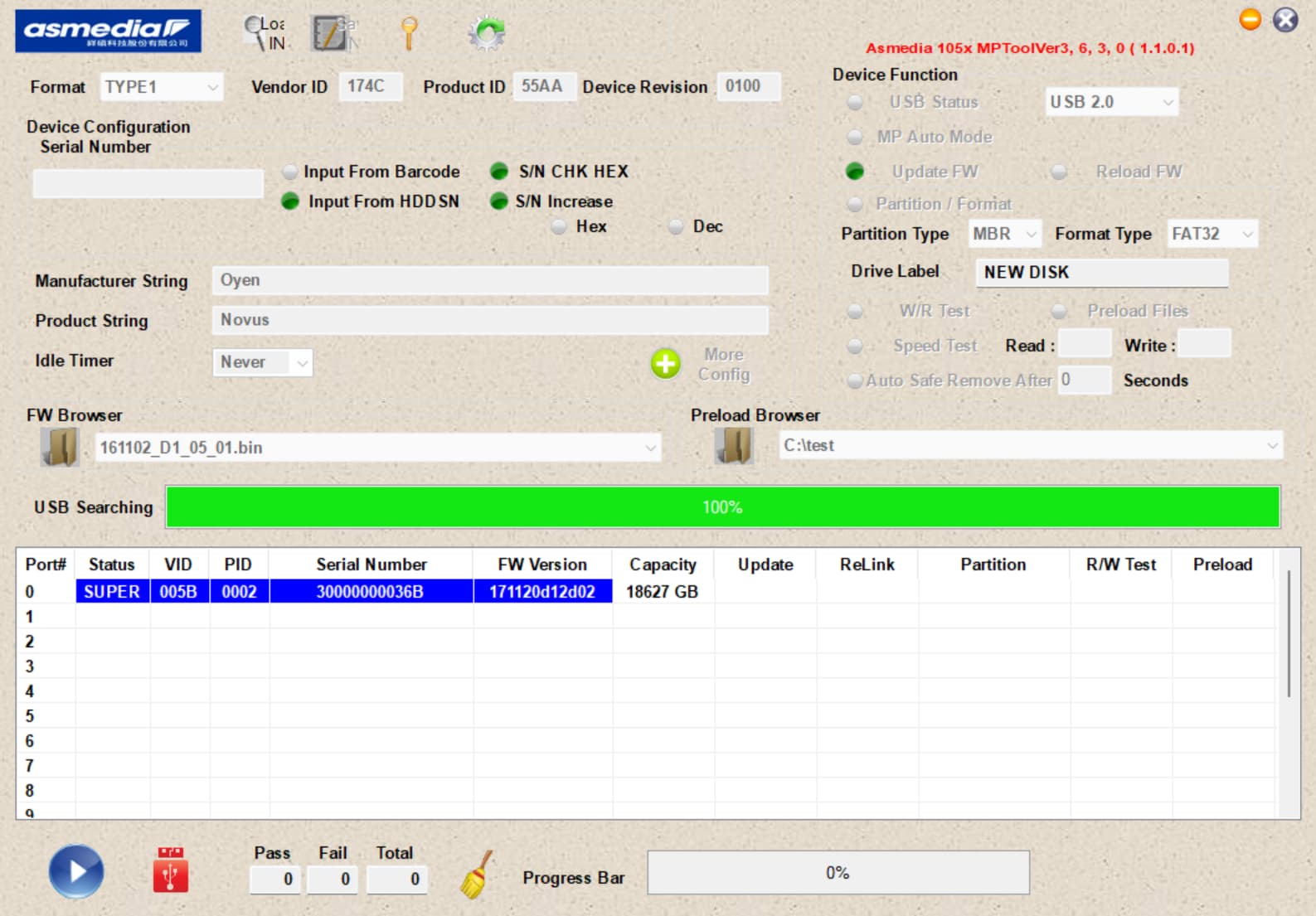

This concludes my testing of USB enclosures for the time being. I will resume when the UAS disable option is available. Here’s a table with the summary of the testing results:
Brand Type Chipset FW Windows Debian/ Volumio
RaidSonic GR3660-B3 JMS56x 103.02.00.03 ok read errors
RaidSonic GT1670-SB3 JMS56x 103.01.00.01 ok read errors
RaidSonic GT1670-BA31 ASM235CM 171120_D1_2D_02 ok not detected
RaidSonic IB-377-C31 ASM235CM 161102_D1_05_00 ok ok
Fantec ALU7MMU3 ASM1153e 130926_A1_00_00 ok ok

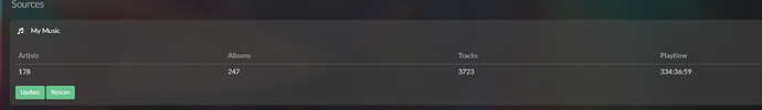

Now that I have found a USB enclosure that works out of the box, I can look at some usability aspects of Volumio 4.
When I click “rescan” in the sources / my music menu, the counter for the different items stays at the value of the last scan, instead of jumping to zero and then increasing as the scan proceeds (or maybe I did not understand the meaning of “rescan” correctly?).
The library on my disc has 65k Tracks, around 2k Artists and close to 4k Albums. In a linear list it is very cumbersome to navigate through these categories. The scrollbar at the right is not a lot of help, as it is very small. A good solution would be an alpha index that allows to jump directly to a letter. I don’t know if MPD provides this functionality.
Albums are sorted by Albumartist, not by album name. Not sure if that is intentional.
