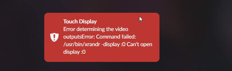

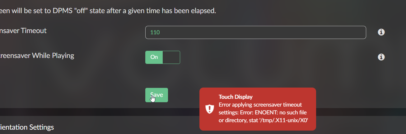

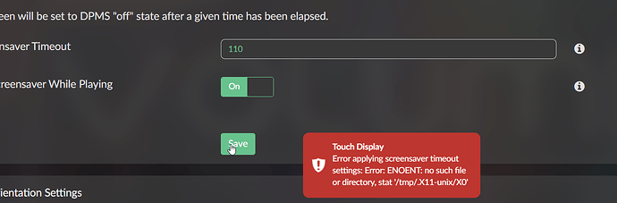

Started from a fresh install of Volumio: 4.062 , and also tried upgrades from test update channel.
In all cases I have issues with the Touch Display Plugin and cannot get it working.
  • Version of Volumio: 4.062
  • Kernel: 6.12.47-v7+
  • Model: Raspberry Pi 3 Model B Plus Rev 1.3 Raspberry Pi
  • Touch Display Plugin , version v3.5.6
Here is the log :
http://logs.volumio.org/volumio/D5SRPCb.html
I keep get errors like these :
and
Any hint ?
