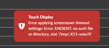

Seems I having issues running BW V4.015, rPi4
Touch display V3.5.5
Waveshare https://www.amazon.nl/dp/B0BW5Z2L7P
After upgrading BW V4.010 to V4.015 and uninstall and upgrading touch display:
How is your “/boot/userconfig.txt” looking?
dtoverlay=gpio-ir,gpio_pin=23
Nothing else is added as it just an OTA from V4.010 to V4.015. Which did work in this configuration.
Added to test:
dtoverlay=vc4-kms-v3d which give me my light back.
@nerd
Any reason for this inconsistent behaviour?

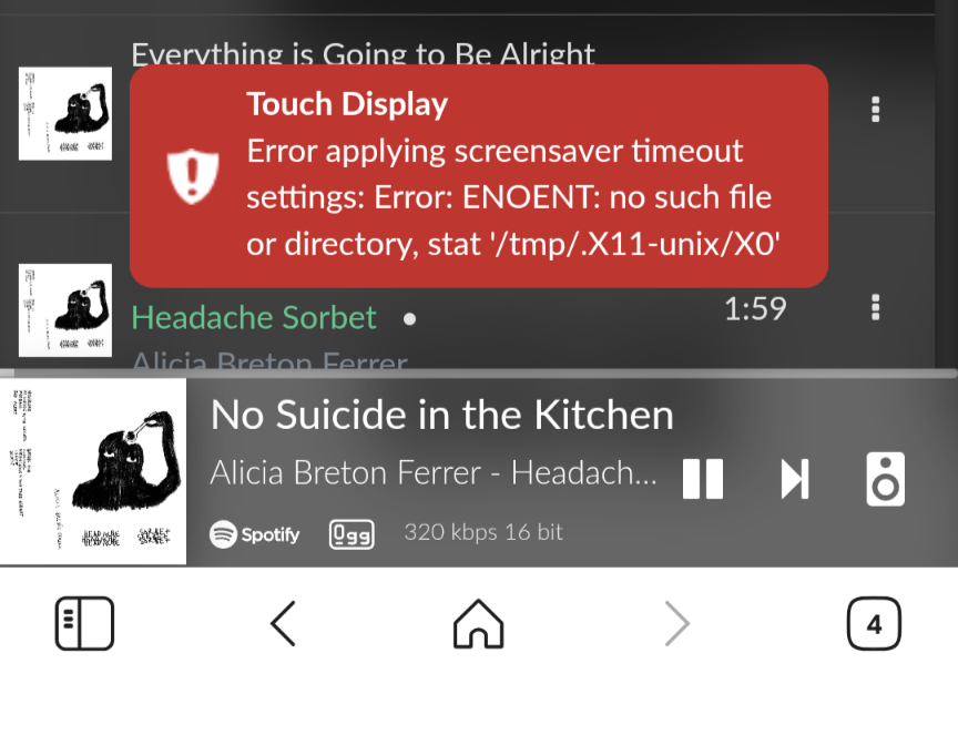

After crashing my pi4 and pi5, both unrecoverable and needed reflash, while upgrading the plugin, I reinstalled 4.015 on the Pi4, tried to install the latest stable version and then it also gave this error.
Pi4b 8gb, working fine on 4.014, including Touch Display.
OTA update to 4.015, everything worked except Touch Display…it booted fine and screen is on but just black background. Only overlay applied is arm_boost=1. I can get in from web gui, so I uninstalled 3.5.4 and installed 3.5.5 and neither worked. Something about unable to reach xserver. I’ve rebooted and reinstalled 3.5.4 and problem remains. Here’s a log.
Did you try adding this to userconfig.txt yet? Worked for me
Thank you kind sir. Reading and comprehension had escaped me. I had thought I didn’t need that overlay anymore, as has been the case since the alpha.
