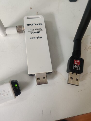

Just wanted to report some good progress on USB dongles. I have been able to get USB 2 low tech dongles working on V4.005. Speed is a poor 72.2 mB/sec so pretty poor.
the ones in the pic all work. I got them going by bringing up the system on the wired network and then configured the wireless adapters.
When these are plugged in to USB 3, my system will go into a reboot loop. However that could be a power issue with my system because I’m driving a 7" display plus a hifiberry dac hat. On the other hand usb 3 works just fine on Volumio 3. More advanced USB 3 dongles also cause my system to go into restart loops. So I think its a power isssue with USB 3. Hope this is helpful regards
