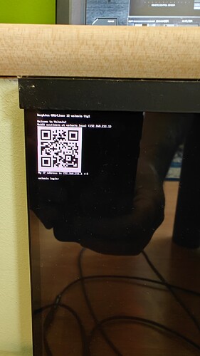

Now I don’t understand anything. When I turn on the RPi5, it starts with this screen:
Everything would be ok, but this is not my address range (192.168.211.1). Cannot connect to Rpi.(192.168.1.xxx My)
This is the address for the hospot!
so, your device is not connected to your network
What a fool I am. You’re right. I unplugged the cable. Thank you very much!!!

You have to connect another device (PC / Laptop/Tablet ) to a SSID that is “Volumioxxx”.
If this works, a browser window should open and you can configure basic settings for your Volumio.
It’s important, to give your device a name different from “Volumio” !
(this is part of this basic config as well as entering the WLAN credentials for your own home-network)
