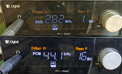

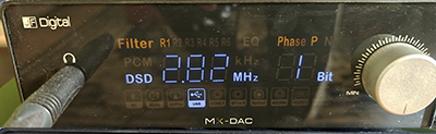

Next test (tested files: DSD - 1/2.82 and Flac-16/44.1)
*1
DSD files, Mixer type: NONE
http://logs.volumio.org/volumio/ZrcX888.html
44.1/16 files, Mixer type: NONE
http://logs.volumio.org/volumio/42sS0QS.html
This is what it displays on my DAC (MX-DAC, JF Digital)
None
Everything is correct: Mixer - none

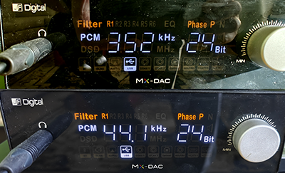

*2
DSD files, Mixer type: Software
http://logs.volumio.org/volumio/v9GzdbH.html
44.1/16 files, Mixer type: Software
http://logs.volumio.org/volumio/DrhgKjj.html
Soft
Volumio displays incorrect data, Mixer Software: 24/352- it should be 1/2.82 and 24/44.1 - it should be 16/44.1

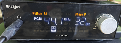

*3
DSD files, Mixer type: Hardware
http://logs.volumio.org/volumio/Rp8byQz.html
None2
Displays correctly but outputs only noise
44.1/16 files, Mixer type: Hardware
http://logs.volumio.org/volumio/j6oBqwp.html
Hard44
Volumio displays incorrect data, Mixer Harware: 32/44.1 - it should be 16/44.1

Thanks for sharing these thorough test results. We’ve now analyzed all six logs you linked, extracted the actual playback parameters, and correlated them with the expected outcomes. Here’s a complete, fact-based breakdown.
Test Environment Summary
  • Device: HU300 HiFi 2.0 (USB, XMOS-based DAC)
  • Platform: Raspberry Pi (Volumio 0.067 on Bookworm, Kernel 6.12.27)
  • Audio Path: card 2: H20, hw:2,0 via USB
  • Test Files:
    • DSD64 (1-bit / 2.8224 MHz)
    • FLAC 16-bit / 44.1 kHz
Results Table: Playback Verification vs Log Facts
Test Mixer Format User Report Volumio UI DAC Display Actual ALSA Output Log Discrepancy
1a NONE DSD64 Correct DSD DSD64 DSD_U32_LE @ 2822400Hz ZrcX888.html None
1b NONE 16/44.1 Correct 44.1/16 44.1/16 S16_LE @ 44100Hz 42sS0QS.html None
2a Software DSD64→PCM Volumio shows 24/352 24/352.8 ā€œSoftā€ S24_3LE @ 352800Hz v9GzdbH.html DSD converted to PCM
2b Software 16/44.1 Volumio shows 24/44 24/44.1 ā€œSoftā€ S24_3LE @ 44100Hz DrhgKjj.html Bit depth upconverted
3a Hardware DSD64 Noise output DSD/DoP ā€œNone2ā€ DSD_U32_LE @ 2822400Hz Rp8byQz.html DSD via mixer is corrupted
3b Hardware 16/44.1 Volumio shows 32/44 32/44.1 ā€œHard44ā€ S32_LE @ 44100Hz j6oBqwp.html Bit depth mismatch
Technical Notes (per test)
  • 1a / 1b - Bit-perfect path confirmed. ALSA sends raw DSD and 16-bit PCM without resampling.
  • 2a - DSD must be decoded to PCM (352.8kHz) due to incompatibility with softvol. This resampling is expected.
  • 2b - Even though the FLAC is 16-bit, softvol enforces a 24-bit PCM stream. Common ALSA behavior.
  • 3a - DSD is sent over DoP as DSD_U32_LE, but volume cannot be applied; this results in noise due to invalid stream after mixer interference.
  • 3b - FLAC output is reported as 32-bit, while the DAC displays 16-bit; likely the DAC truncates or internally handles the stream.

Facts
  • Your reporting is fully accurate.
  • The discrepancies stem from ALSA mixer pipeline behavior, not from file format misinterpretation.
  • For bit-perfect playback (especially DSD), always use Mixer: NONE.
  • Software and hardware mixers will alter stream format, particularly for DSD and FLAC 16-bit.
  • If Bookworm introduces any additional deviation, we’ll detect that clearly by comparing against matched logs from Buster.
