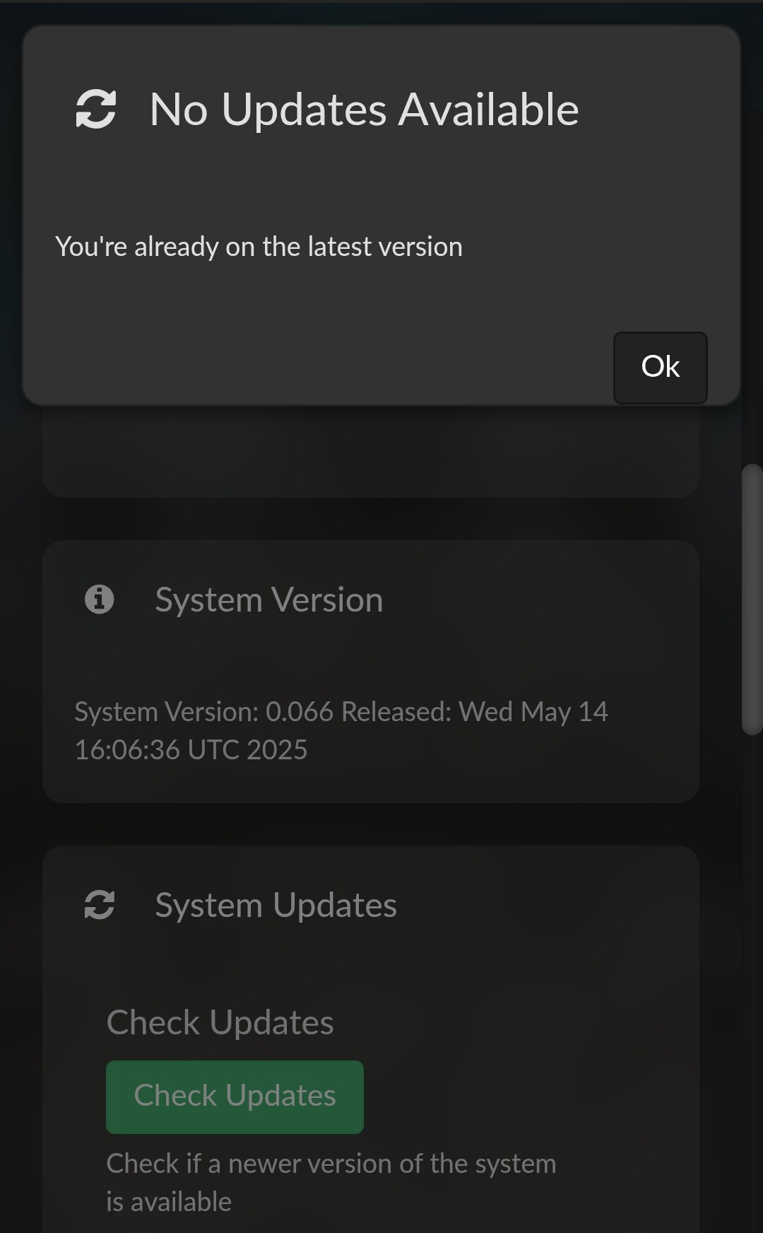

Hey @Gelo5,
Can you capture logs at this state, before factory reset?
http://logs.volumio.org/volumio/TMV3pUm.html
Hey @Gelo5,
Thanks for the update and the screenshot.
From the logs, I’ve noticed this line:
sudo: unable to resolve host volumio1920-book: System error
This means the system’s hostname is not correctly resolved locally, which can interfere with system operations - including update checks.
Could you please try the following:
  1. Change the hostname to something shorter, e.g. volumio66
    You can do this from Volumio UI under Settings > System > Player Name.
  2. Reboot the system fully after the change.
  3. After reboot, go back to Settings > System > Check Updates and see if it now offers a newer version.
Let us know what happens after this step - we’ll proceed based on that.

Hey, @nerd
http://logs.volumio.org/volumio/nEkBU3A.html
Rename and Restart:
VolumioBook, Volumio1920, Voumio, Volumio66 - still the same
Hey @Gelo5,
Thanks for confirming the hostname change and sharing the log.
The hostname issue appears resolved - there are no further resolution errors, so the system is now correctly identifying itself.
To proceed, could you please SSH into the system and run the following command:
ls -la /data
We’d like to verify the contents and state of the persistent data directory. This will help us check for anything unusual that might be affecting the update mechanism.
Let us know the output so we can continue debugging.

Hey @Gelo5,
Thanks for the directory listing - that confirms a few things.
We do not support a combined update channel like test + test-alpha. Each update tier is handled independently, and those placeholder files:
/data/test
/data/test-alpha
– are not valid update triggers on their own, and currently serve no purpose. They also do not correspond to Volumio’s active OTA rollout logic.
Please go ahead and run:
rm -rf /data/test
Then reboot the device:
sudo reboot
Once it comes back up, try checking for updates again from the UI.
Let me know if the update is now offered.
Hey @nerd
Now it worked, thank you.

Hey @Robert.Hecht,
Thanks for the detailed report and logs - very helpful.
I’ve reviewed your output and can confirm the OTA updater attempted to unpack and write the update to /imgpart, but ultimately ran out of space:
/dev/sdb2 3.7G 3.5G 0 100% /imgpart
You’ll also notice the presence of .part and rcksum-* files in /imgpart, which indicates an incomplete OTA staging.
However - the root cause is this:
x86 OTA from 0.066 to 0.067 is not supported
This is documented in the 0.067 changelog under Known Issues:
Important: x86 OTA update to 0.067 is not supported due to partition layout changes. A fresh re-flash is required.
This means the image layout has been changed in a way that cannot be patched in-place on existing x86 installations.
What to do next
To update to 0.067 on your x86 system, you will need to:
  1. Download the latest 0.067 image for x86 from the official source.
  2. Flash it freshly to your target drive.
  3. Restore your configuration manually or from a backup, if applicable.
