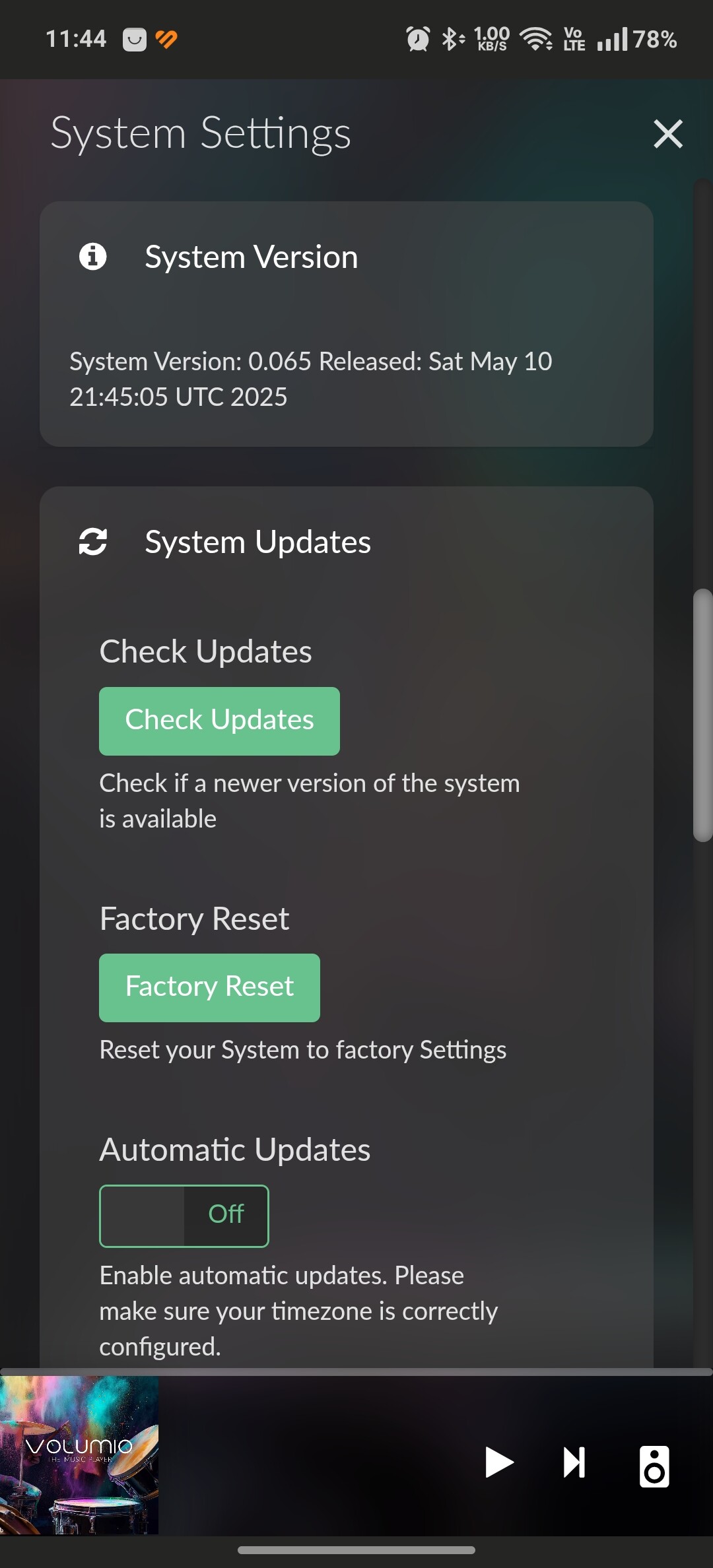

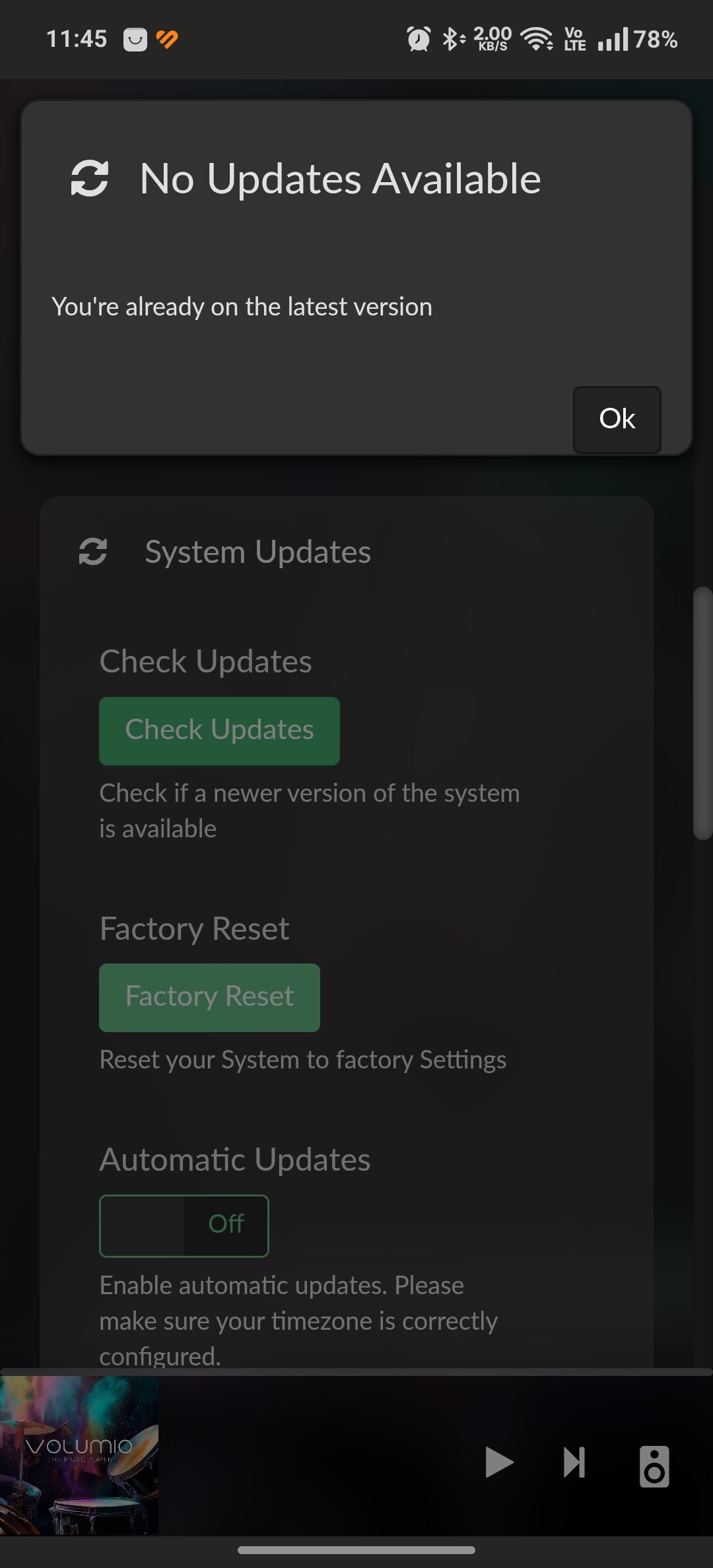

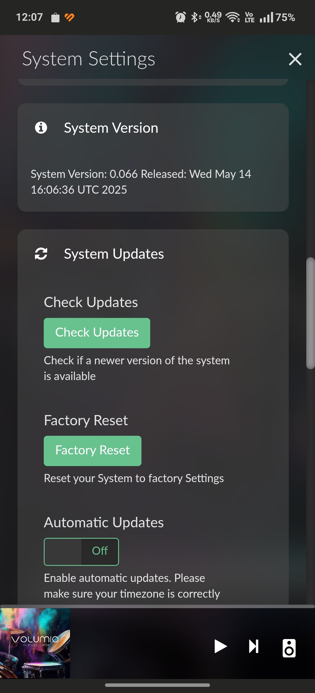

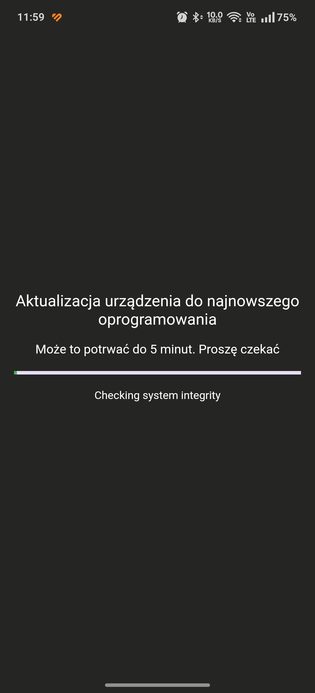

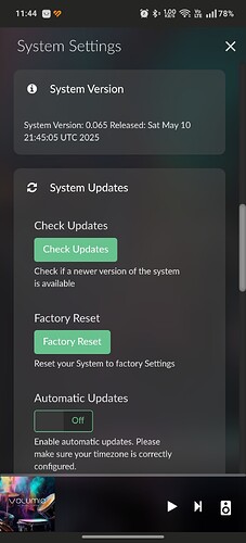

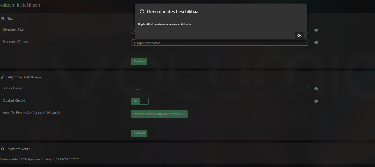

Hey @Dick_van_der_Wal, @Gelo5,
Thanks for sharing your results. What you’re describing - OTA to 0.066 completes, but system still reports 0.065 until after factory reset - suggests the update was applied, but version info wasn’t properly committed or synced. This could be due to overlay write delays, filesystem issues, or stale cache.
This issue is not reproducible on my test builds. OTA behaves as expected and correctly reports version 0.066 after reboot.
To investigate properly, we need:
- Raspberry Pi model and board revision
- SD card brand, model, and size
- Power supply details
- Logs from the first boot after OTA - before factory reset
You can get those by visiting:
http://<volumio_ip>/dev
Once we have the logs, we can determine whether this is a hardware-related timing issue, a filesystem sync problem, or something else.

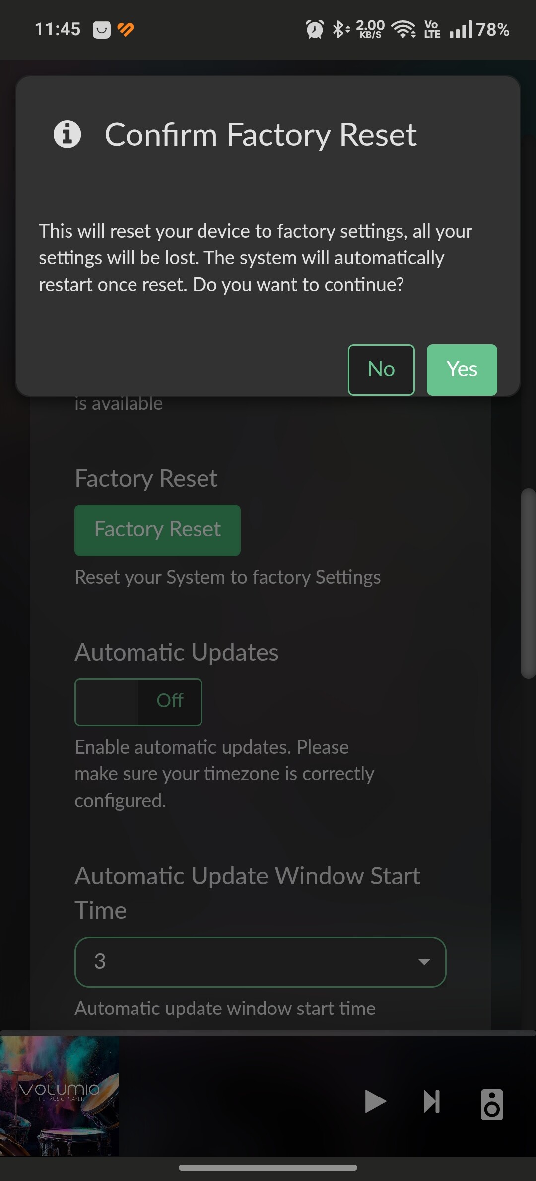

I can’t reproduce this situation anymore. I have 3 Rpi4 v.66 and 2 RPI5 with Buster, but… with a fresh v.65 installation of volumio on rpi4 - it installs v.66 by itself:
FACTORY RESET
and…
http://logs.volumio.org/volumio/a1sLmnm.html
Hey @Dick_van_der_Wal ,
Thanks again for sharing your findings. Based on detailed log analysis, I’ve identified backend plugin crashes as the likely cause of the version mismatch issue after OTA from 0.065 to 0.066.
Step-by-Step Test
Flash a clean Volumio 0.065 image to your SD card.
Before connecting to the network or allowing OTA:
Go to the UI → Plugins > Music Services
Disable the following plugins:
- YouTube Cast Receiver (
ytcr
) - YouTube Music (
ytmusic
Let the OTA update proceed to 0.066 as usual.
After reboot, provide a new set of logs.
What We Found
In the last test, both ytcr
and ytmusic
caused backend instability:
ytcr
produced 164 runtime errors related to missing session data:IncompleteAPIDataError: Missing data required to construct query string from bind params
ytmusic
failed to load with a missing module:Cannot find module './lib/YTMusicContext'
These errors appeared 164 times each and caused the backend to crash repeatedly, preventing the system from updating its version metadata. The update was applied, but due to the failed boot sequence, Volumio remained stuck reporting version 0.065.
We need logs from the next OTA attempt with both plugins disabled to confirm this resolves the issue.
