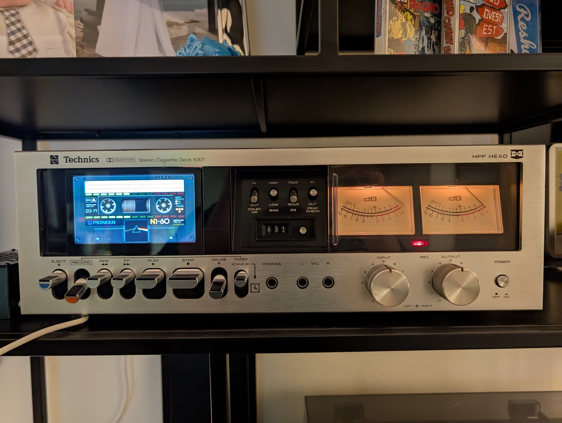

You’re welcome for the translation! :grin: I liked your comment about the image formats. Since I don’t fully understand the mechanism that drives the VU meter needles, I’ve guessed that it might be possible to animate them by sequencing PNG images. Greetings to everyone!
Very basic,
The Image of the needles are replaced on the background using calculated angels.
Result final Thank you!
