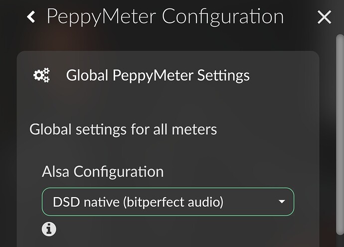

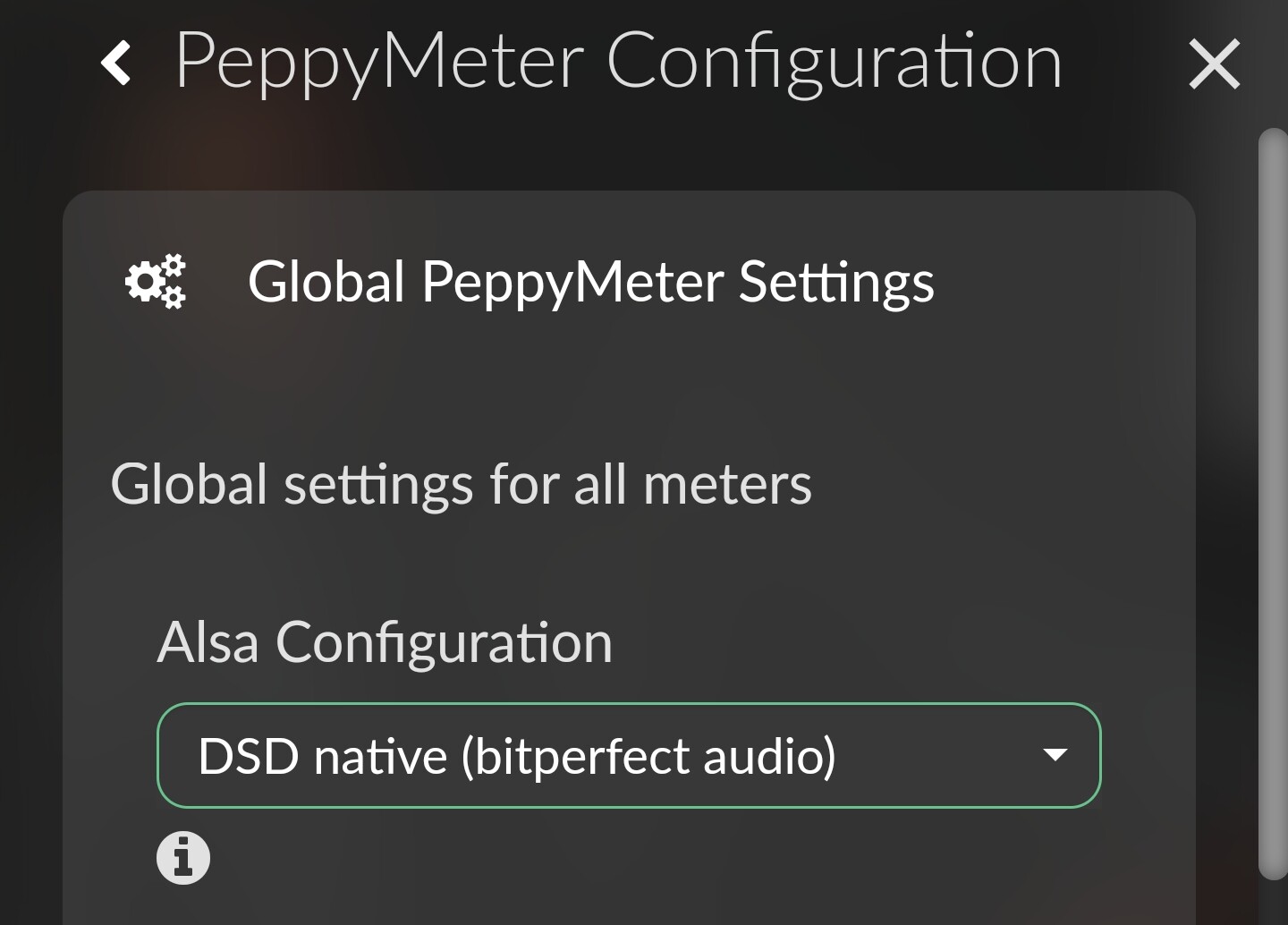

Hmmm, does it show: cover, artist, etc.? Does Peppymeter work properly on other sources? the only thing that comes to my mind - something either in the settings (Alsa)
or something was loaded incorrectly.

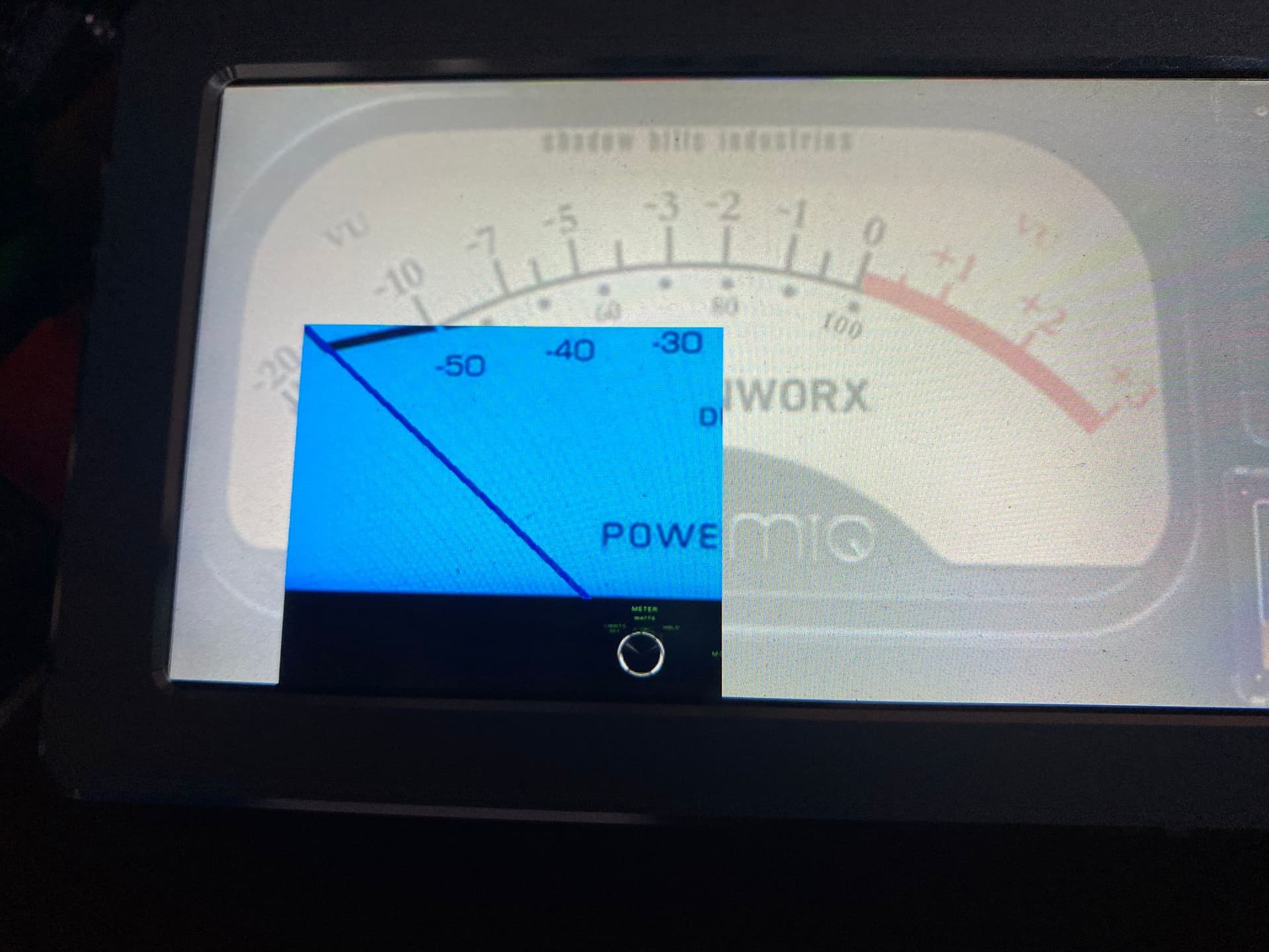

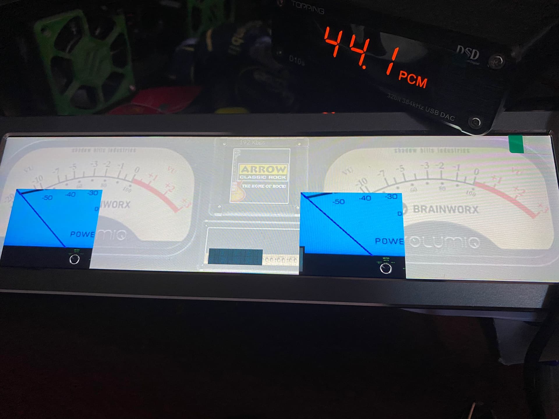

Peppymeter works properly on Webradio, the only other source I use. With Spotify, it shows the selected meter, nothing else. New discovery is that when pausing or stopping (regardless of source) I get ‘artifacts’, like this:
Moment, moment - what resolution are you using?
show full screen
1920x480 resolution
Full screen (webradio, paused)

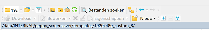

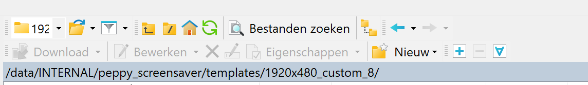

one more thing: where are the skins loaded?
skins are loaded here:
Only??
Yeah, I have the spectrum ones as well
