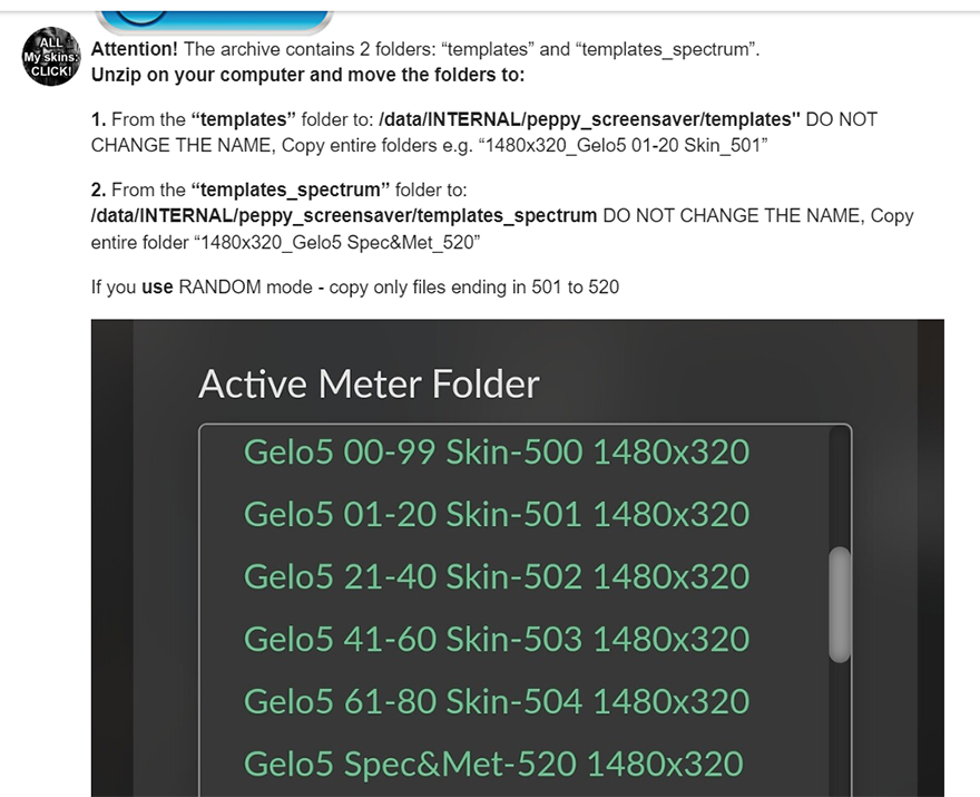

I put the new templates in templates folder via FileZilla. As you can see in the pics the new templates exist in the folder
Read where to copy! Not where you copied.
data/INTERNAL/peppy_screensaver/
OK for sure my mistake. I will try again .Tks

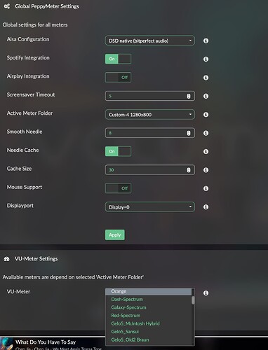

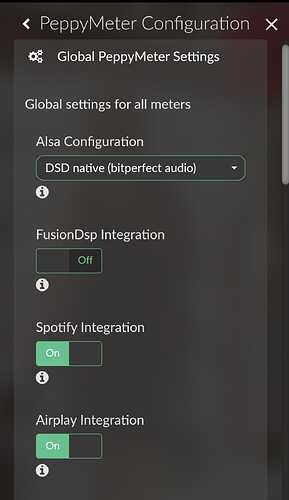

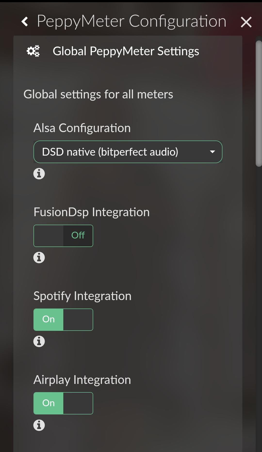

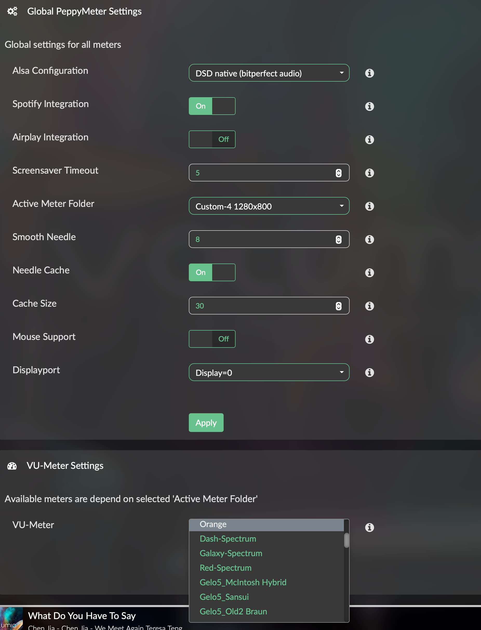

Hi friends. I’ve installe new Peppymeter 2.0 with peppyspectrum but after the installation i see only peppymeter plugin and not peppyspectrum. How do i activate Peppyspectrum?
Peppymeter is connected to PeppySpectrum. Everything is in one plugin (peppymeter 2.0)
I copied the templates in both the directories but i see only the normal meters but no spectrum…
Ah, ok @Gelo5, now I’ve understood.
Thank’s

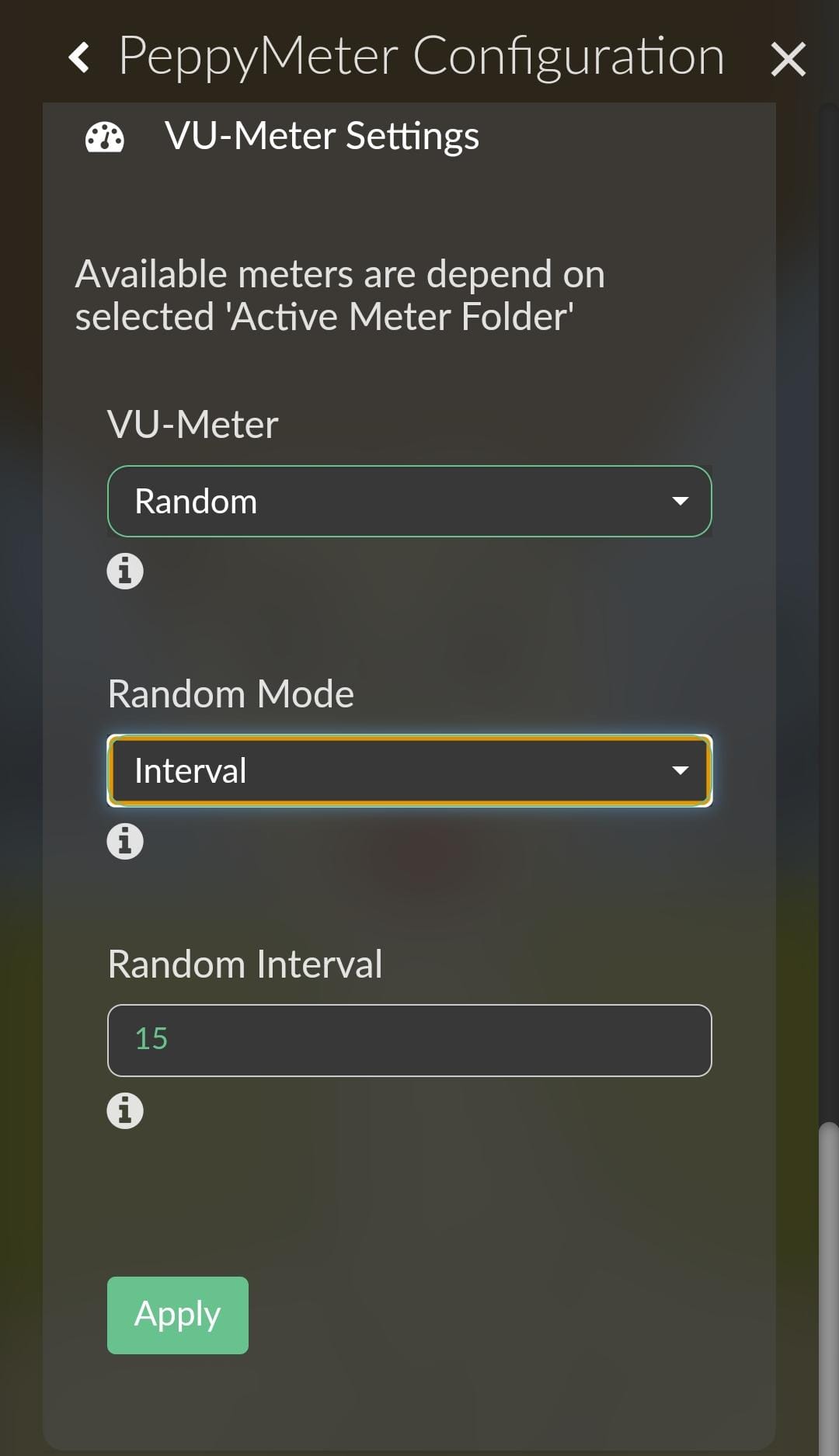

@Gelo5 Still waiting for the 1280x800 spectrum&Meter. :slight_smile:
Andy

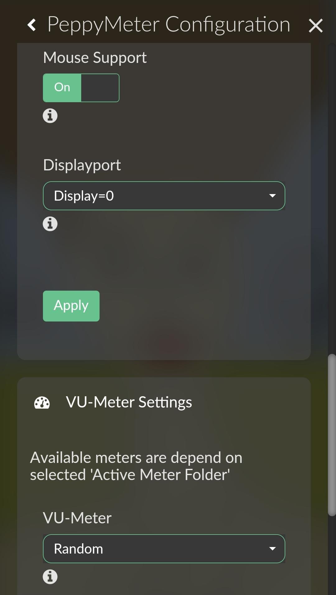

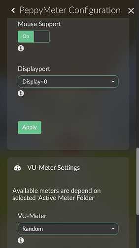

Somehow, I managed to get the spectrum&meter skins mixed with Gelo5’s skins under “Custom-4 1280x800”.
Hi Andy,
it’s not more needed to combine the folders. You can place the Gelo5 folders with the same resolution in addition to my custom folder. You can then select the one or the other folder from GUI
Hi Falk, I normally put Gelo5’s skins onto the Custom folder 4 (1280x800) in addition to the standard skins from you. What I want is to have both new Spectrum&Meter and Gelo5 (meter only) skins in the same folder and let it plays randomly.
Andy
